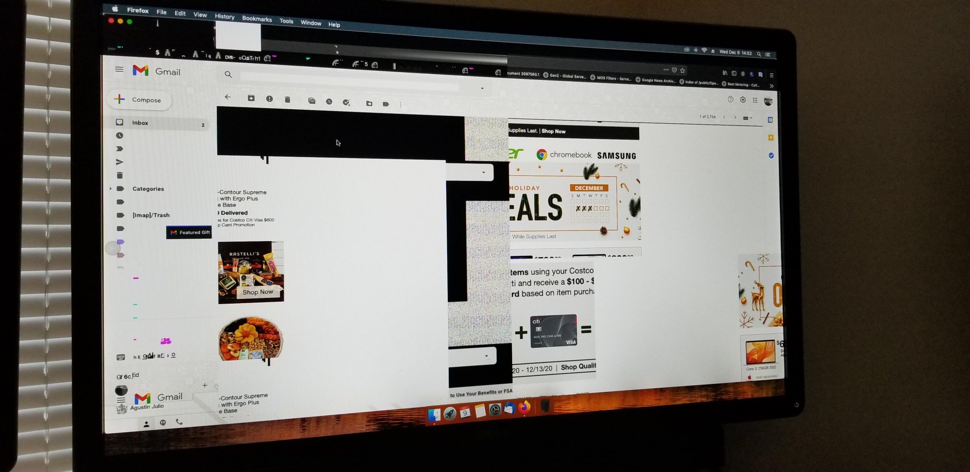

hi everyone, I have a Mac mini Mid 2010 running 10.14.1 with a Nvidia Geforce 320M with some videos issues, it usually happens when I'm watching videos on YouTube or viewing a webpage or email with a lot of pictures or animated graphics on it.
When I work in Photoshop or Lightroom I don't any issues. I took a picture of the issue that I will upload shortly.
Sometimes the issue get resolved by it self or sometimes I have to do a hard reset because the OS gets unresponsive.
Is this a known issues or has someone else experience this?
I have the Mac Mini for about 3 years or so and I just start experience this issue maybe 1 month ago.
Thanks for any recommendation on this.
Luis

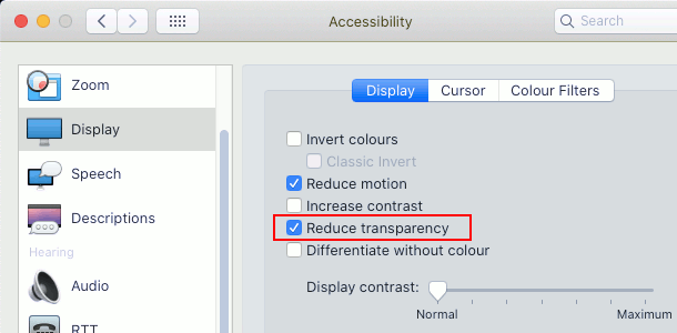

In System Preferences / Accessibly / Displays, is "Reduce Transparency" ticked?
I will check and get back to you. I just uploaded a picture of the issue I have
