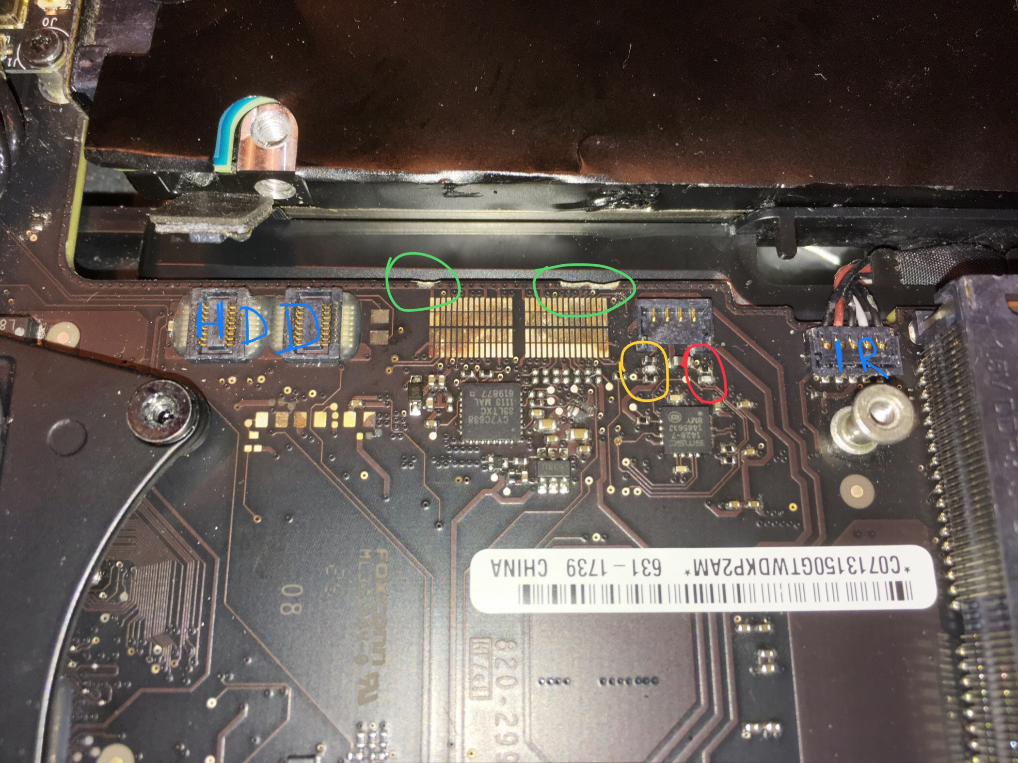

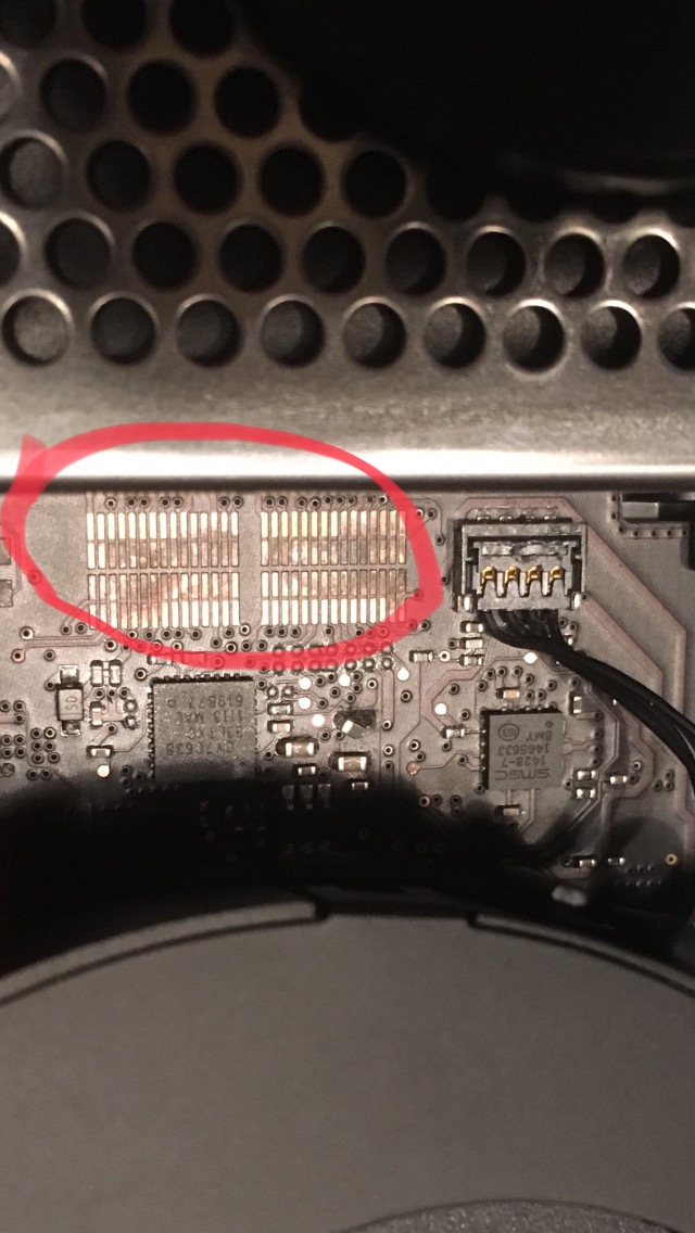

The parts marked in red doesn’t look all too healthy, do they? Are they perhaps fried? And are they related to the fan?
Those pads have zero to do with the fan not working. I would assume that the fan itself has just died. They are very inexpensive on eBay or Amazon. Three T6 Torx screws and it will come out. I've had a few go bad. I had one sound like a failing hard drive but it ended up being the fan.

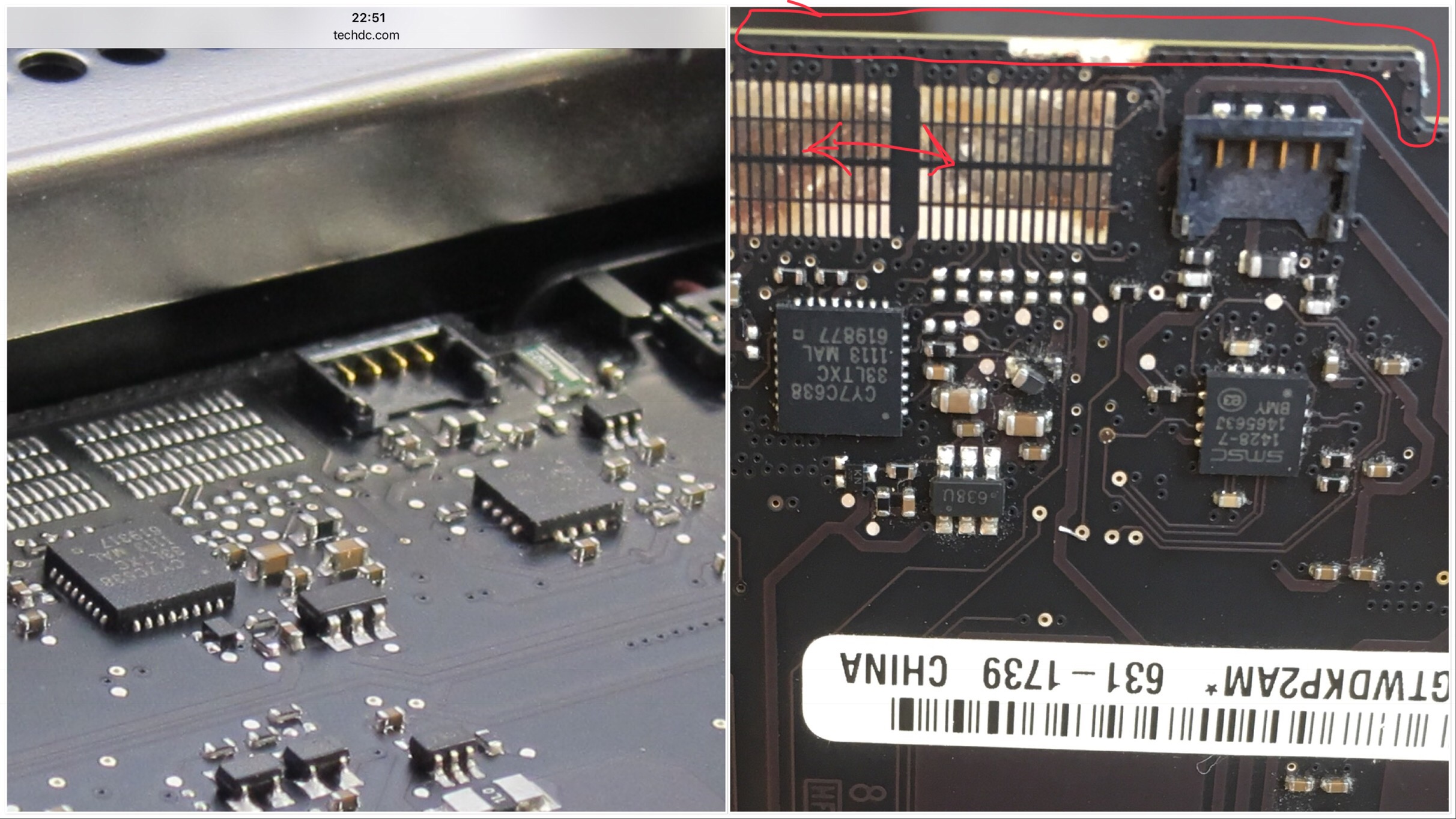

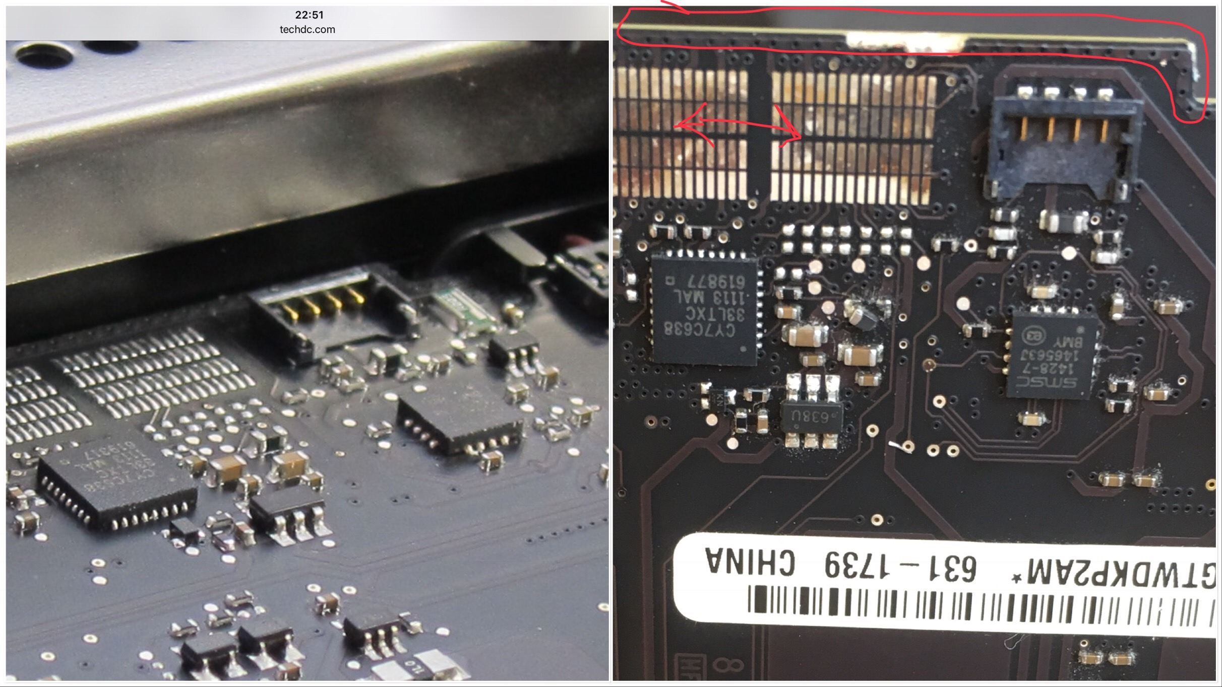

Bought a new fan and replaced the old one, but still not working. 000 RPM. I’ve replaced my upgraded SSD and RAM with the original components. Everything is connected properly. Tried SMC and PRAM reset. Everything else works like a charm. This is so strange. I don’t know much about motherboards, but the only damage I can find is marked on this picture. Green mark is by the edge of the motherboard, where there is slight damage. The only other thing I can see is perhaps under the power outlet of the fan: when I compare the 6 components (in two rows, yellow-marked) with the other side (red-marked), the top two components seem to be missing. Although, maybe it’s supposed to be that way? On the 2nd picture, marked in blue, I tried to mark what I believe might be the area for the fan. But then again, not an educated guess. Any ideas anyone?
View attachment 766454 The parts marked in red doesn’t look all too healthy, do they? Are they perhaps fried? And are they related to the fan?
The fan is connected with one of the type of connectors to the right in your photo. Replacing the fan is as easy as plugging in a new one. My 2010 had temp sensors on the hard drive. Not sure about 2011, but worth making sure they are connected and working.
Thank you for your answer. The problem is not to connect the fan though, but getting it to work plugged in. It’s true: in earlier models temp sensor was attached to the hdd, but not on this mid2011 though.

I’ve compared my motherboard with pictures of healthy ones, but when it comes to the resistors and conductors around the SMSC 1428-7, everything is intact.

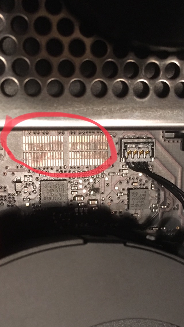

I’m soon gonna give this up, but before I do, I’d like to know what parts these are (marked with red on the pictures)
First: the corroded ones, what are they? (and I’m gonna try to clean them with isopropanol with great care)
Second: the row of small holes along the whole border around the motherboard. Do they have a function, or is it just a border? (and well, there’s damage there, but not anywhere else, from what I can discover)
Those pads that have turned a yellowish brown, those do not have any function for the system to work properly. It does seem you have a capacitor that is out of place by CY7C638. With the chipped part on the edge of the board, a trace could've become damaged, resulting in the fan not getting power. I would suggest that you find a place that can do component level repair on the logic board.

Ryan, you have a keane eye, the capacitor is definetly knocked off its place. Tried to adjust it, but it looks like half of it is missing.
Even if I buy a replacement (perhaps C6960 a 1UF cap 10% 25V X5R in a 603-1 package) and get some help, I don’t know if it would resolve the problem.

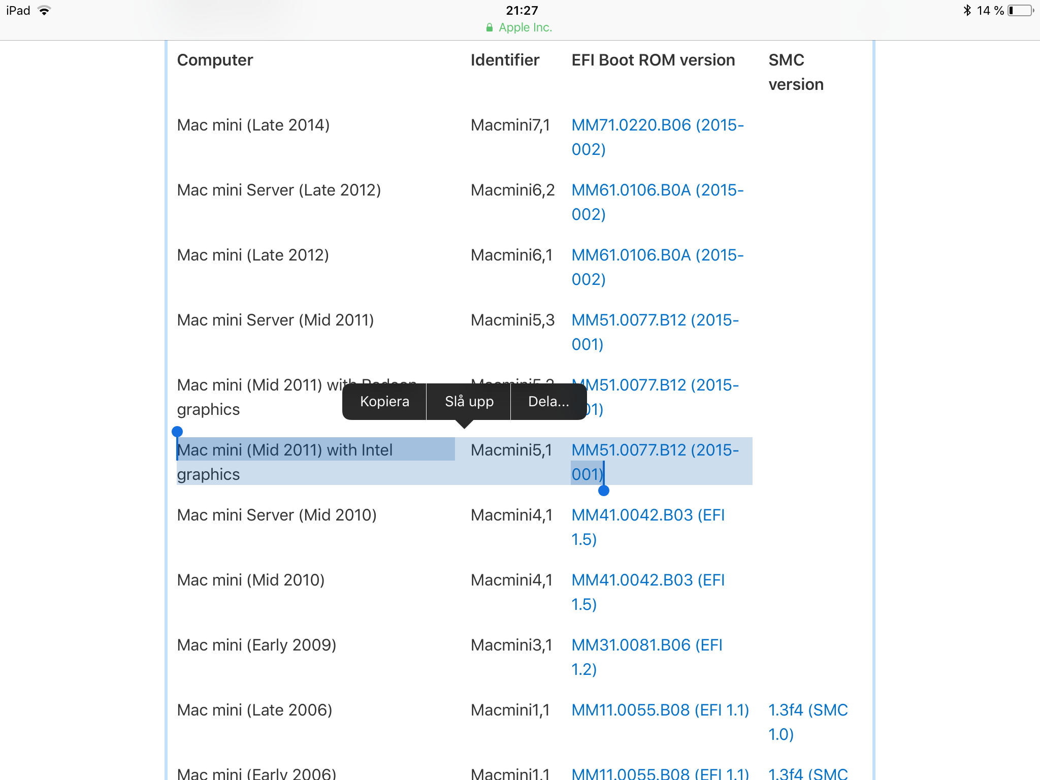

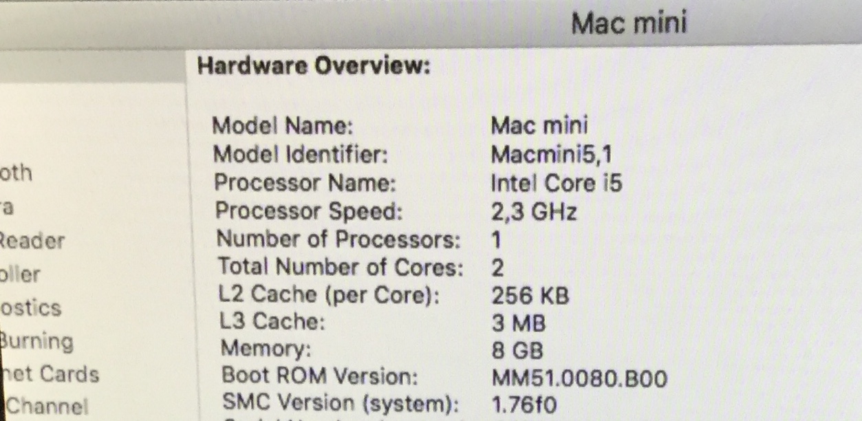

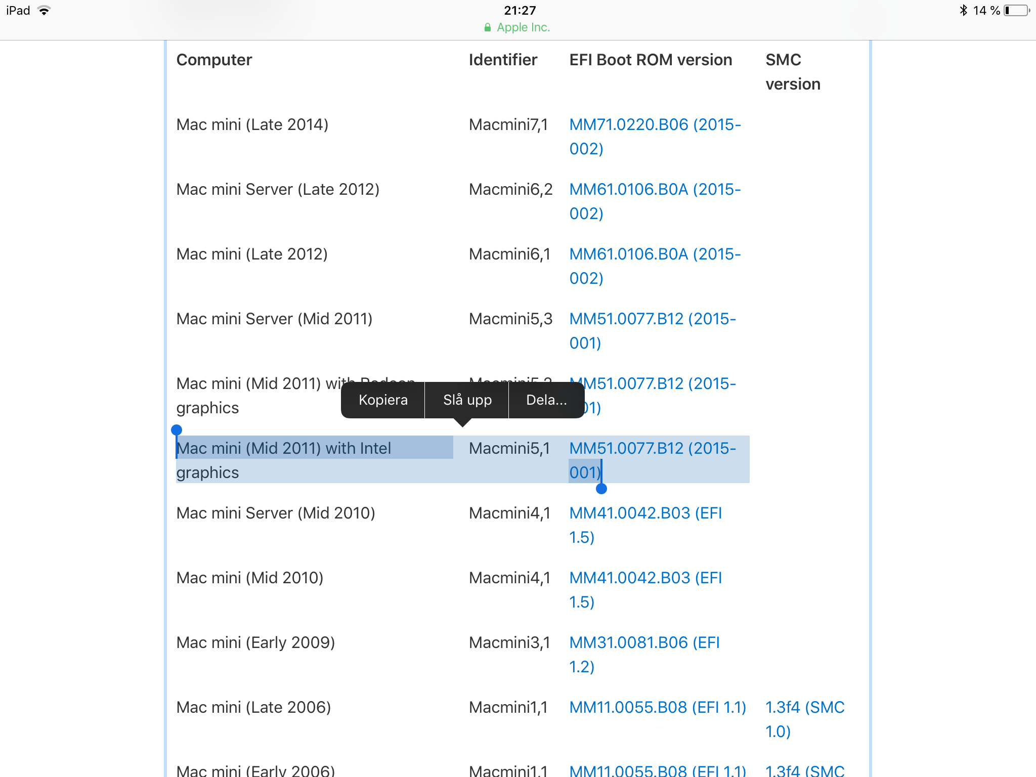

According to an authorized Apple repair store nor the broken capacitator or the damage on the edge should affect the fan (I don’t know if I believe him). Since everything else that SMC operates works just fine, he didn’t believe it’s hardware related. He asked me to check the software.
So I checked my Hardware Overview.
Mac mini (Mid 2011) with Intel graphics Macmini5,1
I have Boot ROM Version:MM51.0080.B00
and SMC Version (system):1.76f0
So it looks like I’m up to date. Is there a way to check the SMC firmware? Or maybe a complete factory restore would be easier?

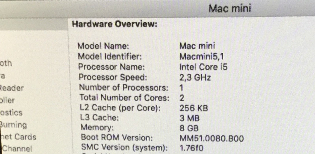

View attachment 772744 View attachment 772745 In Scandinavia: thus my funny grammer😉
