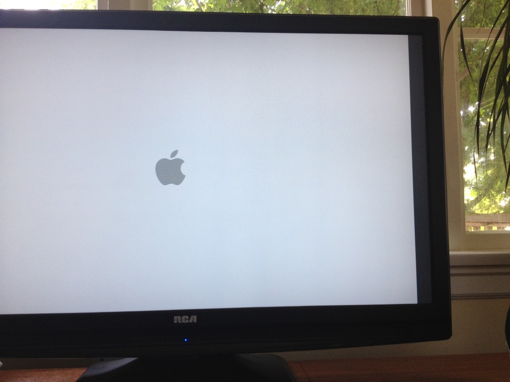

Here is the picture of the issue - not the worst. When it boots to the desktop the color is completely washed out. And 1080P isn't even supported.

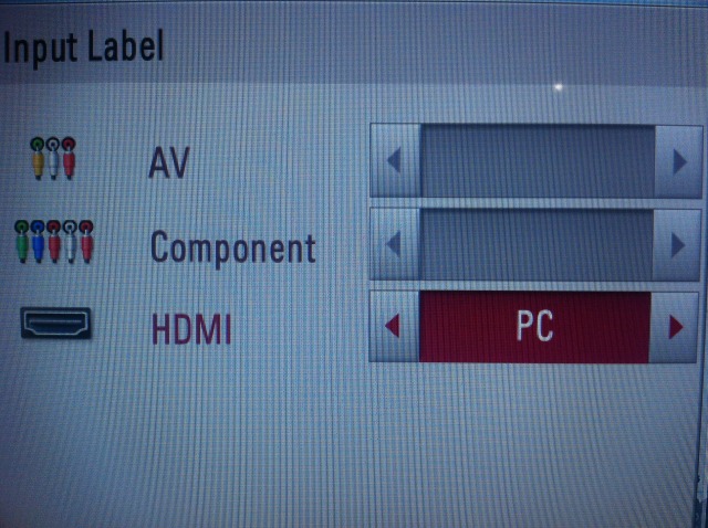

Well, in my experience, if you are sure your TV is full HD or able to do the Full HD resolution (1080p/i), but you still got the blurry image/text. Please try to set the HDMI connection on your TV option. And change the function/name/input label (in my LG TV, its input label) of the HDMI connection to PC. And Voila !!! The screen look waaaaaay much better... 😛
Please check the pics below :
Hope this can help anyone else.
