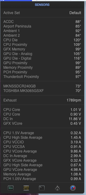

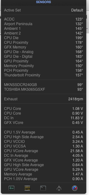

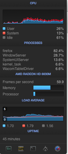

here are some screen shots I took of iStats, i am running a trial version of it. The first image of temps is when I first tuned on the mini and doing some browsing on firefox on website A, the second one is processes when I was looking at website B in Firefox, third image is of temps while looking at the website B in Firefox. My mini has dual hard drives; a 240 gb mushkin ssd drive, and a 500 gb hard drive.
