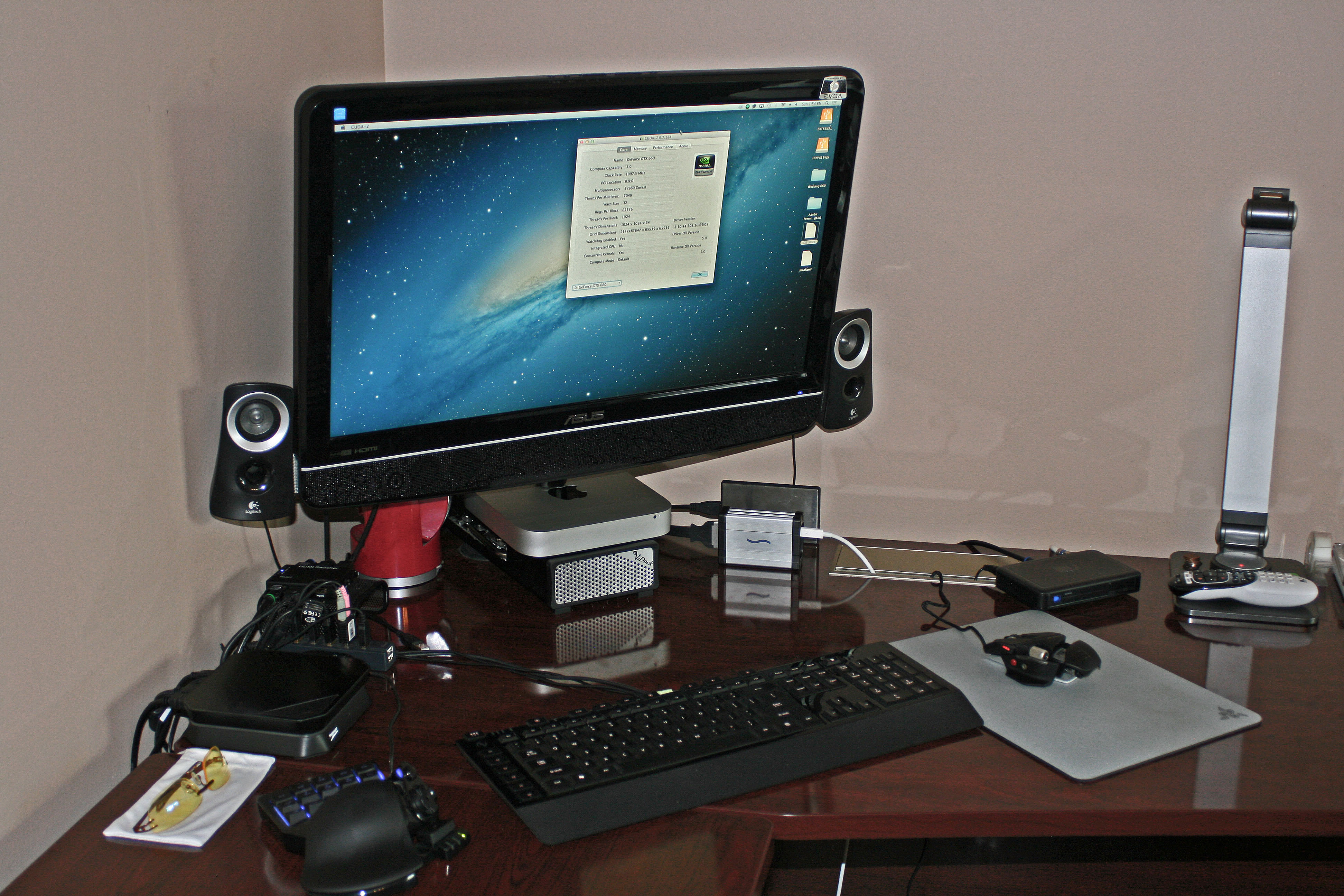

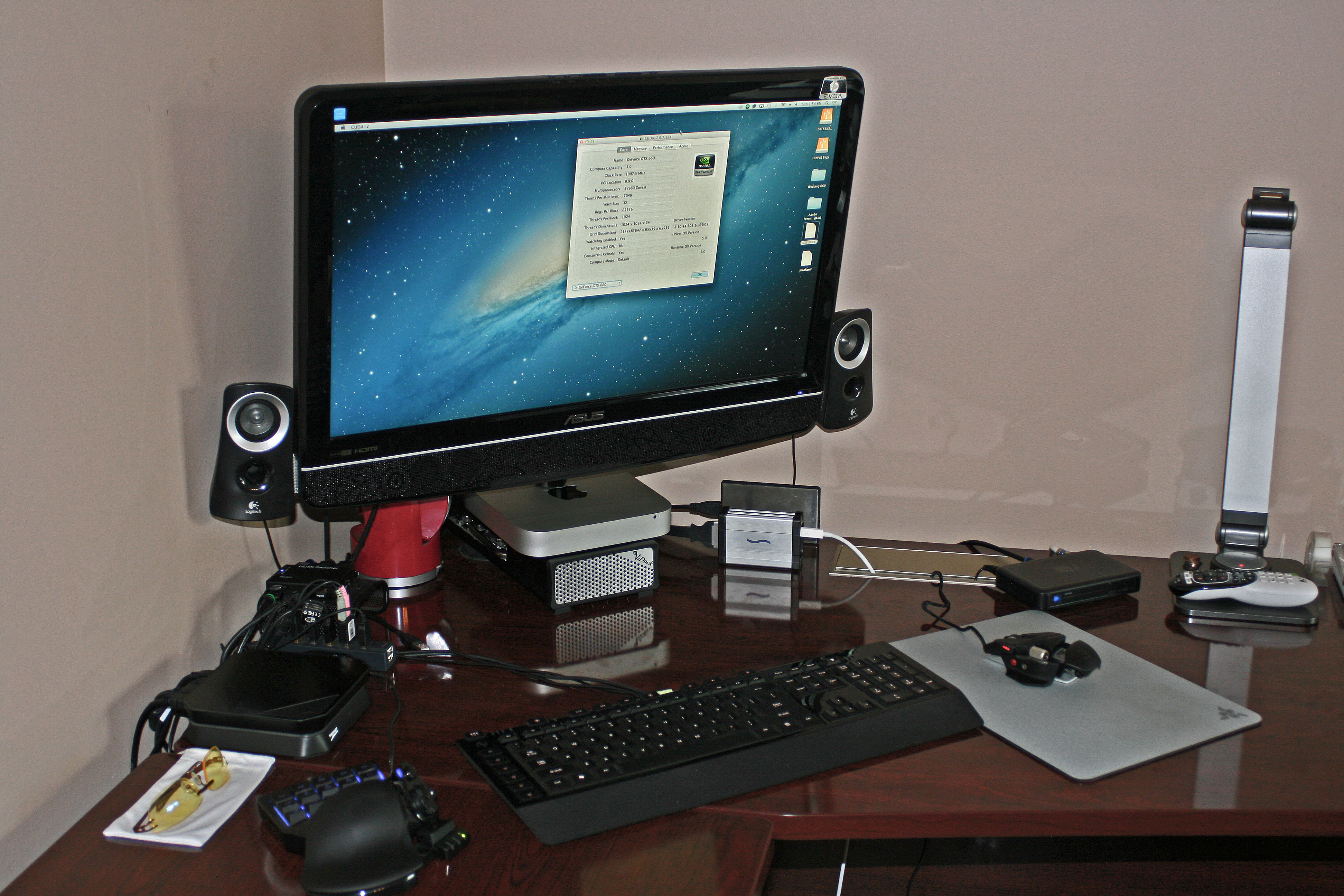

It sounds like a mouth full, but it honestly isn't too bad. You have two boxes (three if you count the adapter which is small) and they just connect to each other via one cable.
Added a picture of my current setup (monitor is VESA mounted)
