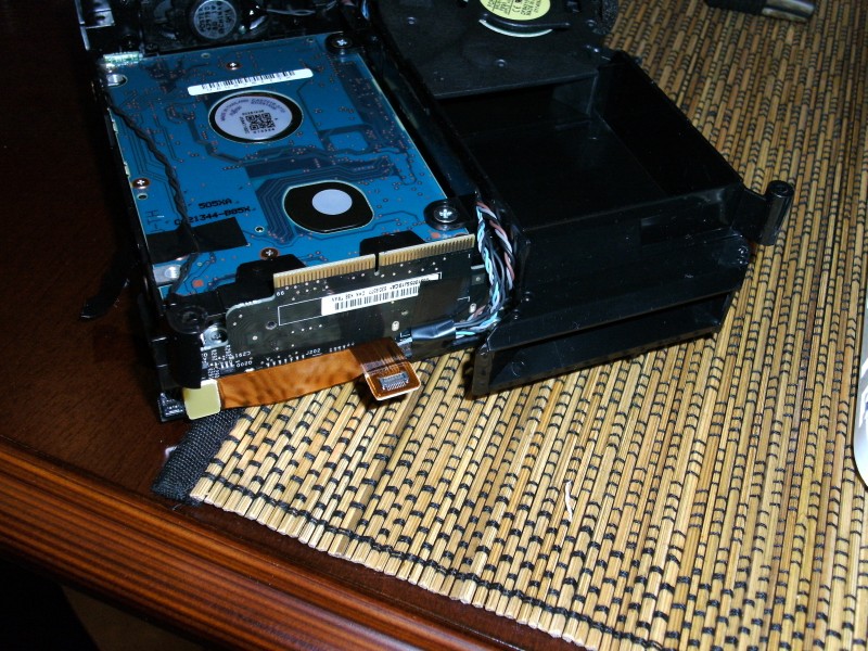

So today i was upgrading my new mini and everything goes great (or so it seems) it boots up just fine and then i try and play a song..nothing, no sound at all the volume changer is gone and everything. I take it back apart to take a look to see if i just missed something and i see this little wire dangling from where the HD is but i don't know where it goes or if it has anything to do with my problem. So if anybody has any ideas about this let me know. 😕
I had the exact same issue after upgrading hd and ram, and reattaching that cable fixed it. Difficult to describe where it connects, but check ifixit or another site with upgrade pics and you should be able to figure it out. Snaps back on easily. Good luck
I had this happen with my (previous-generation) mini. When I took it apart, there was a small ribbon cable that came unseated. Reconnecting it fixed it.

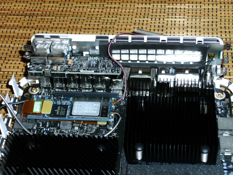

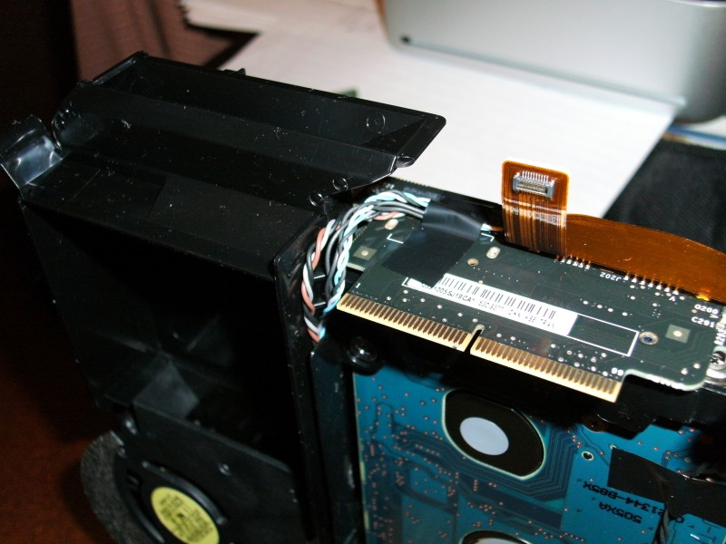

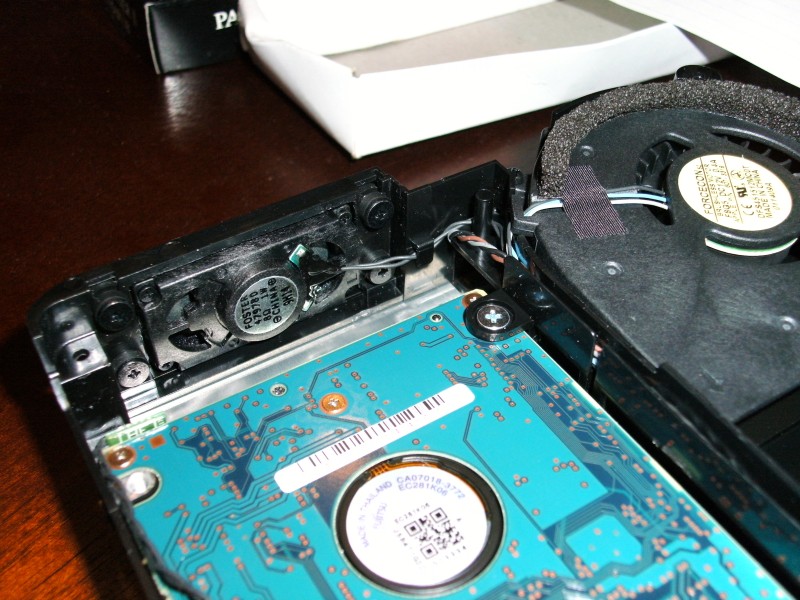

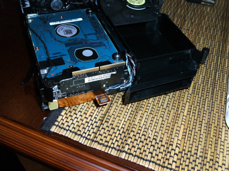

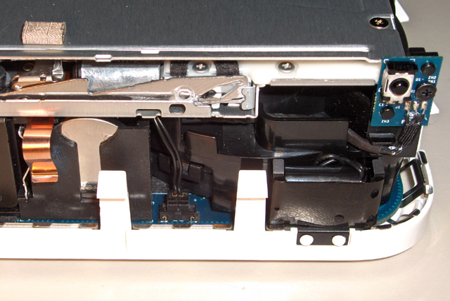

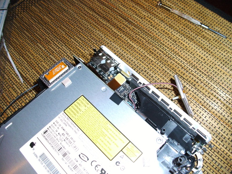

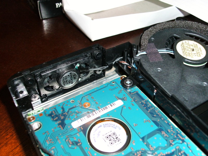

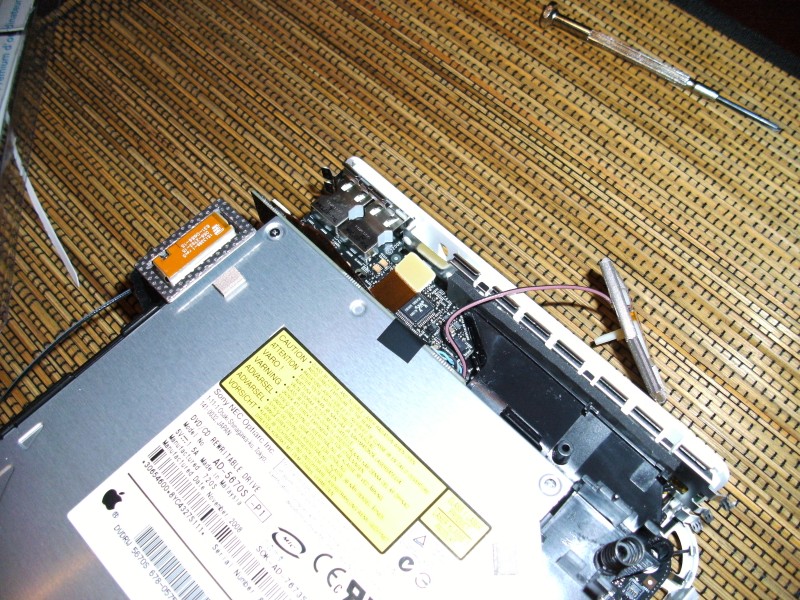

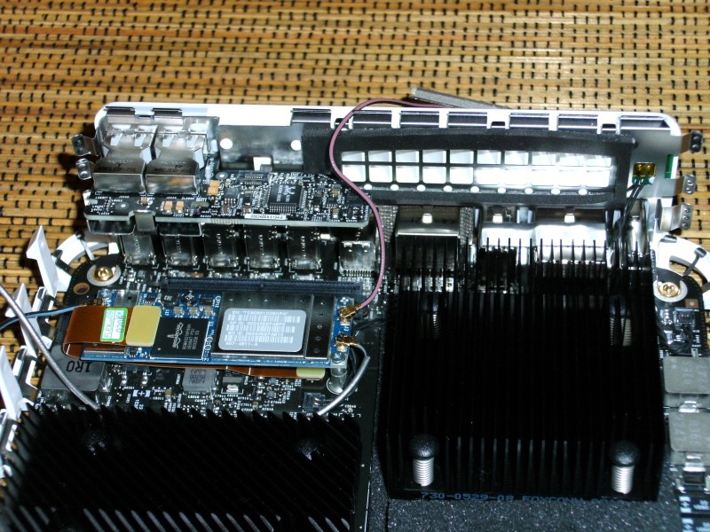

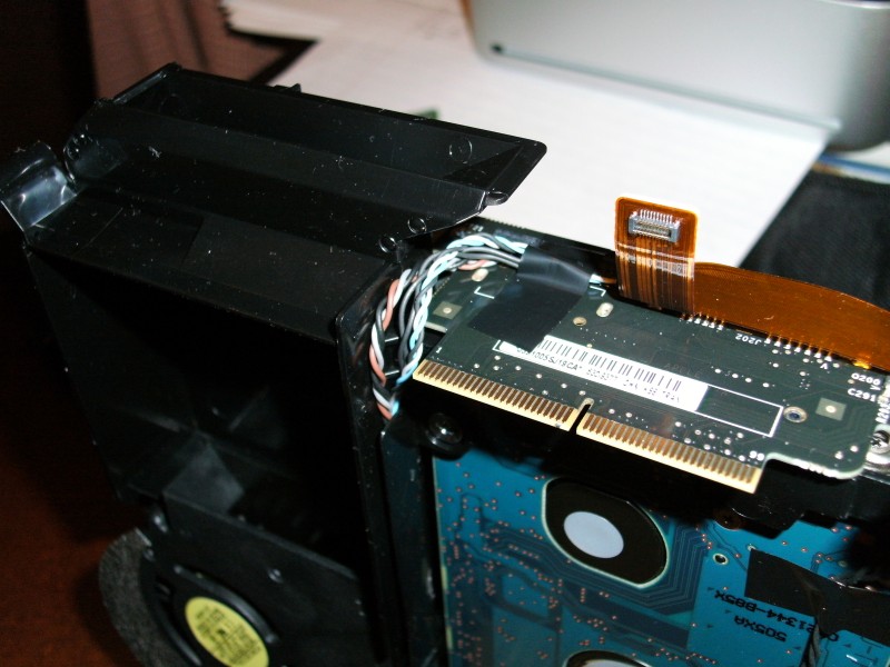

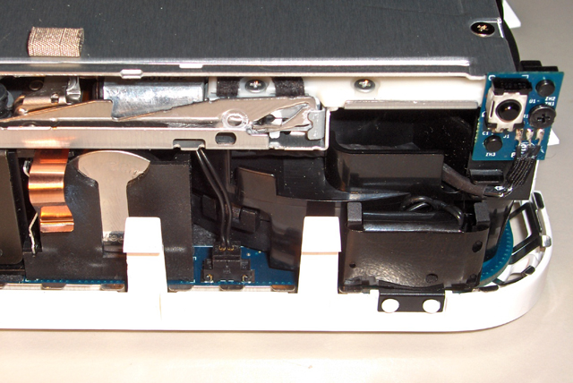

I've attached some pics if anyone knows what to look for. Everything looks ok to me, but I don't have sound. I tried the unplug everything for 15 seconds and plug back in trick, and also unplug everything for 10 seconds and plug back in the power with the power button down.
I can take more pics of specific areas if needed, and I have higher resolution of the ones I did take if anyone wants to see more detail.

I still haven't gotten my problem solved yet so if anybody has any ideas as to what this is please share, and mine looks just like the pics everything looks connected i have followed every wire in the thing many, many times and im just out of ideas. Now one weird thing was at one point i had sound..for a very short time maybe a half of a song and then it quit out so i dont know what that means if anything. On tuesday im taking it to apple to see if they can find something wrong and at least tell me what it is. Now i dont know if the warranty is void after opening no one really knows from what it seems, and it looks like i might have broke something so that would in turn void it i think.

If you look at the third and fifth picture, you can see a flat thin film connector wire (I have no idea what it is called). That rectangular end sits in a female mate on the main board next to the fan...you can sort of see it in the first photo. When you have the insides together, place your index finger over the end and gently push down until you feel it lock in place. This must be the sound connecting wires...because I had the same problem. good luck
That was it! I had noticed when taking it apart that there was some tension on that wire, but at the same time I noticed the tension it popped off. Then I thought maybe it was a temperature sensor (obviously it wasn't) so I just let it sit there kind of loosely. Makes sense now in hindsight.

if you are talking about the bronze ribbon cable in the back ive tried that many times and thats not it other than that im out of wires... and stickygreens wires i dont even have on the front of mine...
I'm sorry…but did you feel it click in place? It needs to for it to work.
yea ive done that and still no luck...when i first put everything back together i missed that but when i went looking i realized it was unhooked and thought that must be it but it still didnt fix my problem...ive taken the whole cable off and re-seeded it and still nothing. So to answer your question yes it clicked on both ends...any other thoughts...oh and thanks to everyone for being so helpful. So another quick question if i end up having to take it to apple should i put the original ram back in and play it off since i dont think that is my problem but they love to find reasons to void a warranty or will they get upset and void the warranty if new ram is in there.

Hey so sorta on topic. Anyone know how to remove this sound board yourself? I have my mini apart and I can't figure it out. I need to remove it for a minute while I cut a little hole. I searched and searched but haven't found any service manuals or anything for the late 2009 minis. ifixit has a teardown, but for some reason they don't take this part out in the teardown :-(
I think there was one screw holding down the board. After removing it, it's just a matter of sliding it out in an angle. The screw is in between the mic and speaker connectors.
