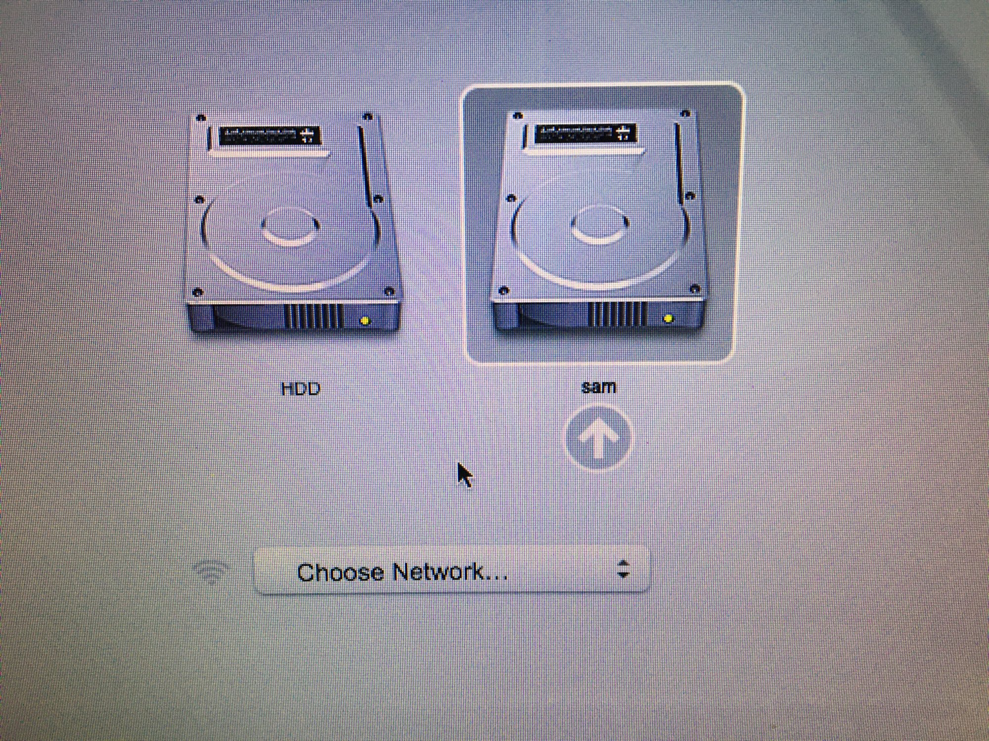

It wouldn't recognize the external drive. When I go to finder and look at locations I see Mac Mini and Macintosh HD. The Macintosh HD is the drive that showed after holding down the Option key.
That was from this screen?
You can still go the bootable installer route, same apple link as earlier, which will allow you to boot into a USB thumb drive (in this same screen) open Disk Utility, and try formatting your internal drive one final time. The upshot is you'll have a USB installer for OS X for future use.

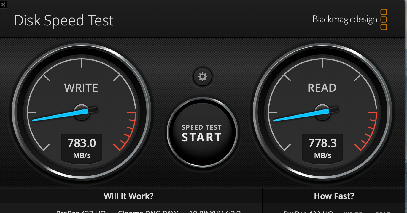

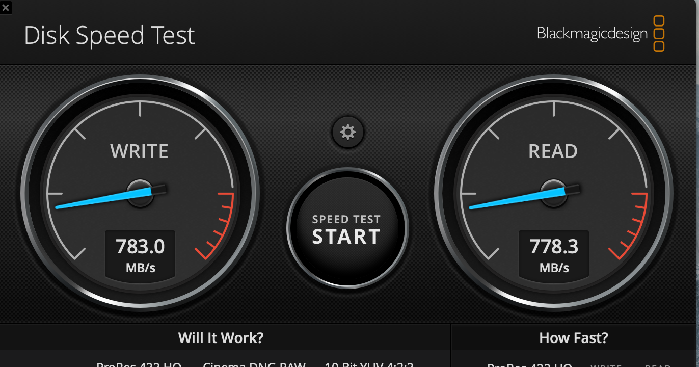

500mb second read and write on Crucial MX500 and T5. I have the newest Crucial external X8 that runs in the 700’s mb sec via USB-C. I think it would be 500’s in USB. Picture is Crucial X8
