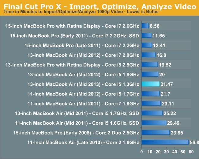

If you're really serious about video editing and need to stay on a osx platform, I'd really try to track down either a 2012 mini quad or just go iMac. Video editing/conversion is one of the specific instances where the quad core ivy bridge will be at least 50% faster (usually much more). It's also much more cost effective to buy 2 1tb 3rd party Santa drives which the 2012 can easily house inside before you start blowing money on TB enclosures that start around $400. Yes, the pcie Sata is faster,but no mini CPU ever made can outpace a Sata ssd in number crunching. It will take a bit more time to transfer the video to another device,but since most of us will be transferring to a regular mechanical HDD, the difference is moot.
The chart below is a bit outdated but notice the wide gap between the dual and quad cores.

Yeah, that move to dual rather than quad core is something you have to seriously look at. Depends on the software you use, of course, but those extra cores are huge. That's why people buy Mac Pros over even the latest iMac; even though the Xeon's lag in single core over the riMac they smoke it with anything that makes use of those extra cores, like much of Adobe's software as well as fcp.

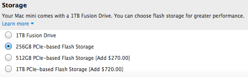

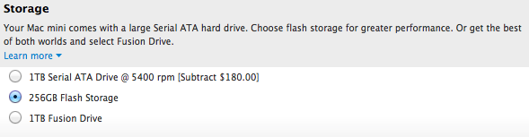

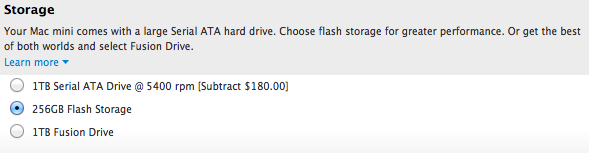

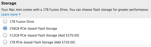

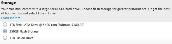

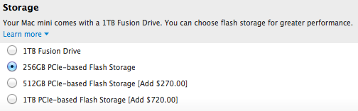

Which model do you get to have the just flash option? Is it me or something I don't see on apple.com/store? I can only get the PCIs option.
Same here, I was under the impression there was only 1 storage bay option now anyway.
