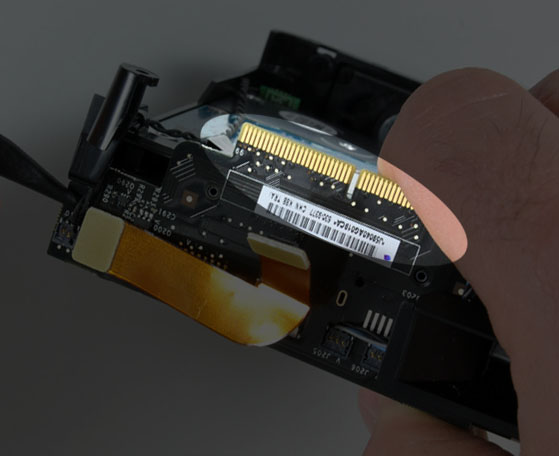

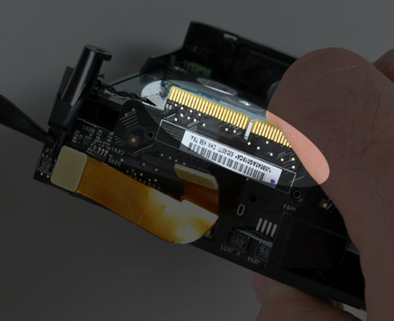

When you put the top tray (hard drive, optical drive) back on, observe that the riser slot slips into the socket.
When I was upgrading my mini, I broke off the part where the ribbon cable sits (part is shown above). It beeped. Also be sure that the RAM is seated correctly, at first I didn't have my RAM seating correctly. Check those things and see if everything you disconnected is tight and secure.
