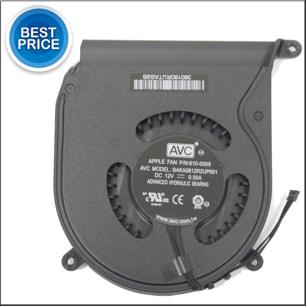

Delta Electronics, Apple P/N 610-0164 https://d3nevzfk7ii3be.cloudfront.net/igi/aHAOFJ1VrbZJSpuY.huge
AVC, Apple P/N 610-0069 http://i01.i.aliimg.com/wsphoto/v0/...953-610-0164-For-Mac-Mini-A1347-2010-2011.jpg
If so, is one of these two quieter by its mechanical construction (bearings etc.) while keeping the CPU temperature down similarly as the other type (i.e. both achieve the same air volume flow)? Delta version name plate says "DC Brushless" whereas the AVC's says "Advanced hydraulic bearing".

Also from memory the delta fan is noisier by design.

No source I had a delta fan in my server now I don't lol

Wonder if either one Delta or AVC fan of the MagLev 2 type referred to in one of my posted links?
Trust me the delta fan is noisy. I have one in a box and it was removed because it was noisy. The other fan is quieter. Honestly though I would replace the thermal paste and see if that helps.
