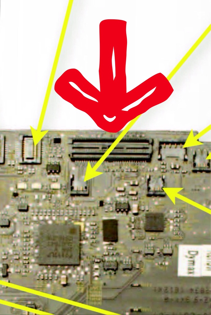

In the "Mac mini mid 2010 Apple Technician Guide" I found a photo of the logic board and noticed that on mine there's a missing piece of black plastic (see picture).
Does anybody know what it is?
Could it be the reason why the mini won't boot?

The photo you are looking at may be of a preproduction or unfinished board. I don't know of any that do have a slot there (mine certainly doesn't) or what it would be used for.
Looks like a debug connector (LPC+SPI Debug Connector 30 pin). These are fitted during development to allow monitoring of key data to check timing and other parameters.
Production machines have the physical connector omitted. Quite normal on late Macs.
That's quite reassuring 🙂 On my board I can see the exposed contacts and when I saw the above picture, I nearly freaked out 🙂
I thought it was a microchip of some sort.
I feel much better now.... Thank you for your replies..
