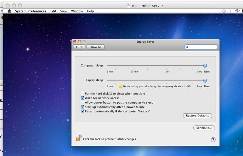

Greetings...I have a mac mini server that did not automatically restart after a power failure. I do have the the server power setting option "Start up automatically after a power failure" setting enabled (See attached screenshot)
Are there any other settings I have to enable to get this feature working correctly? Or I am not completely understanding the setting (entirely possible 🙄).
Any direction is appreciated.

Click restore settings then reboot then edit to your needs and lock the settings. Reboot and test. Should sort it as I had to do this.

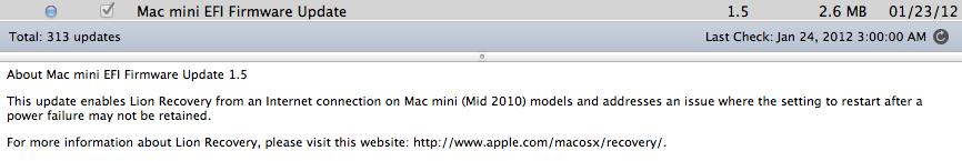

If you have a Mid-2010 model.
