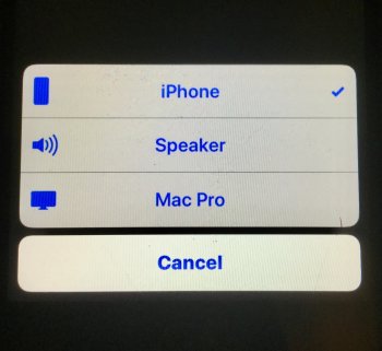

Okay...now my 2010 Mac Pro is showing up on my phone. The only way I removed my Mac Mini was turning off iCloud.
I cannot do that on my Mac Pro.
How do I remove the computers from my phone list...my MacPro does not even have a mic.
I have turned off Handoff, etc.
Here is what I am trying to remove...the Mac Pro from the audio option list:
While driving, I noticed even while I was miles away from my MacPro, it still showed up as an option. Once I got to work to an iMac running 10.13.2, the iMac showed up.
Odd that even 20 plus miles away, my home MacPro would show up! I even restarted my phone to see if it would change, it did not.
Okay...I think I figured it out:
Under Celluar > Wi-Fi Calling (I had it turned off completely), you need to turn it on and then turn off all of the devices there and leave the Wi-Fi Calling setting "On."
Apparently, turning the option off completely does not work.
