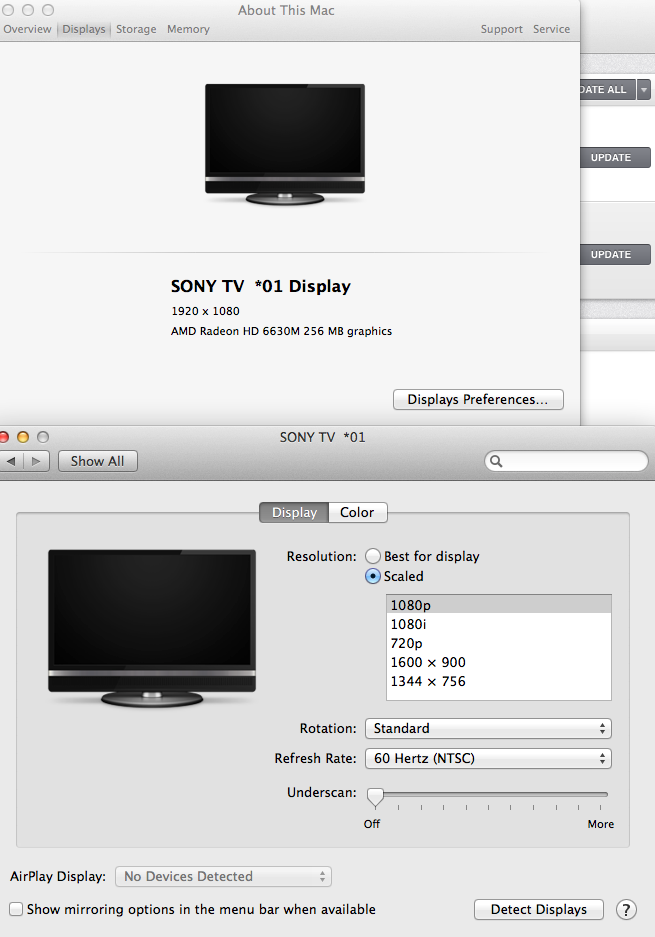

Guys, did any one had troubles with setup of HDTV on Mac mini?
It works, but it seems that signal from Mac is not in HD.
I do not know what may be the reason.
Macmini 2011

Ok. So it's outputting 1080p. Good.
I'm suspecting the issue is on the TV end. Not sure what it's called on Sony TV's but looks like it may have overscan compensation going on. If you output the OS X desktop to the TV, do you see both the menu bar at the top of the screen and the dock at the bottom? If not you need to look through the TV menus to turn off overscan compensation.. not sure what it will be called on Sony TV's.

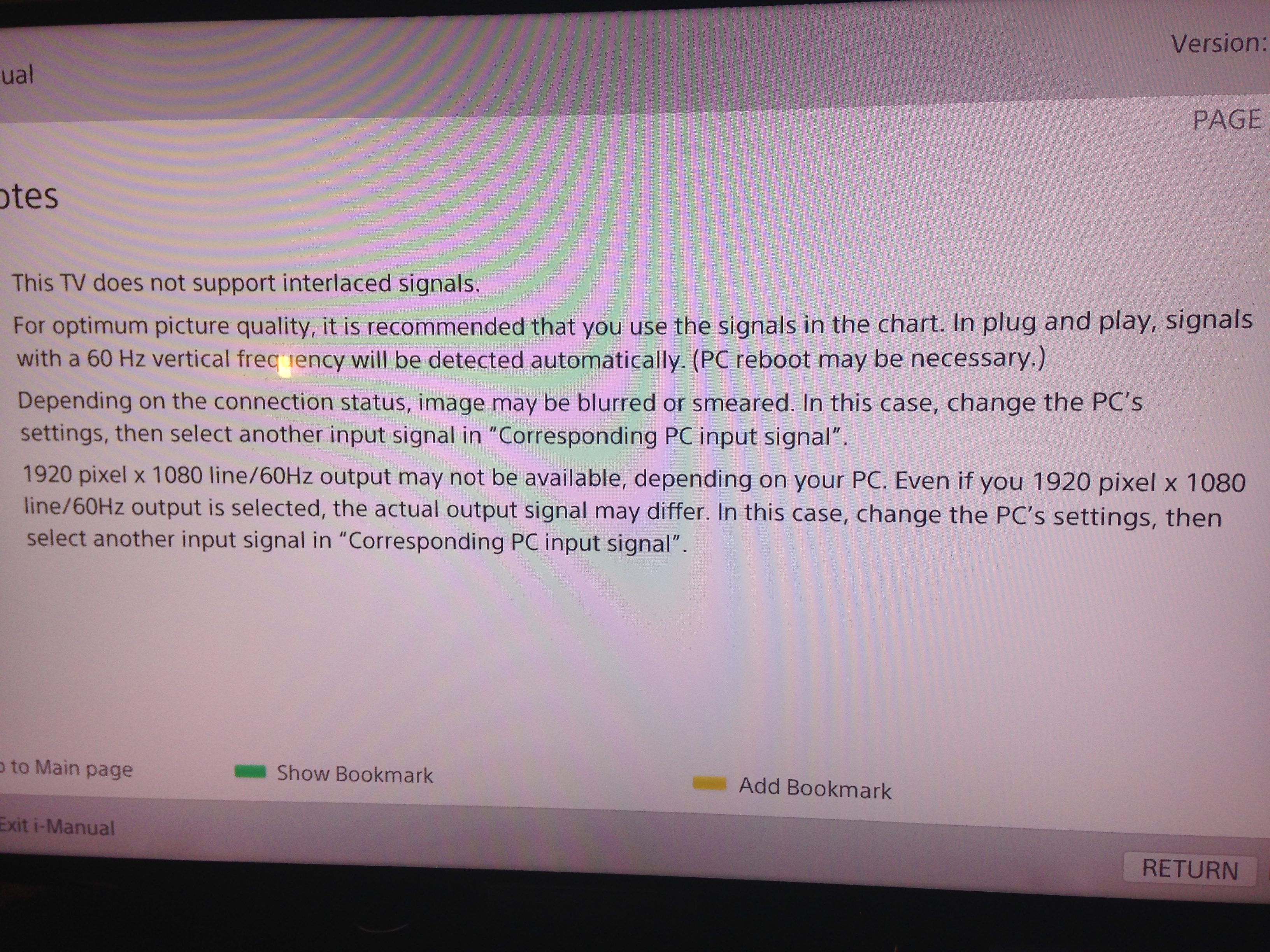

http://pdf.crse.com/manuals/13HG900111/EN/c_picscrn_size.html
The [Display Area] section is probably what you want to flick through.

Yup, it shows perfectly. I don't need to resize picture or else. It's just my icons(picture) on desktop not crisp.
Many thanks for the manual, i'll try this today.
well i've tried all the options and the picture not sharp as it should be...
this tv do not have full scan option
