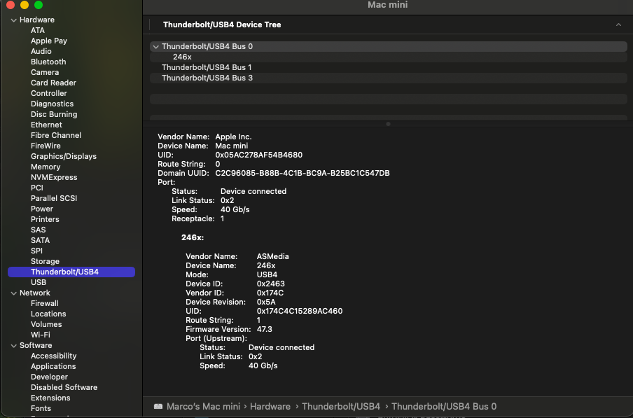

In System information i can see the device connected on thunderbolt usb4, the only problem is, doesnt mount himself. iHave to unplugged and plug again the cable:
Thunderbolt/USB4 Bus 0:
Vendor Name: Apple Inc.
Device Name: Mac mini
UID: 0x05AC278AF54B4680
Route String: 0
Domain UUID: 0CC866A8-27DC-4E55-ABCE-F0B9A2DBDDE8
Port:
Status: Device connected
Link Status: 0x2
Speed: 40 Gb/s
Receptacle: 1
246x:
Vendor Name: ASMedia
Device Name: 246x
Mode: USB4
Device ID: 0x2463
Vendor ID: 0x174C
Device Revision: 0x5A
UID: 0x174C4C15289AC460
Route String: 1
Firmware Version: 47.3
Port (Upstream):
Link Status: 0x2
Speed: 40 Gb/s
Reactions: Patrice Brousseau
This is helpful as it confirms at least the system sees the devce.

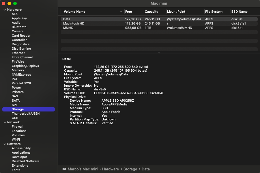

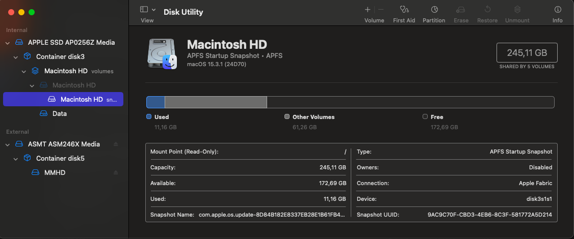

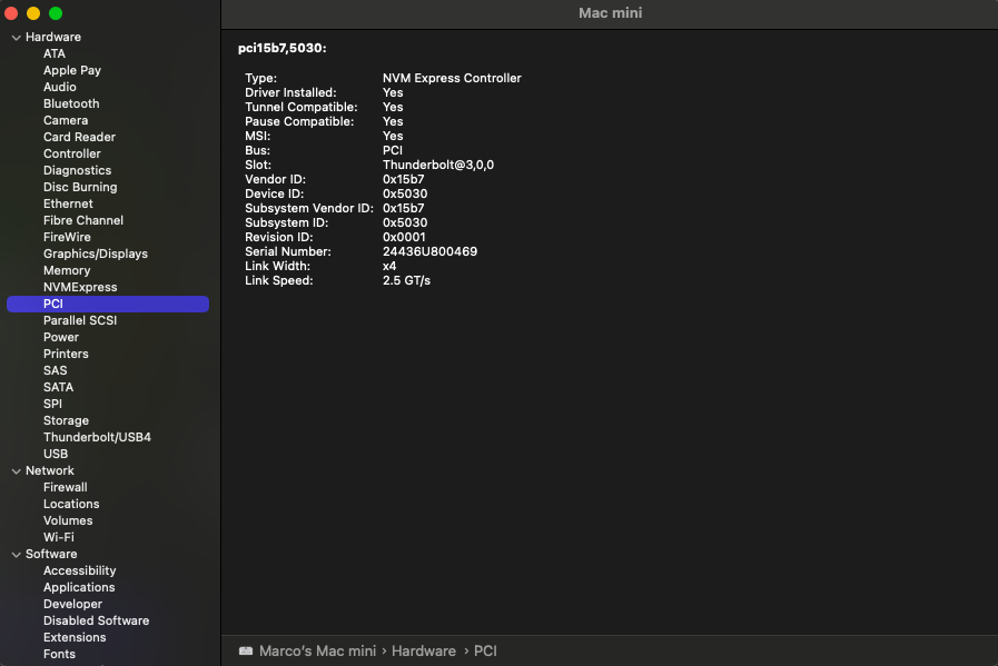

the resets didnt work...

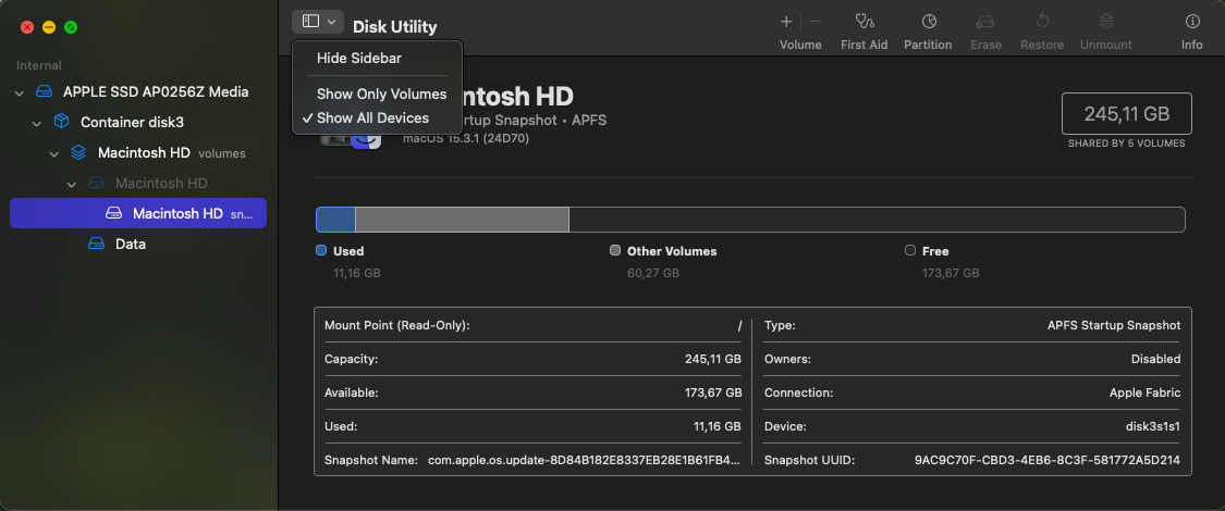

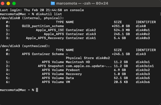

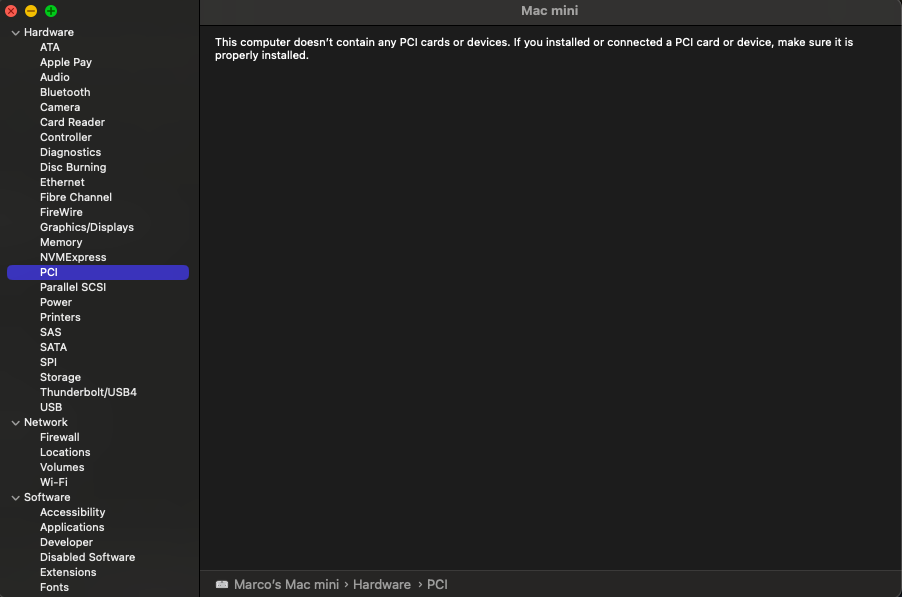

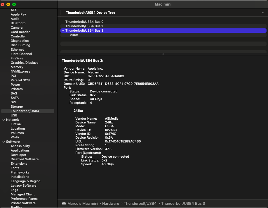

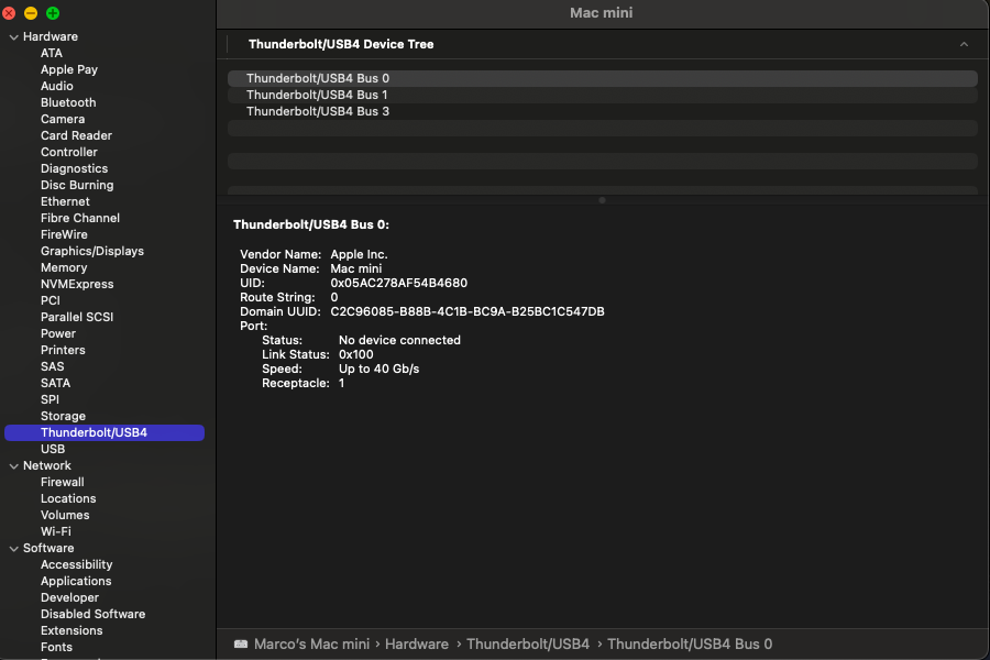

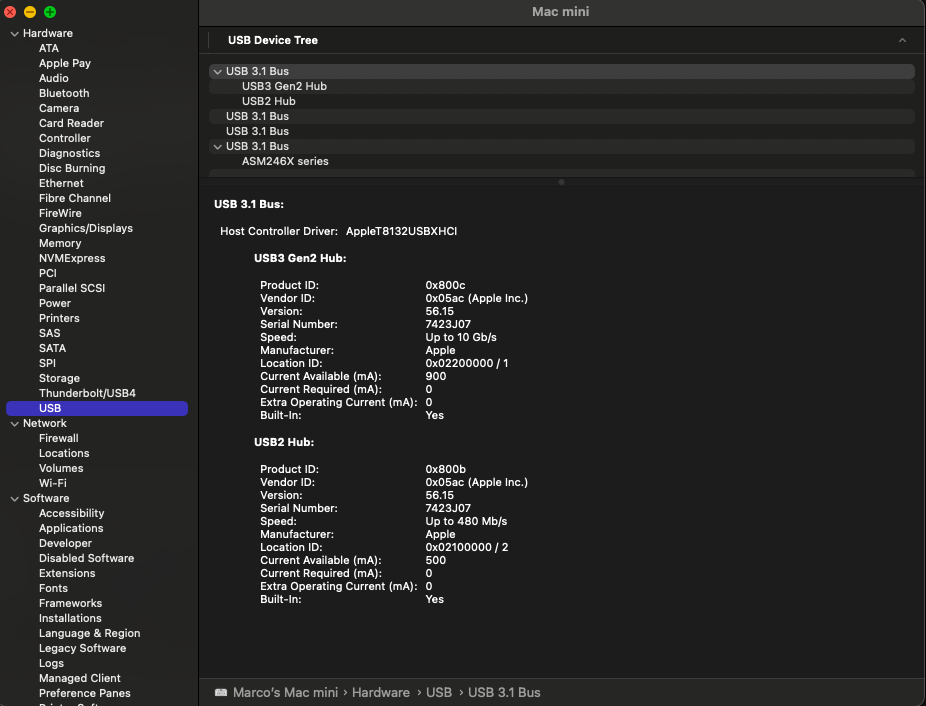

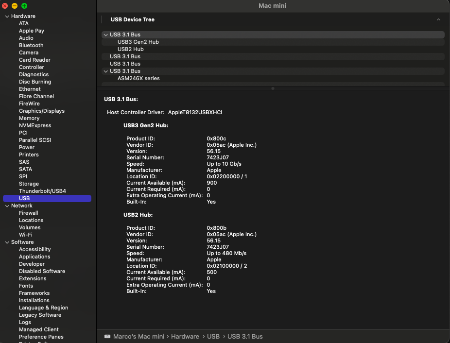

here's some screenshots from disk utility and system information (thunderbolt port) thank you for helping
Just to confirm -- these are from the initial boot when the drive is connected but not mounting the filesystems on the drive? Would be good to also repeat the same after you unplug and plug. Also curious the contents of the NVMExpress and USB trees of System Information.
Based on your screenshots, the system sees the enclosure and is establishing a bridge though it to access the Samsung via NVMe as if it is on the PCI bus. That's good though there is the oddity of the slow link speed shown under PCI. Then definitely not showing up under Stroage. The gap in the chain would seem to be in NVMExpress so would be good to see the screenshots from it as above. Then I'd be curious if when you unplug and plug back in and how all these look (plus the USB tree before and after).
Though too soon to tell I'm leaning towards an Thunderbolt/USB4 cable or enclosure failure that was just conincidental with your power failure.
Also, no harm either in trying it in a different slot as another poster mentioned.

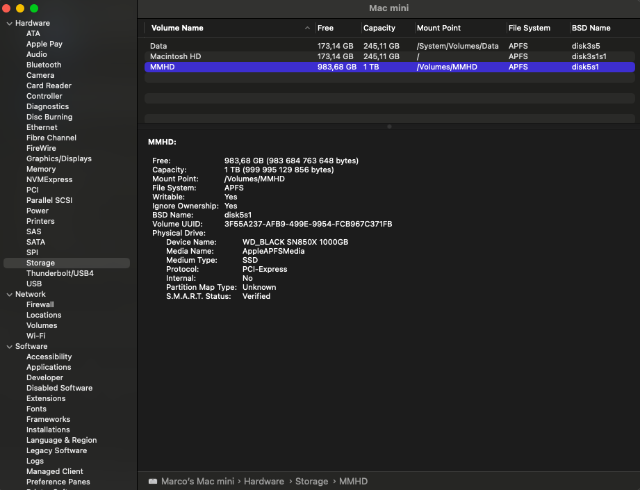

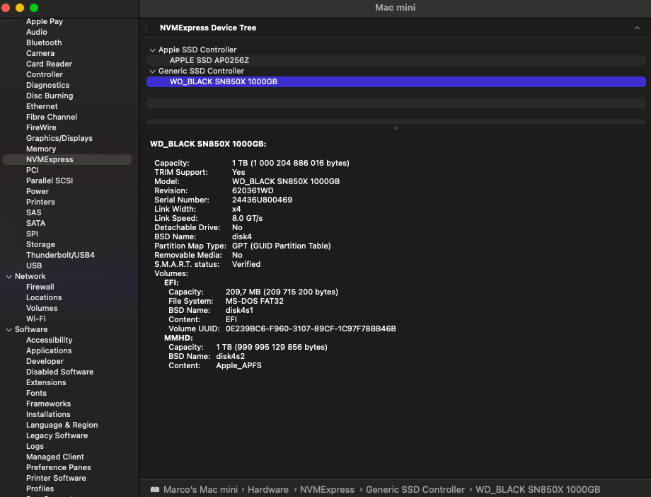

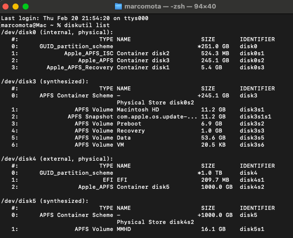

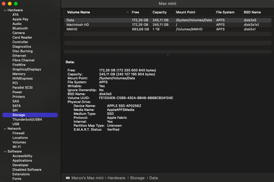

repeating with the unplugg and plug again.... "This SShots are with the SSD working perfectly"
I am not quite sure it's perfect. It looks like it is connecting via USB 3.1 even though I understand you are connecting to the same Thunderbolt 4/USB4 port on the back?
One thing on these last screenshots it would have been helpful to click on the drive -- so "MMHD" in the first one above and "ASM246X series" in the last one. Otherwise it doesn't show the details specific to the drive. However, I think we know what it will say -- that it is connecting the drive via USB protocols and link speed 10Gbit rather than PCI-Express protocols and link speeds 40Gbit.
The one screenshot still missing is the "NVMExpress" tree right after the initial boot (i.e. when it's showing up under PCI but not under Storage). That's where the gap is between seeing the enclosure and drive on the PCI bus and nothing showing up in Storage. Not sure at this point it will give us insight but by chance it might.
In the meantime, just to confirm:
-If you unmount/eject, unplug, wait 30 seconds, and replug in the back, does it ever show up again under the Thunderbolt/USB4 tree?
-If not, do you get different results when you do the same in either of the other two rear ports?
-If you boot with it connected in the front, does automatically mount?
-Also you mentioned that it takes a long time to mount if you plug it into a USB-C port -- was that front? Is the time to mount the same with the front USB-C ports as when you unplug and plug it into the rear ports?
-What is the exact model of your old iMac? iMac models 2017 or later (iMac18,1+) had Thunderbolt3 ports. If your iMac has Thunderbolt 3, does this enclosure show up under the Thunderbolt tree of System Information when you plug it into one of its Thunderbolt 3 ports?

i changed the rear port and i send you some prints (after unplug, wait 30 seconds and plug again)
Just to summarize and validate the situation/data points we have across the postings:
-Booting with drive connected to rear port 0, the SSD drive is visible on PCI bus but system does not present filesystem(s) (not visible under 'Storage', unclear 'NVMExpress')
-Unplugging and replugging in a front USB-C, enclosure/SSD drive is visible as a USB storage device and mounts filesystem, etc (though it takes a relatively long time)
-Unplugging and quickly replugging in to rear port 0, enclosure/SSD drive shows up a a USB device similar to having been plugged into front USB-C?
-Unplugging from port 0 and waiting 30 seconds, and plugging in to rear port 3, SSD drive is visible as an NVMExpress device and mounts filesystem as expected?
Besides testing another cable (which is now unlikely the issue assuming that last configuration holds and is reliable), does the system automatically mount the drive properly at boot if connected to rear port 3?
When unplugging and replugging in port 0 and the drive mounts as USB, is there any difference in the time to mount as compared to when plugging into a front USB-C?
Did the drive automatically mount when connected at boot to a front USB-C?
-Unplugging and quickly replugging in to rear port 0, enclosure/SSD drive shows up a a USB device similar to having been plugged into front USB-C? (yes)
-Unplugging from port 0 and waiting 30 seconds, and plugging in to rear port 3, SSD drive is visible as an NVMExpress device and mounts filesystem as expected? (yes)
Besides testing another cable (which is now unlikely the issue assuming that last configuration holds and is reliable), does the system automatically mount the drive properly at boot if connected to rear port 3? (i dont have another cable to test it)
When unplugging and replugging in port 0 and the drive mounts as USB, is there any difference in the time to mount as compared to when plugging into a front USB-C? it's fast on rear... and works well after
Did the drive automatically mount when connected at boot to a front USB-C? yes, but it takes some time. i'm trying to boot, and i'm waiting 5 minutes... not mounted until now.
I don't have an explanation for why this drive would mount dramatically slower when connected to the front USB-C ports than the rear USB4/TB4 ports. Peak transfer rates can be up to 2-4x faster over USB4/TB4 than USB 3.x 10Gbit but that shouldn't be an issue for mounting.
For now let's assume the issue has to be one of these 4 things:
-NVMe SSD
-USB4/NVMe enclosure
-USB4 cable
-Mac Mini rear USB4/TB4 port 0
Then we have these data points:
1. Mac Mini M4 rear USB4 port 0 (assuming leftmost), connected at boot: tries to connect at USB4/NVMExpress and then fails (more details about this may be under the NVMExpress tree of System Information)
2. Mac Mini M4 rear USB4 port 0, unplugged and replugged after boot: works fine except at USB3.x (lower peak speed and other limitations plus annoying to have to unplug and replug)
3. Mac Mini M4 rear USB4 port 3 (assuming rightmost), unplugged and replugged after boot: connects at USB4/NVMExpress and works fine (unclear if same result when connected this way before boot)
4. Mac Mini M4 front USB3.x 10Gbit: takes a long time to mount but then performs well (of course lower peak speed and other limitations)
5. Mac 2013 USB 5Gbit: performs well but of course at 5Gbit
Given cases #2, #3, and #5, it seems unlikely the NVMe SSD, enclosure, or cable. Though given #1 and #4, I am less certain about the enclosure and cable. Plus I can't explain the long time to mount under #4 but not #2.
For now, I would try booting with the enclosure/SSD connected to rear USB4 port 3 and seeing if it connects to the drive as an USB4/NVMExpress device at boot and automatically mounts, too. If so, I'd say issue #4 is unrelated and the more important issue is that USB4/TB4 port went bad. If the system behaves differently whether the SSD/enclosure is connected to rear port 0 versus rear port 3, I'd return to Apple to fix (likely requiring a new logic/system replacement).
One other weird thing you could try as far as #1, #2, and #4, is plugging the cable into the Mac with the USB-C connector rotated 180 degrees. This should not make a difference in any proper cable/device/etc and should not make a difference with any USB4 device. I've only heard issues with this in case of USB-A <-> USB-C scenarios and so shouldn't make a difference. But given some of your unexplained results and testing this should only takes 10s of seconds, I would just repeat #1 and #4 above with the cable both ways for sanity's sake.
i notice something, even if i tought i was buying a thunderbolt 4 cable, i realized it's a usbc4 cable. maybe it's because of this?
The standards are way too complicated these days but the summary is that a USB4 cable might be of high-quality but it isn't certified to the same level. Whether it works in all USB4 situations depends on the manufacturer. An Intel-certified passive TB4 cable should "always" work for all USB4 and TB4 situations.
