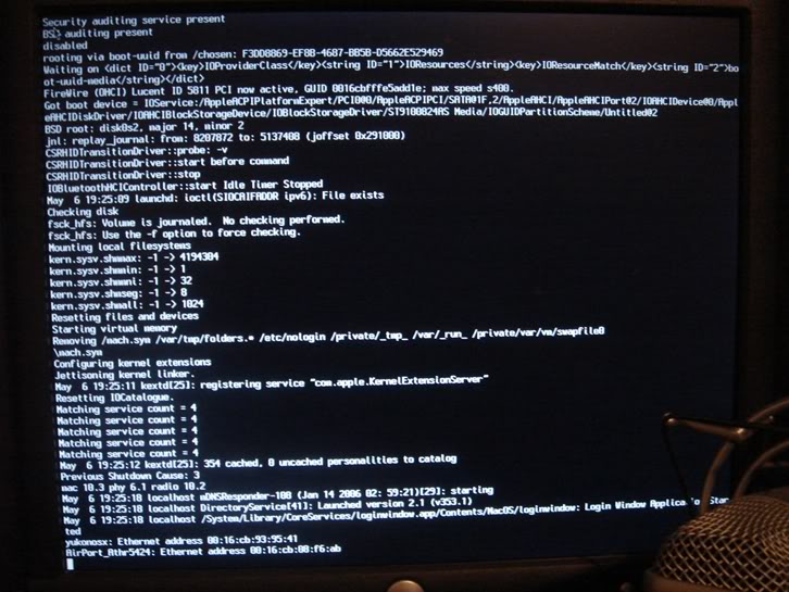

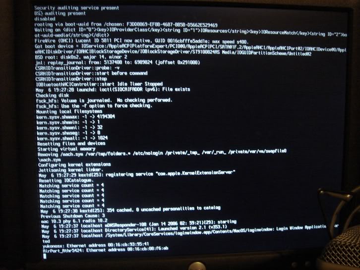

I booted up my Mac Mini last monday to find for some reason it is stuck in that loading screen which displays a grey background, the apple logo and a round loading swirly sign.
I have tried running disc utility and trying to repair it but it dosent detect any errors, i also tried clearing the PRAM according to Resetting your Mac's PRAM and NVRAM and still no joy.
Ive done a total reinstall of OSX and went through an hour and a half of erasing and reinstalling osx from its supplied discs, however still it wont get past the loading screen. I've used a usb hard drive aswell and tried installing osx onto that to see if it was a hard drive error but it still gets stuck at the same loading screen.
Strange thing is i can access safe mode without a problem
I have done numerouse hours of searching the web without any luck to a cure to my specific problem, so am posting this as a last attempt to see if any of the more technology minded guys out there know of or can help me work through a solution, if you could i'd be eternally greatful as i use my mac mini quite alot.
Specs are Mac Mini 1.66GHZ intel duo core 2, 1gb ram, 10.6 OSX (upgraded from 10.5) 100gb hard drive

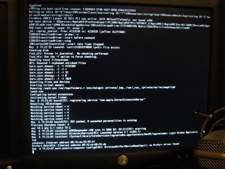

I have also started up in Verbose mode and got alot of info that i dont really understand, ive attached screen shots of where the loading screen gets stuck in verbose upon 4 attempts at booting up the mini.

Hi thanks for the comments, yes the installer dvd boots just fine and as i stated in my first post i've already sucessfully installed osx onto a usb hard drive to see if it was the mac mini's internal hard drive that was at fault but after booting it hangs at the same place the mac mini's hard drive hangs at.
To give a better idea where it hangs i've uploaded a 720p video to youtube of what happens the moment i turn my mini on (in verbose mode).

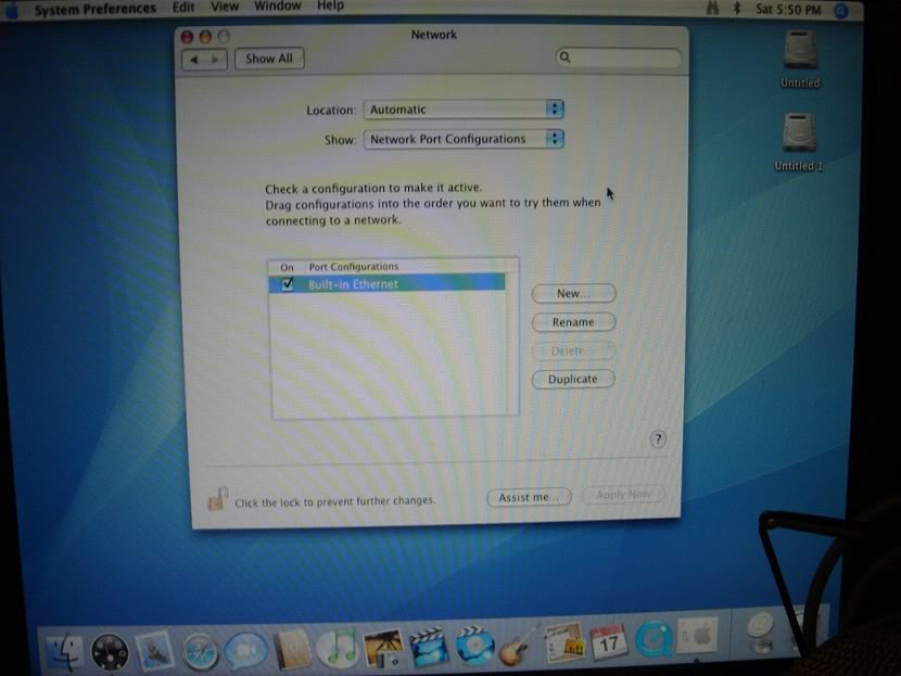

I looked in "system preferences - network" for the ability to disable airport but all it showed was "built-in ethernet" and in network port configurations there was no way to turn airport off other than to just untick ethernet.
I unticked ethernet anyway and rebooted but faced the same hang where it stops at airport command again.
Not sure how to turn this airport card off, and dont understand why it denied my command. any ideas?

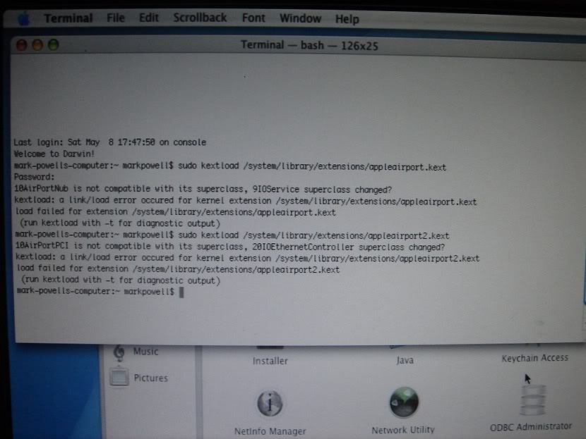

I tried as you suggested by turning wireless on in safe mode however i encountered some error im not sure what it means so ive included a screenshot:

As for trying to delete the wireless airport it never showed up in the network window, all it recognises is the ethernet as per below:
Looking over this again...what happens if you click the New button, do you get an option for Airport? On my iMac with OS 10.4.11 I also have available Built-in Firewire and Internal Modem, it's odd that you don't have the Firewire either, or maybe that only shows up if you use it. 😕
If i click new i get the option of adding either "built in ethernet" or "6 to 4", no other options are available.
Information appears for firewire in the "system profiler" so im not sure, however for airport it says "No information found"
Hmm, odd, for mine I get Internal Modem, Built-in Ethernet, Built-in Firewire, and 6 to 4. I don't an get option for Airport because my iMac doesn't have an Airport card installed in it, they were optional back then.

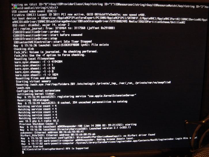

I've attached a bootlog report of my system showing as i started up in normal mode, it froze, i powered off and on again launching safe mode.
Maybe the data will mean something to someone who reads bootlogs, not sure if it gives indication of where the problems are at other than as we suspect in the airport card.

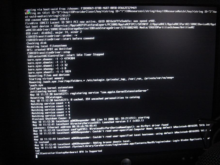

Well i opened the mini up today and removed the airport card, reinstalled OSX and got stuck in the boot screen again showing this:
Don't know how to proceed now
