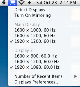

How do you get 2560x1440 over HDMI?
Hi,
how about this:
My multi-display setup
Just to weigh in, I have two displays attached to my mac mini. One DVI monitor to the mini DVI port and my television to the HDMI port. Works great, I can watch hulu/netflix on my 32" screen.
It works best if I do not mirror the displays as they are set to different resolutions. I set the monitor to 1680x1050 and the TV display to 1080p.
