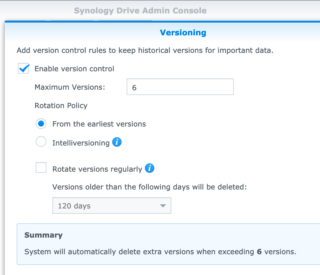

All the above (and a few other things) are why I switched to a Synology NAS, and use their Drive backup/sync tool instead of TM. While it does have its own quirks and shortcomings, I wanted the version control and autodelete features, not to mention it seems to do much better over wifi and even over a WAN...both of which are problematic with TM, or at least have been in the past.
Synolgoy version control:
