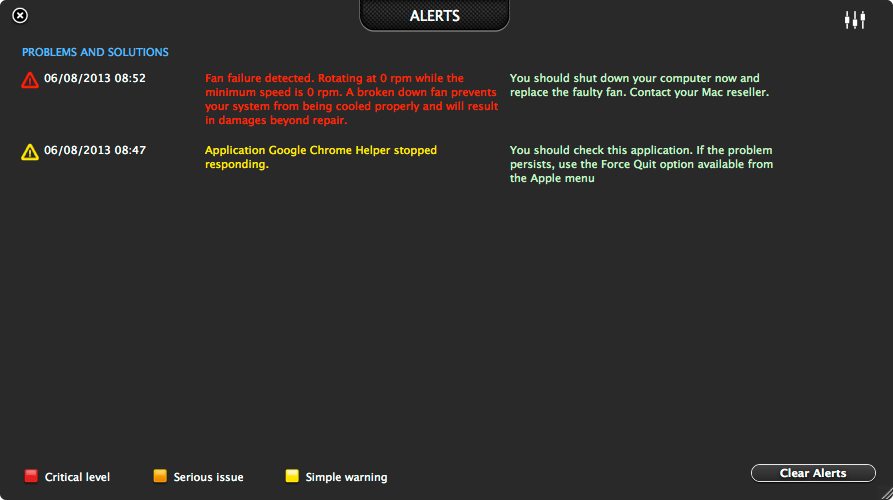

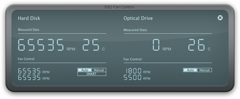

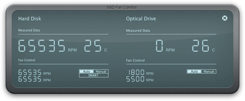

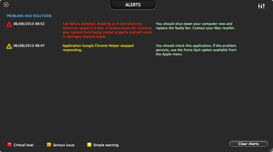

As soon as I switched it on this fan type sound kicked in and doesn't go away. And it is well noisy. I ran the xScan and it almost immediately pointed out the fan needs to be replaced, apparently it is running at 0 RPM. Image attached. Then I ran the SSD FAN control program, see image attached. Whilst SSD figures I can undedstand 65k RPM (well it doesn't spin) the optical drive is stick on 0 and can't be altered.
So does it mean that the optical drive's fan is not opetating? But what is spinning on that case and sounding like a hovercraft?
Can it be a software issue? One guy suggested that possibly Mountain Lion wasn't installed correctly and that has caused the fan non responsiveness.

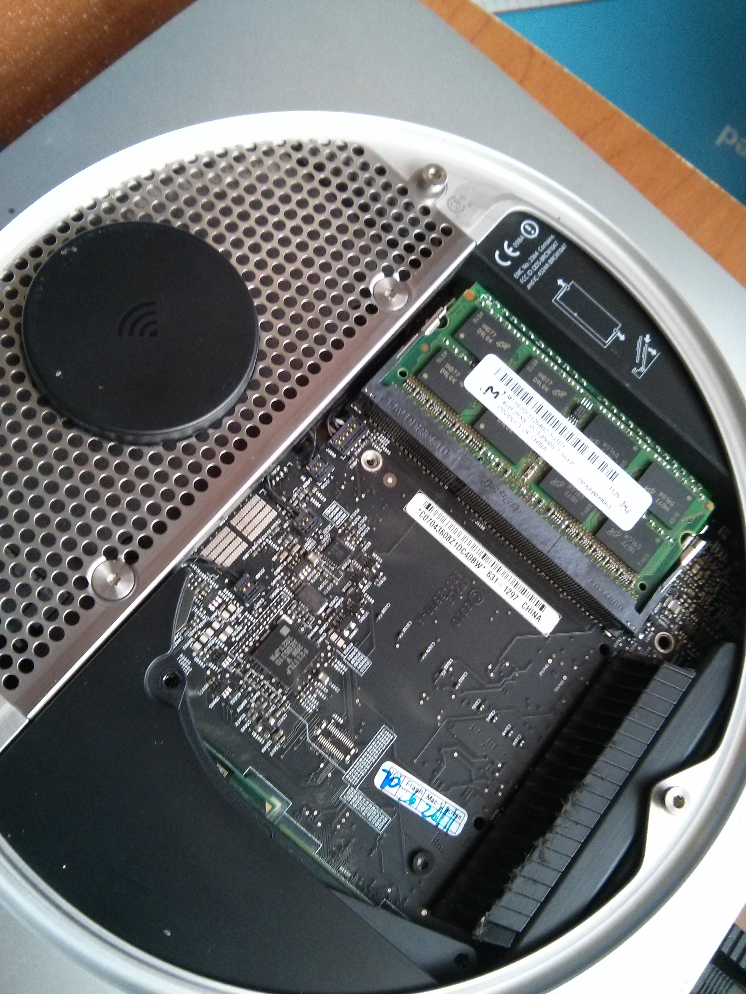

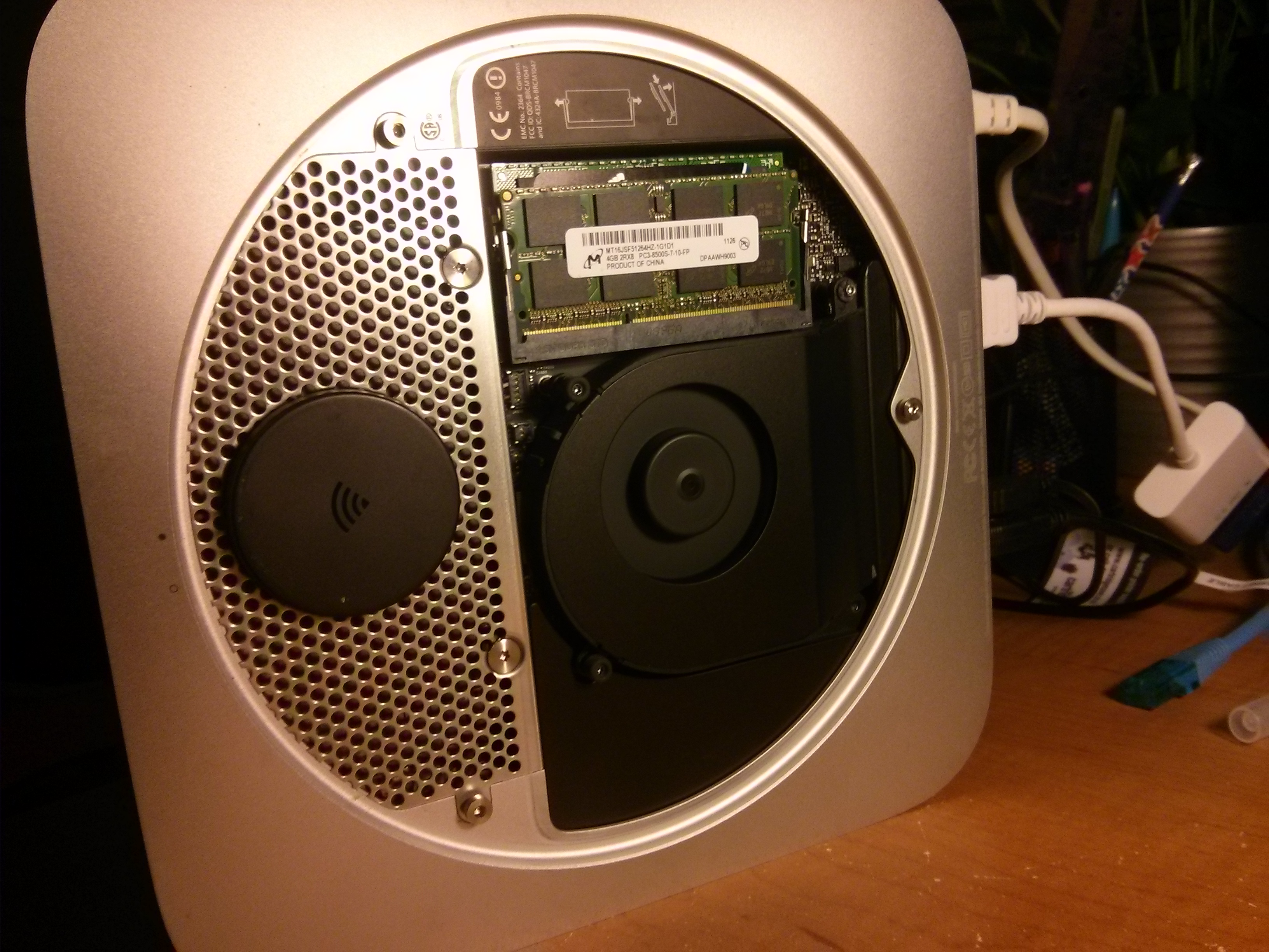

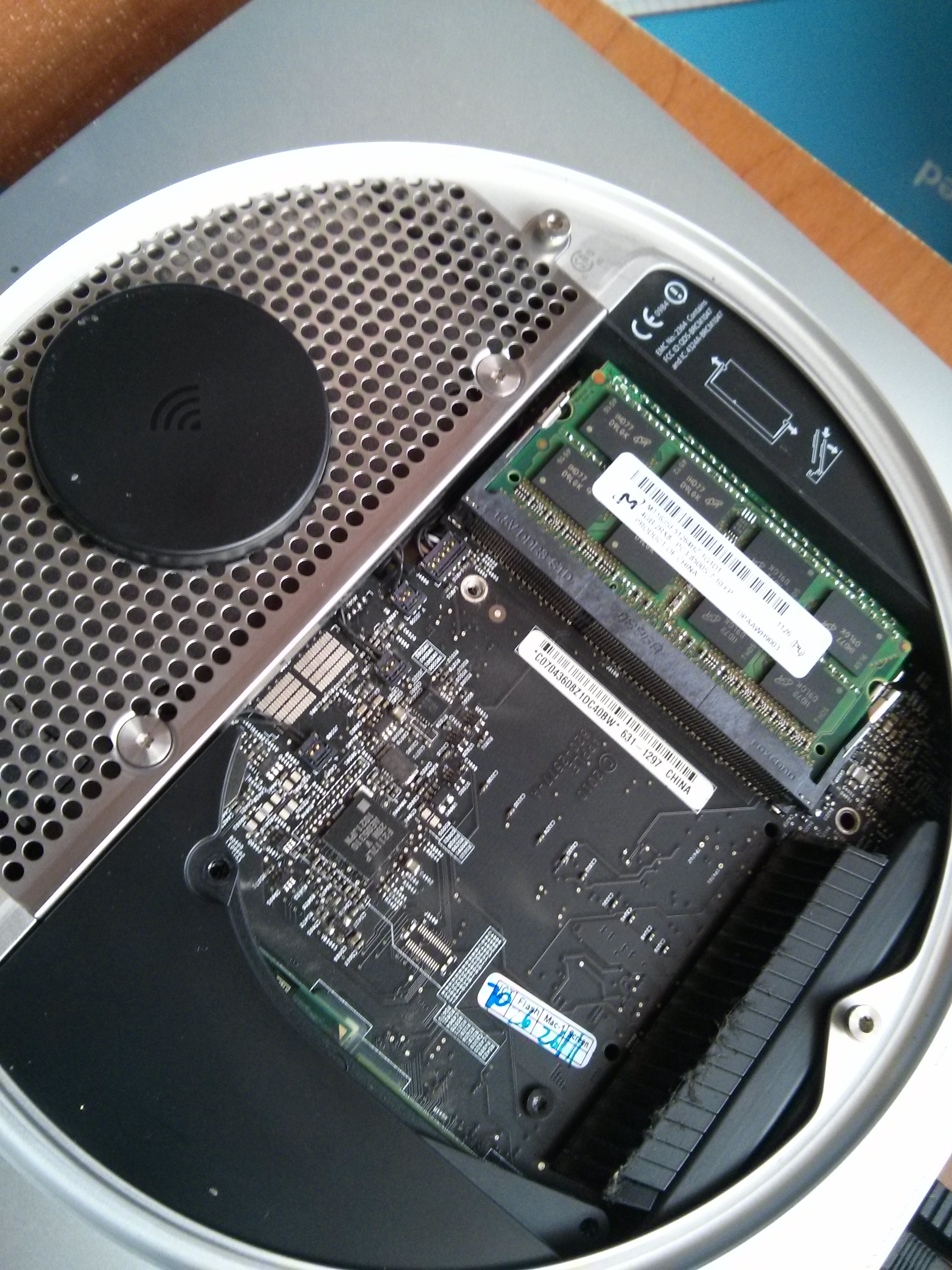

Ok I took cover off, there was a bit of dust, can't remove fan cover though as I don't have the right size screwdriver. Fan spins all the time.
The fan should normally be on always, but if the computer is not under load the fan should be spinning around 1800 RPM and be nearly silent. You can get a torx driver set and take the fan out for cleaning. There are good dissassembly manuals here http://www.ifixit.com/Device/Mac_Mini_Mid_2010

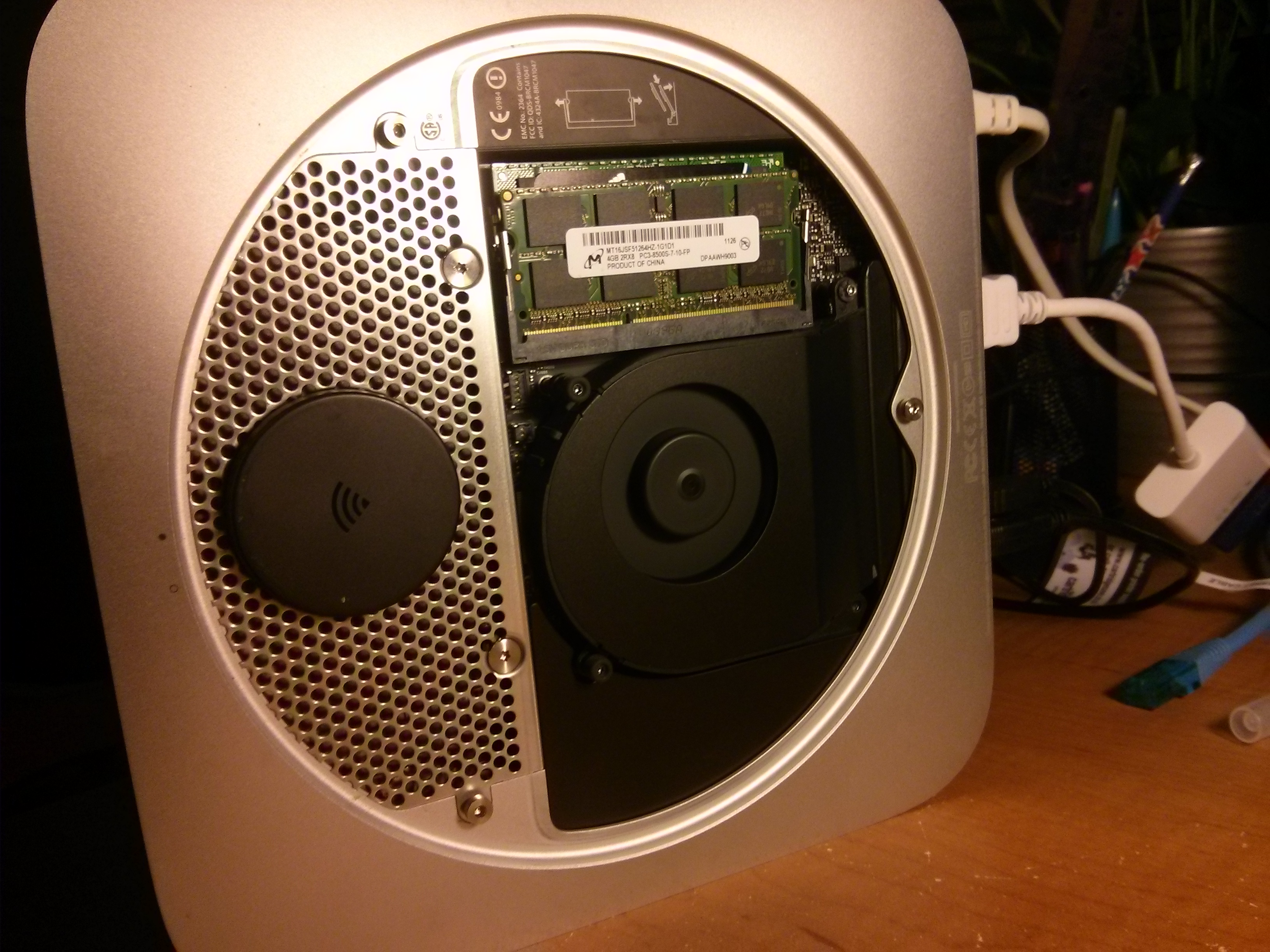

Had an Apple guy have a look at it & he advised to send it back as RAM is mismatched, RAM holder is broken & cable fitting going from fan to logic board was pretty much broken, was held on very loosely. That's without looking at an HD. So back to seller it goes. Thanks for all advice!
