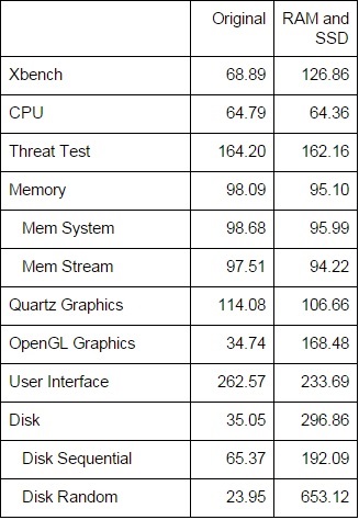

Thanks for both of the replies. I will read the forum on the Crystal decoder a little more carefully. I have a question about the firmware. I thought I needed to change the CPU to a C2D from just the CD that is in there before I did this. I wanted to share that the Mac mini boots up just fine with 1 x 2 GB Dimm in the slot. Looking online I saw a few posts that suggested this might work, but not that confirmed it. I can confirm. So for now, I am using 2 GB of ram on one stick and it certainly has made a difference. That and moving to an old SSD.
Benchmarks if anyone is interested.
Next I hope to move to OS X 10.6, then upgrade the CPU, then firmware & 2 GB more ram!
