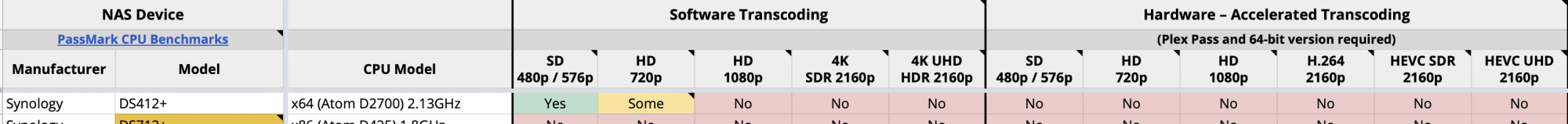

I have a Synology DS-412+ fully-loaded with 4x4tb = 12tb SHR (Their RAID-5 1-disk fault-tolerance).
My ethernet (backbone) switch is a Netgear Pro-SAFE Gigabit.
Running DSM-6.2.x . Set to SMB-2 (and higher). Just the 1 ethernet-cable connected to it.
All my files and media are on it.
Windows-10 (where I usually do my file maintenance from) says transfers are around 110MB/s .
Plex (server) is installed from Synology package-store.
My Apple-TV-HD(Gen4) is where I run the Plex (client) app and watch from (in home theater).
So, is the NAS running everything (including trans-coding) or is it the Apple-TV-4 ? Is the NAS just "serving up the files" or something more ? Or asked another way, if a high-bit-rate (or high resolution) file started buffering, which one would need to be upgraded ?
My ripped MP3's and WAV's play fine. My ripped DVD's (converted to MP4 with HandBrake) also play fine. The problem seems to be with my ripped Blu-Rays (actually, the .MKV's I transcode them down-to ) ... depending on the bit-rate, resolution, and which DTS/DD audio tracks I keep.
I'm not an expert on this, but I had a similar set-up previously and then moved the Plex server to my newish and faster IMac instead of on the Synology. It runs fine now.
Depends. Some Apple TV apps, such as Infuse, allow for direct play so there is no transcoding required. If the streaming device supports streaming of that media type then buffering would more likely be a network issue.
The problem is your NAS. It doesn't have the required horsepower. From the Plex compatibility list:

1. Infuse, allow for direct play so there is no transcoding required.
2. The problem is your NAS. It doesn't have the required horsepower.
1. Yeah, I saw Infuse back in 2016, but then I found Plex. I thought it was cool that it ran on my old Synology NAS. If Infuse works, that might be the solution as I just need to play my files in my Home Theater (don't use the other Plex stuff).
2. Thanks, as I've never seen that chart before.
