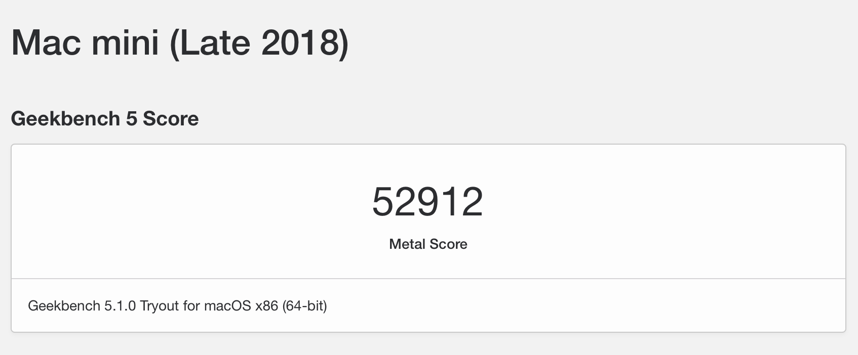

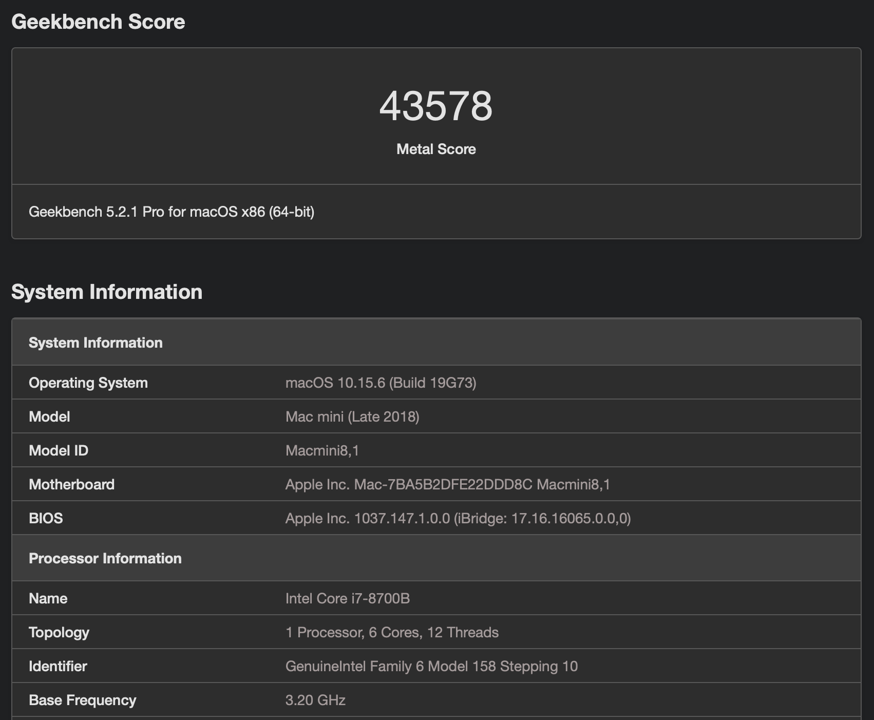

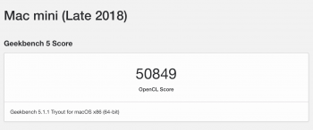

What score are you getting. I get this with my 2018 500GB 16Ram and using a Vega 56 eGPU.
Screen Shot 2020-07-15 at 5.27.50 PM.pngScreen Shot 2020-07-15 at 5.28.07 PM.png
IIRC Apple have pretty much abandoned OpenCL so it's probably not a terribly useful benchmark.

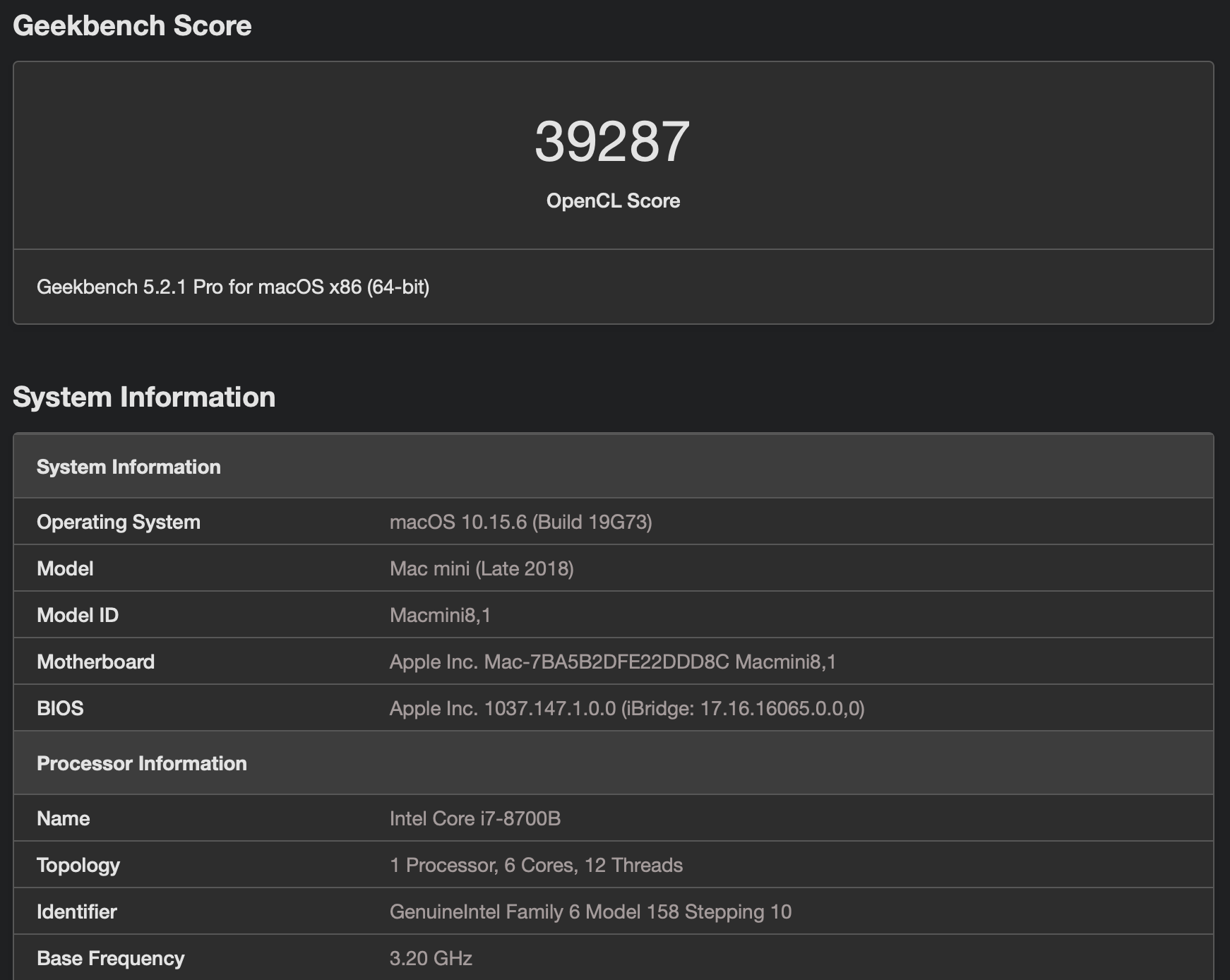

Are you using an external monitor with the eGPU?
My mini is connected to my LG 27UD58 with a TB3-DP cable. My eGPU is connected only to my mini's TB3 port. That's the only way I've been able to get things to work reliably (after months of trying different setups). So the eGPU is there just for the added graphics horsepower.
