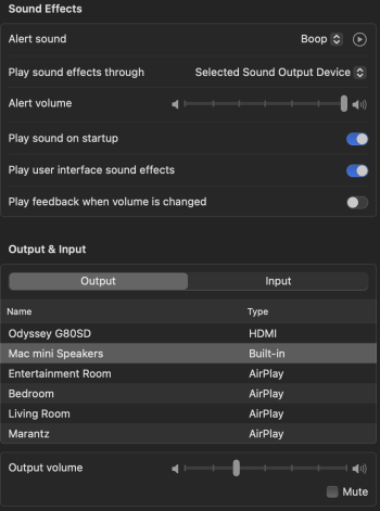

Here's a screenshot of what it looks like in the Sound settings.
The headphones is completely missing.
I went down down the list and did everything that was suggested, i.e. launch Garage band, unplug and plug the headphones, I even got a new headphone cord.
Still the headphone output is missing when I wake up the computer from Sleep Mode.
I hear a loud click in the speakers while it's sleeping and then when I launch the computer it's missing.
Only thing that fixes it is to reboot the computer.
Maybe it's a coincidence but this wasn't happening before 15.5.
Here's that screenshot, the Odyssey reference is the monitor:

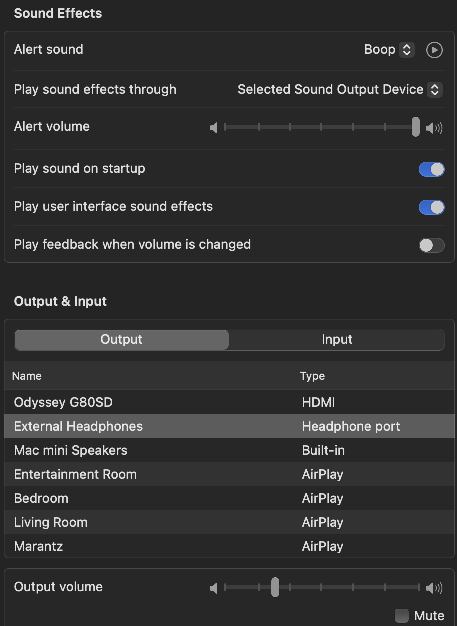

Just now had to reboot it in order to get the headphone output to show up and work, sure enough after the reboot it appears and works like it should.
