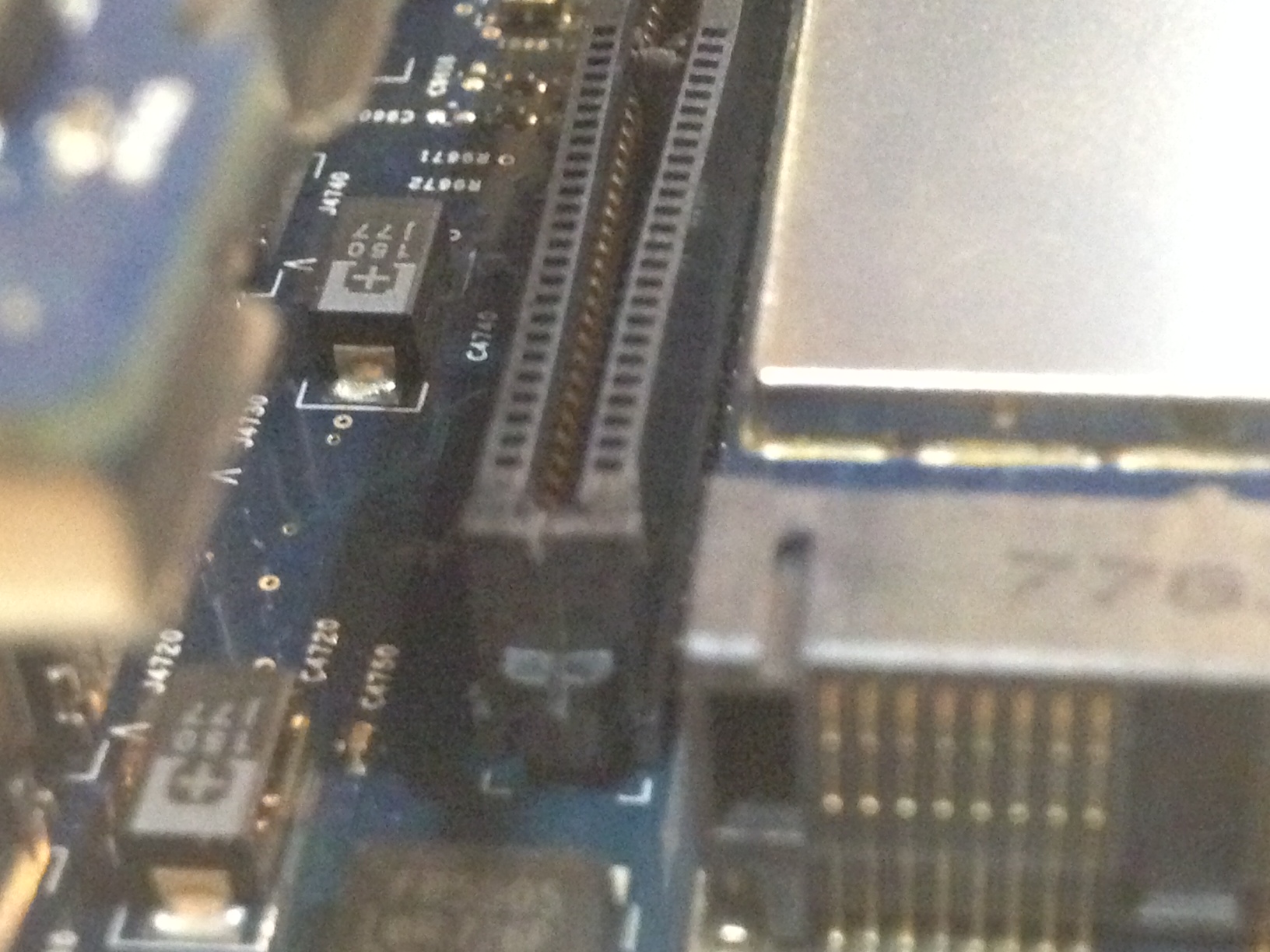

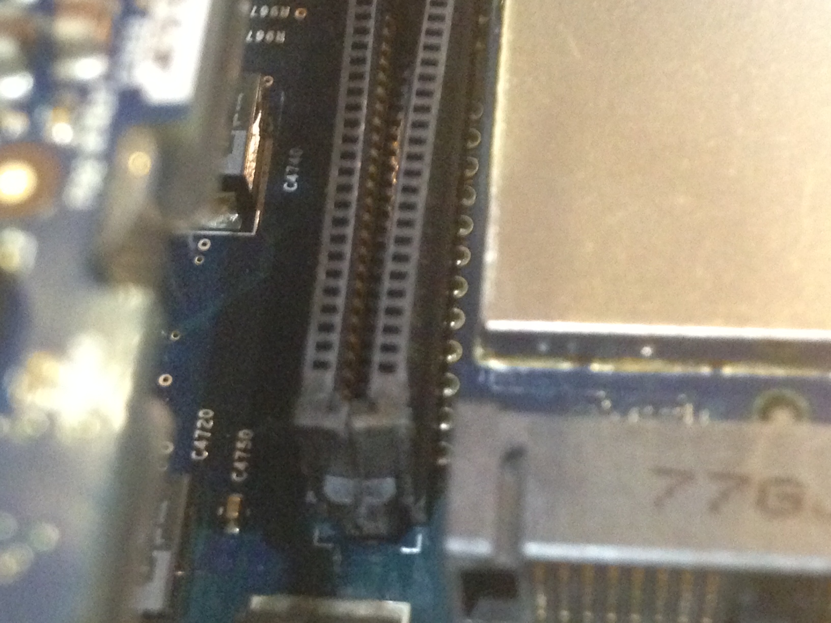

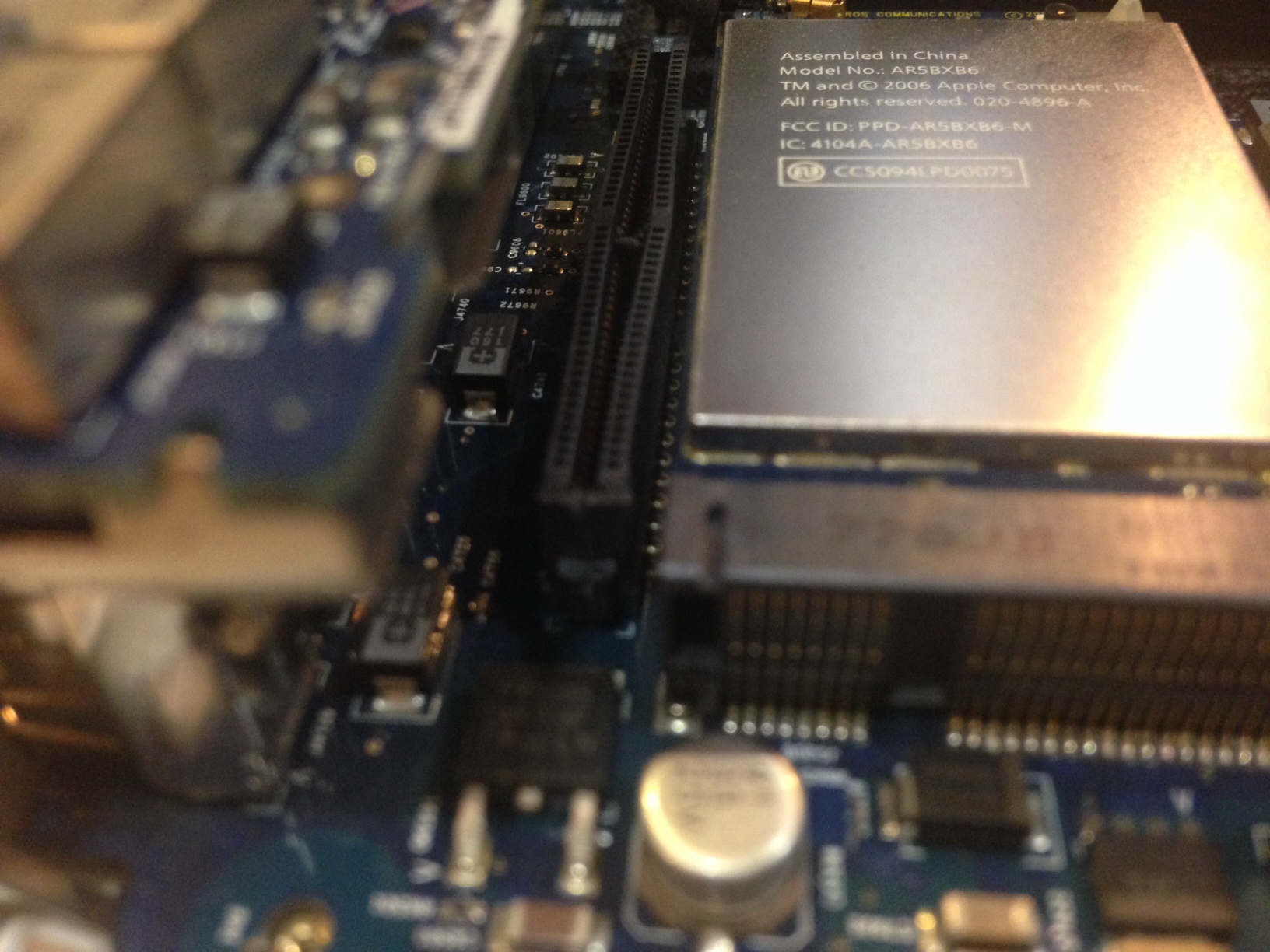

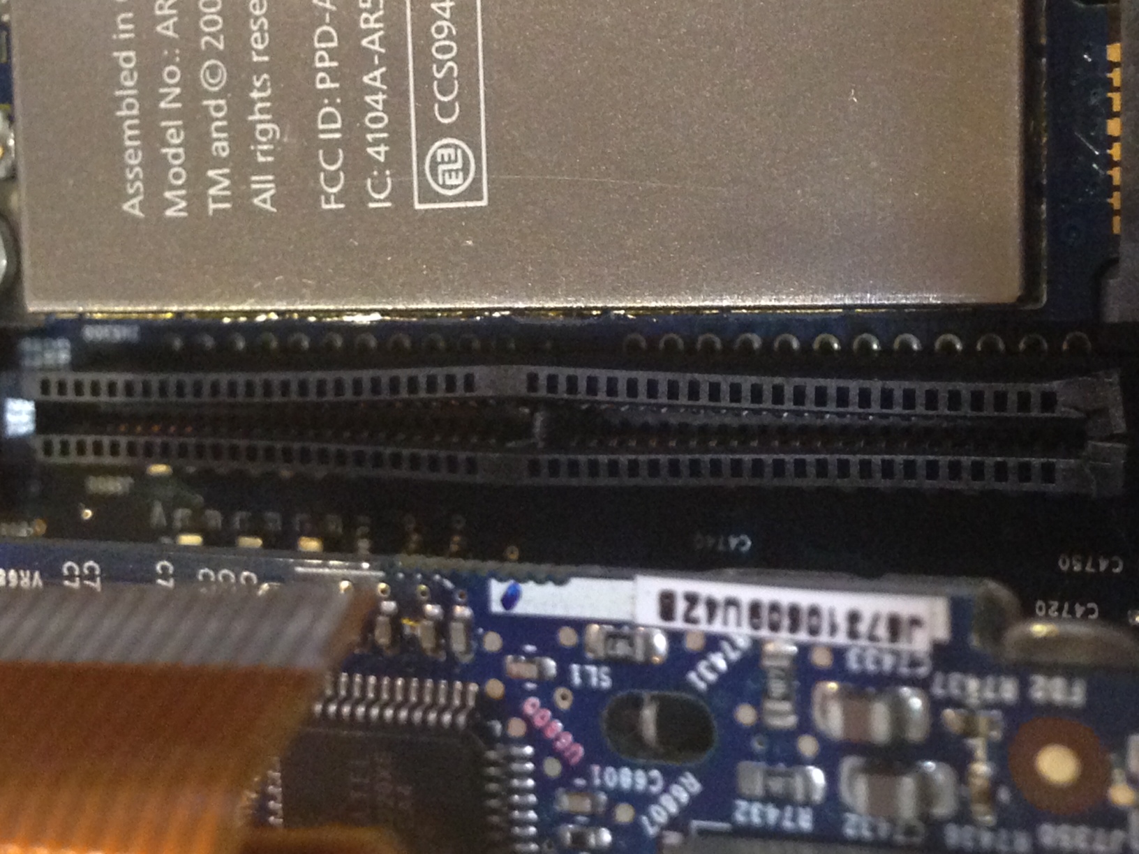

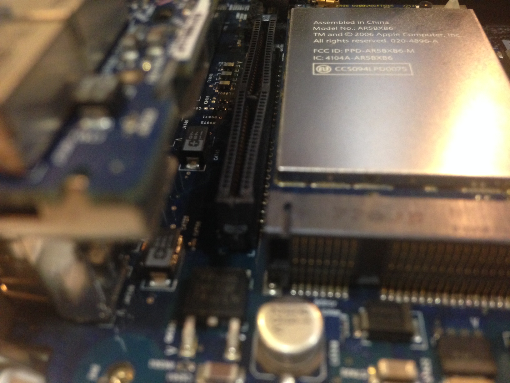

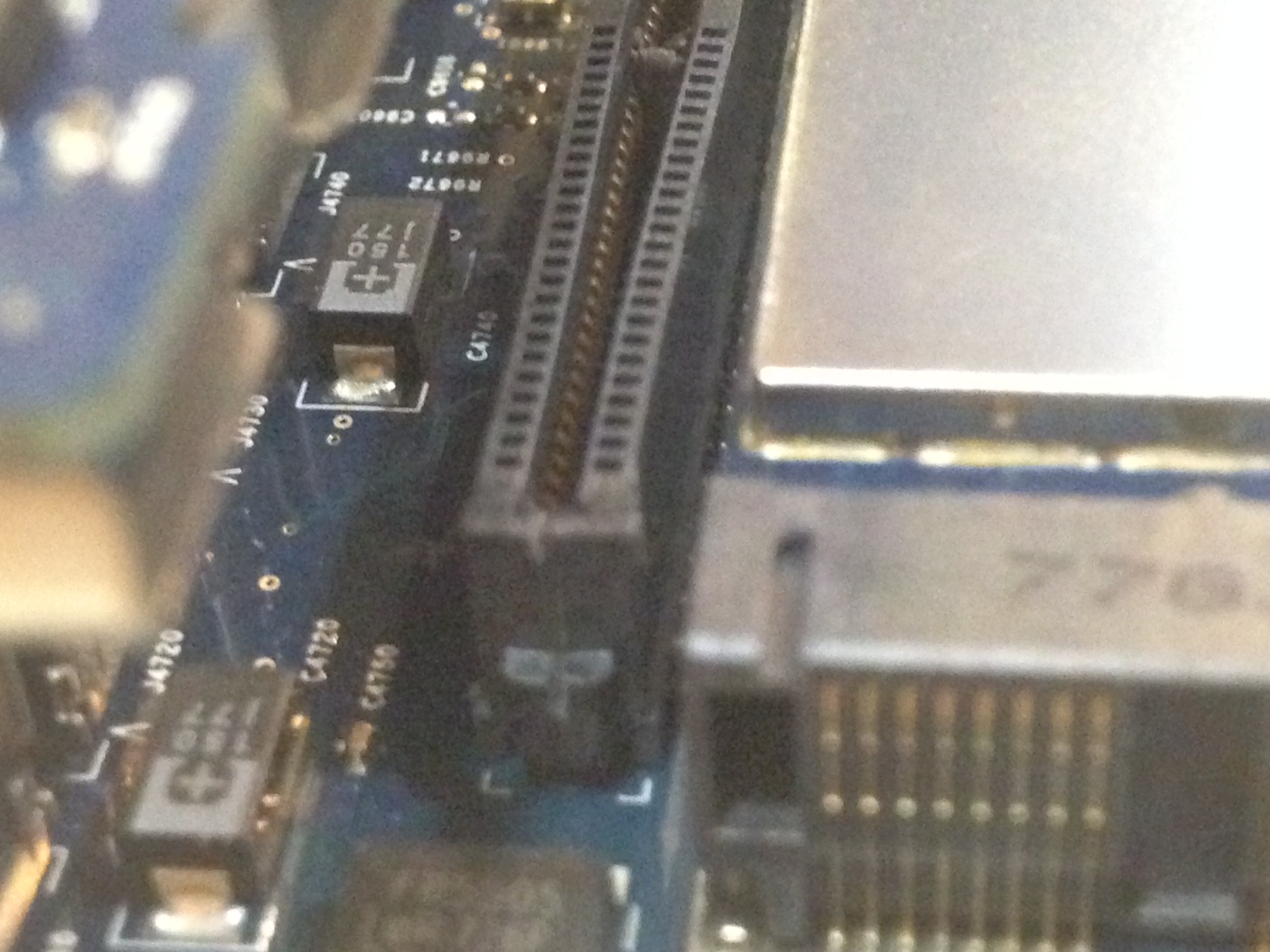

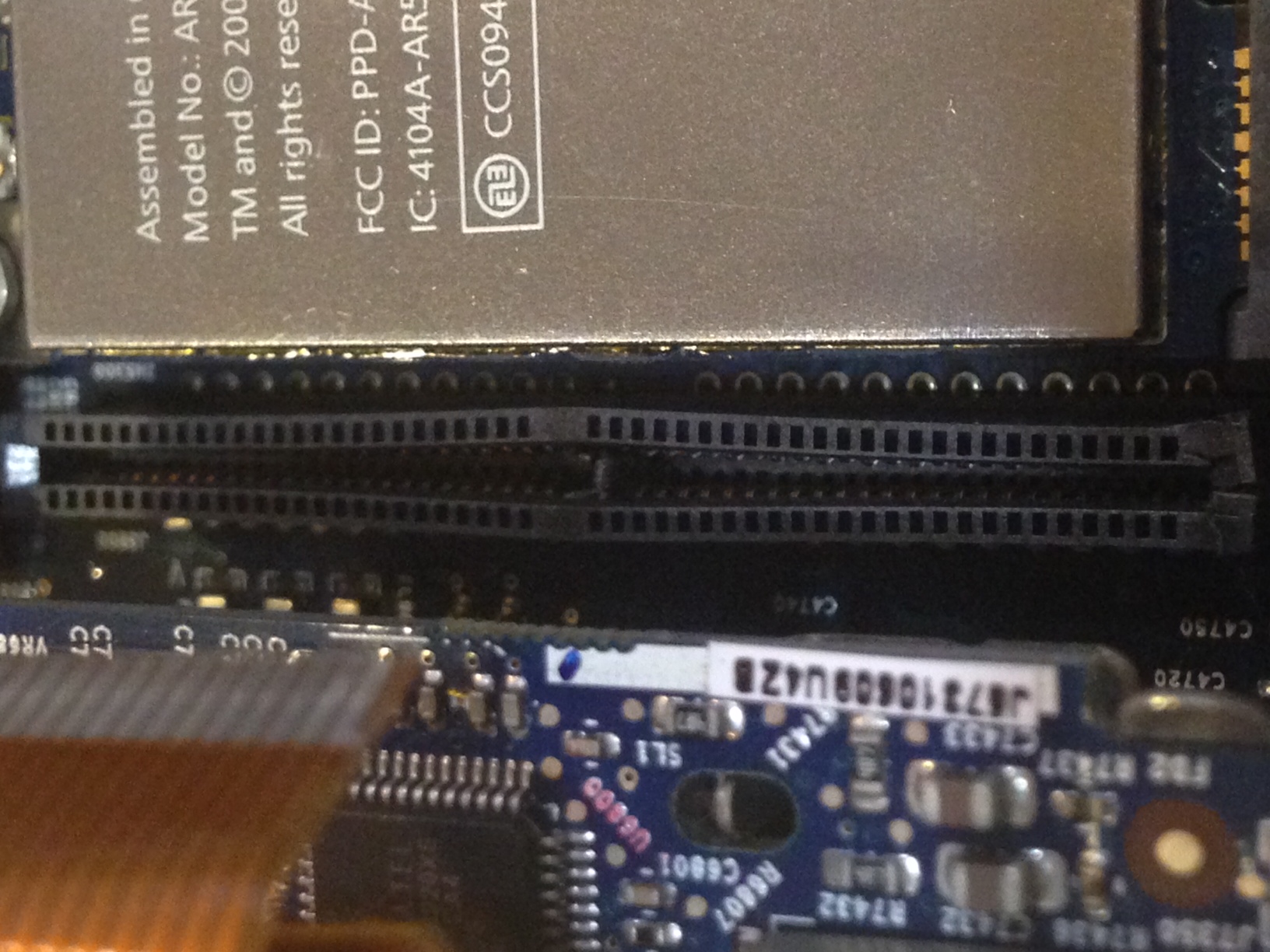

Here are the pictures of what I'm dealing with; I find it a little difficult to believe that this would have occurred from a drop.
I was thinking that I *might* be able to superglue the end cap piece back together, but no idea what to do with that bulge in the center.
Thoughts?
Thanks!

That's one heck of a drop! Almost looks like the slot was pried upon.
The drop wasn't really that far; I'd say max 5 feet (as I was carrying it and dropped it) onto a carpeted floor. I think it hit one of the corners, but there's no cosmetic damage to the case itself.
That's really unfortunate that it broke like that.
That's most bizarre.
I'm not familiar with the innards of a C2D Mini and can't visualise the space available to you, but might it be possible to fabricate a clamp running over the RAM chip to hold it all together?

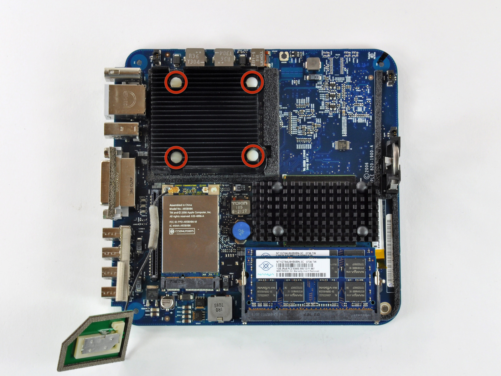

Here's a pretty HQ image (from iFixIt) that shows the layout of the board; in the picture the slot that's damaged is partially hidden by the airport card's wire on the bottom left.

What exactly was it that caused the physical damage to the slot during the fall? What made contact with it and damaged it in an outward direction from the center?
No idea. The computer was in it's fully assembled form when it fell out of my hands onto the carpet. The more I think about it, the more it could be that the machine was already damaged and the fall just brought it to my attention.
Tomorrow I'm going to try to superglue the one end back together (since I don't really have any other options with this board) and see what happens.
Are you the original owner of it?
