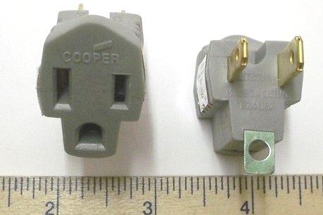

I just bought a Mac Mini a few weeks ago, and I'm using it with an IOGear KVM switch. About a week ago I got a new Dell monitor. As soon as I swapped in the new monitor, the Mac became fussy and often wouldn't power on. Unplugging and replugging the Mac's power cord always seemed to fix the problem.
The old monitor had a two-prong transformer; the new one has a regular 3-prong IEC power connector. So, I thought maybe the new monitor introduced a ground loop. So I tried adding a ground lift (three prong adapter, photo below) to the Mac's power cord, and problem solved!
So if your Mac Mini won't power on, try lifting its ground.
