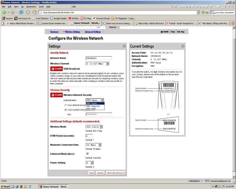

Thanks for all of the replies, but I'm still not connecting 🙁 I'll try to attach a screen of what my router's setting page looks like.
You won't be able to connect using WEP until you locate your WEP key. Apparently you have a default key printed on the bottom of your router. Try that -- and set the WEP encryption on default.

Only one WEP key will work, the hex equivalent of the plain text password you set. It might be time to ask tech support of the router manufacturer how you discover this string.
Well the default key is a 10 digit number from the bottom of the router. I've tried converting it, and other plain text keys to hex and nothing is working. 😡
