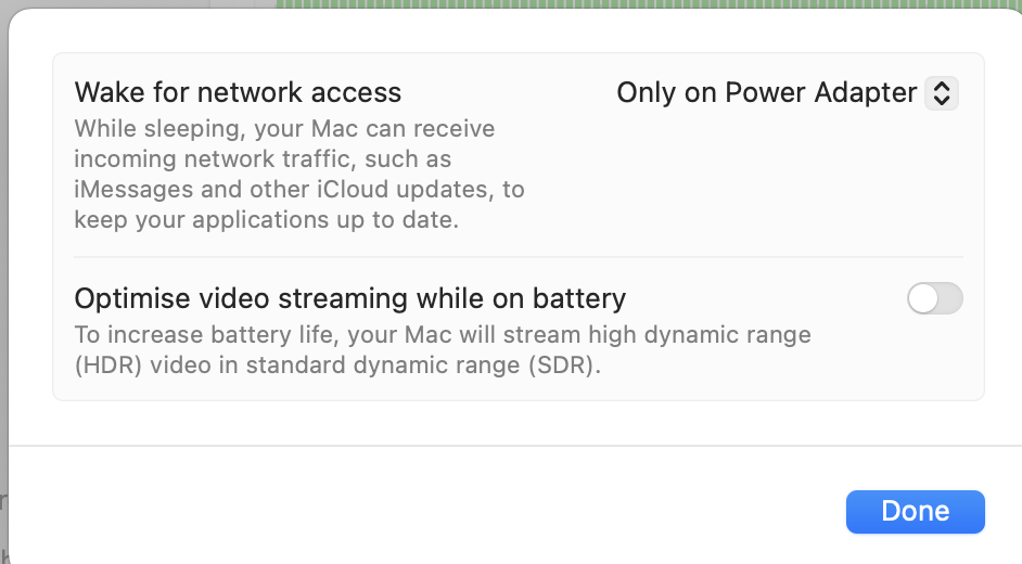

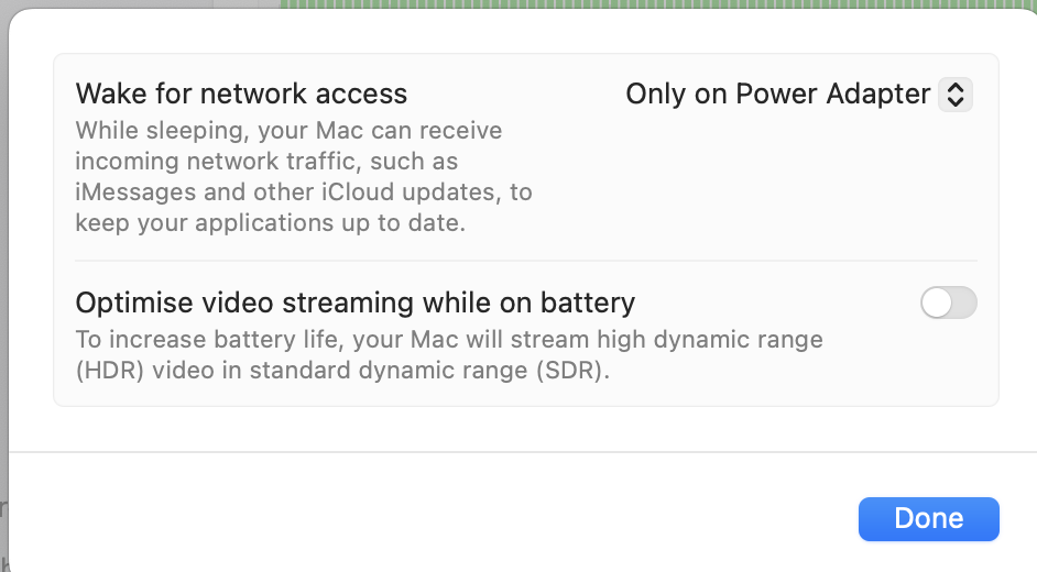

How are your Network Access configurations looking like? I'm using:
