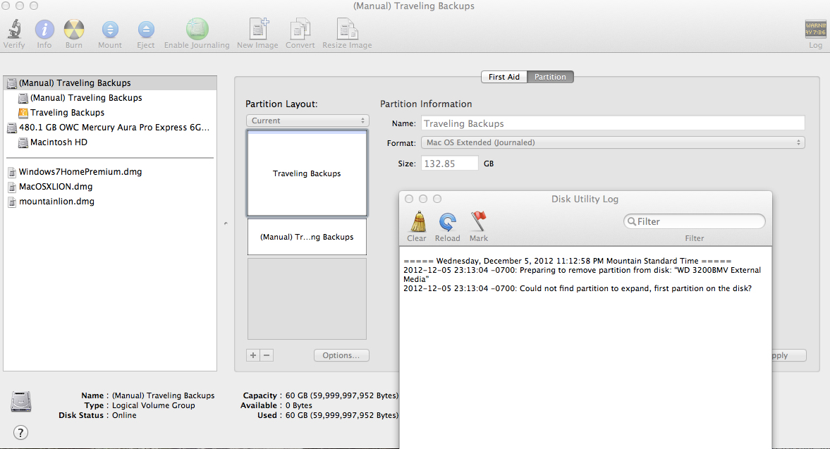

Hi everyone,
Sorry to reopen this, but I've been having issues reformatting my external hard drive for several days. Everything I have found has been related to fixing the drive that Mac is installed on, which is not what my issue is.
The story:
I had this external hard drive that I was occasionally making Time Machine back-ups to. Then I did the following and screwed it up...
  • created a second partition on the device
  • used Time Machine to encrypt the first and second partitions
  • (this then created what appered to be two separate devices in the list; obviously not the case)
  • Tried to delete the second partition that I made to go back to what I originally had
Now I have this mess (see attached picture.)
At this point there is zero data on any of the partitions. I've "erased" each partition several times and tried reformatting them to different types of systems (Mac, ExFAT, etc.) But overall... I cannot merge them to start over for the life of me.
If I click the top level device, the ONLY two tabs that are listed are "First Aid" and "Partition"
When I click on the "Partition" tab, the button below that says "Options" is grayed out and I cannot click it. The only thing that is available is the "minus" sign for only ONE of the partitions (the first one.) And when I click it, the pictured error is what I get.
LONG STORY SHORT....
I THINK if I am able to reformat the MBR on the external hard-drive, that it will fix it enough to the point where I can delete partitions. I'm just struggling to figure out how to redo the MBR. ADDITIONALLY: when I click on the device, the info at the bottom doesn't even list "Partition Map Scheme" which leads me to believe it's really messed up.
Can anyone help?
I'm using Mac 10.8.2 if it helps. Thanks!
