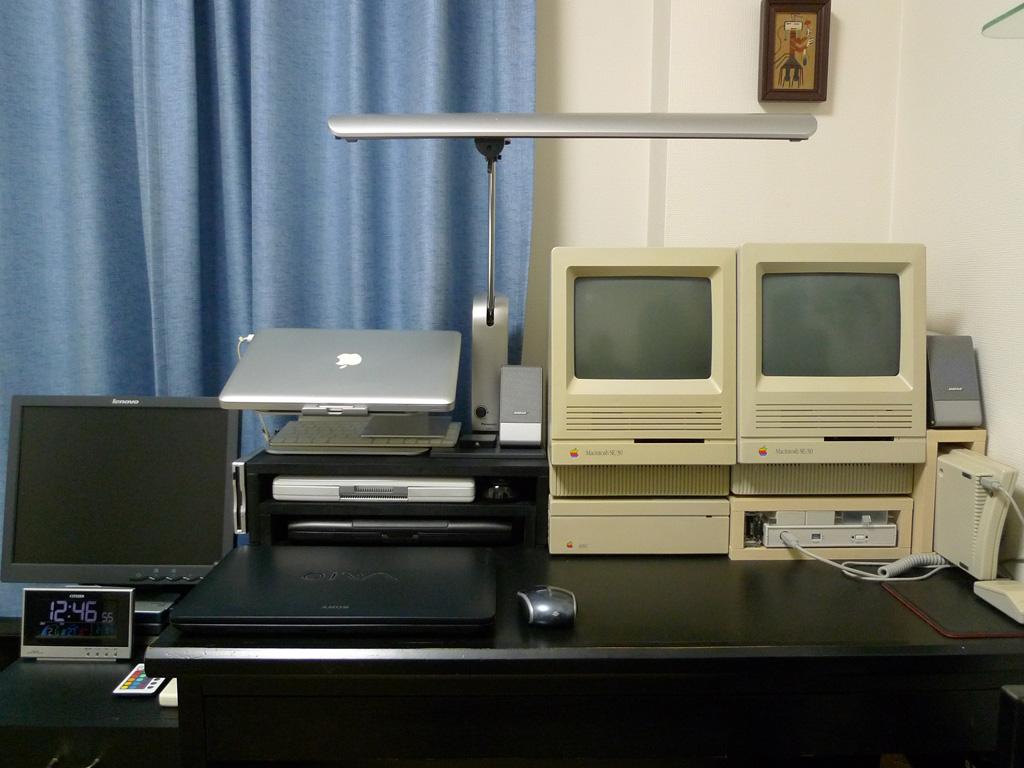

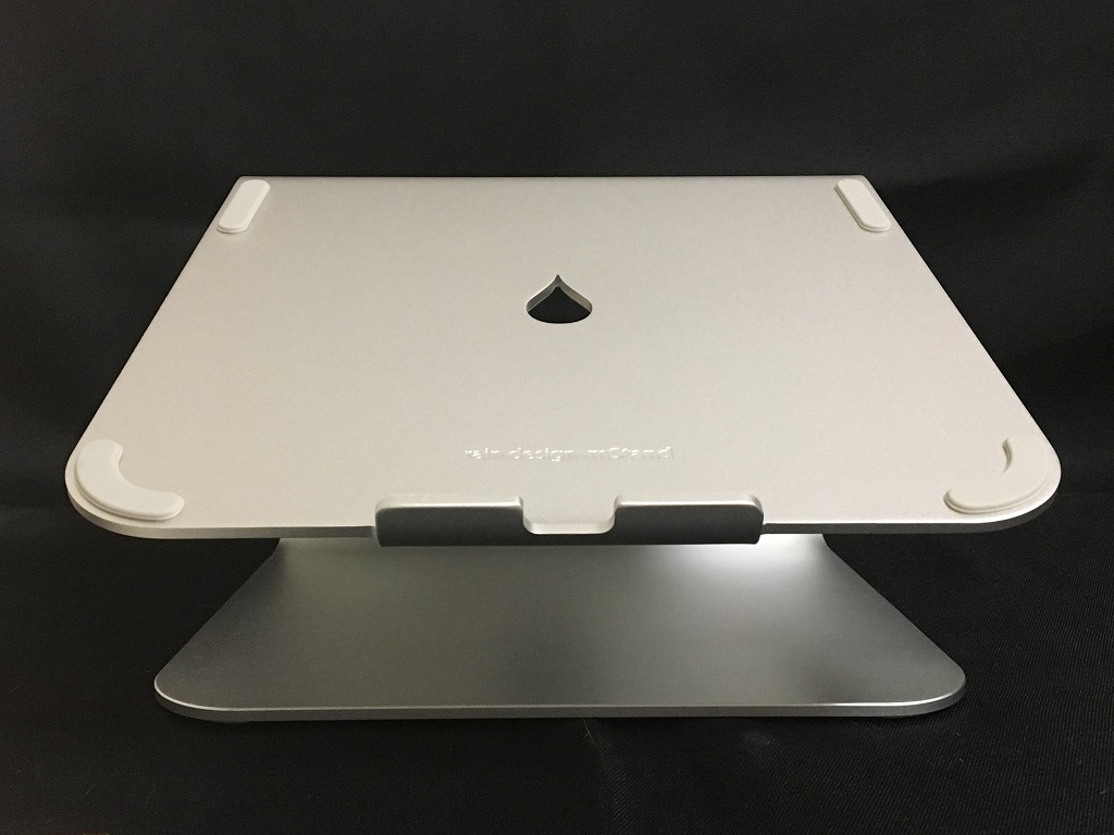

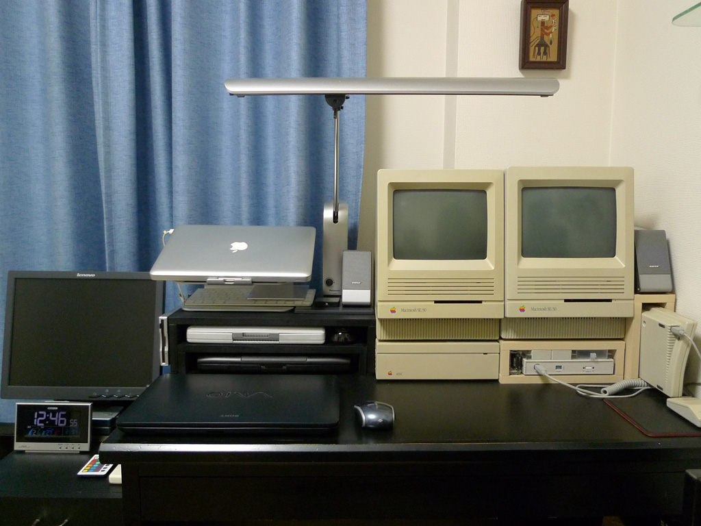

Yes, I used "a PC table with fans" a long time ago.

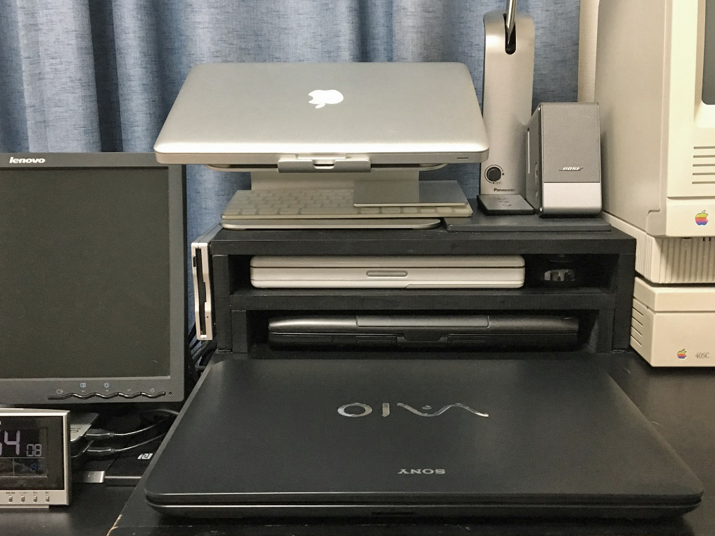

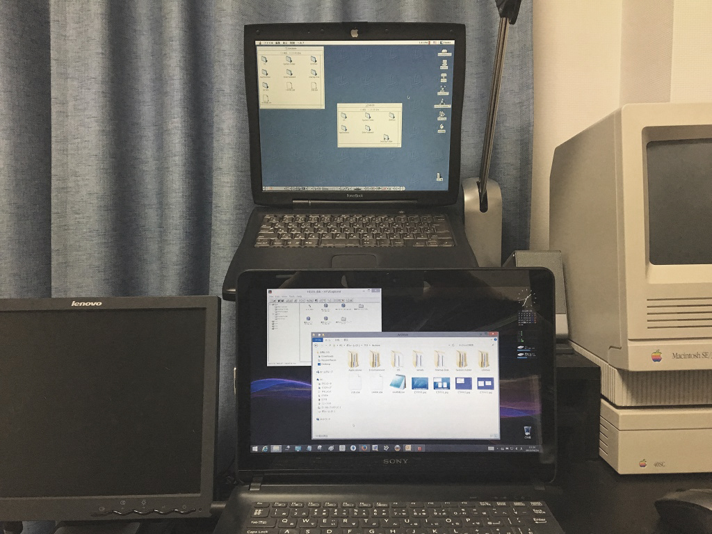

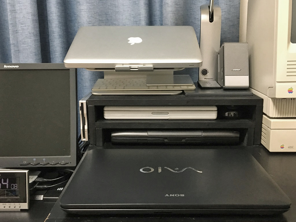

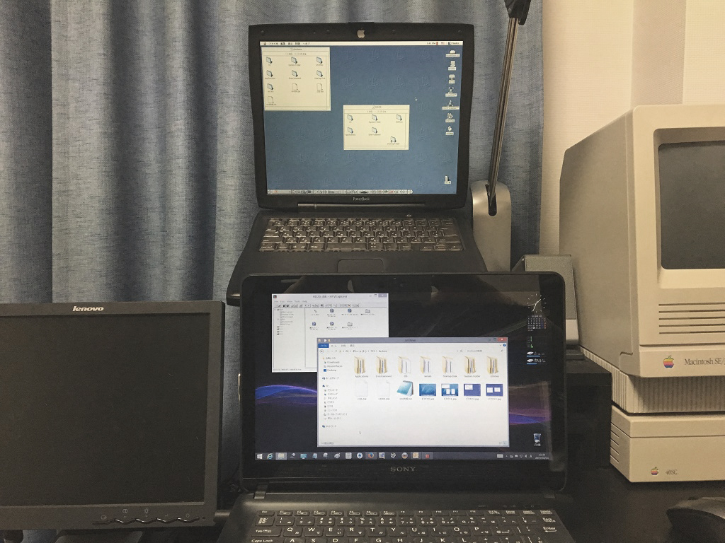

Here is the current working environment
There is crowded on my narrow desk.
I have 3 Books include Pismo.

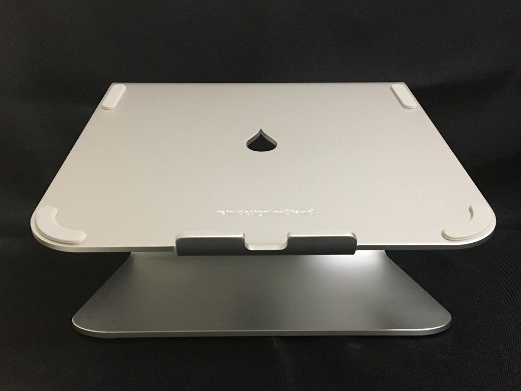

"Rain Design mStand 360" is a stand for MacBook Late 2008.
But sometimes I use Pismo on the stand.

I am very fond of this highly efficient desk space.
Thank you for your interest.
SE/30 --- kanjitalk 6.0.7 - Mac OS 8.1
PowerBook G3 Pismo/iBook G3 16 VRAM --- Mac OS 9.0 - Mac OS X 10.4
MacBook Late 2008 --- Mac OS X 10.4 - OSX 10.11
Only missing Mac OS 8.6(8.5).
That's why this forum is important.

My desk is larger but less space-efficient in how I use it. The way you have arranged everything on yours is motivating me to re-think my own desk’s ergonomics.

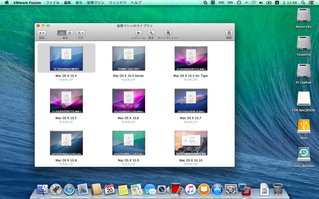

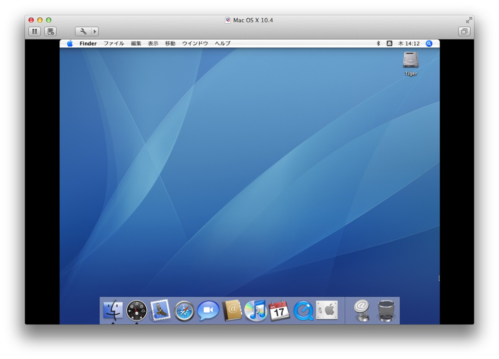

Are you really running 10.4 (Tiger) on an Aluminum MacBook? I ask because I tried Tiger on a 2009 Mac mini which is very similar in terms of hardware and didn't get very far at all.

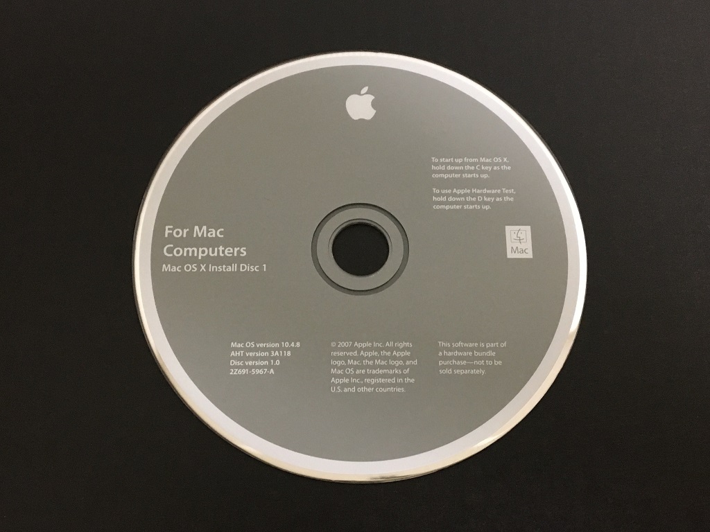

With a help of VMware Fusion 6 on Mavericks.
This is a Library of Mac OS X 10.4 - Mac OS X 10.10.
And a help of Mac OS X Install Disc 1
2Z691-5967-A (version 10.4.8)
Sorry, I will skip the details because it deviates from this thread.

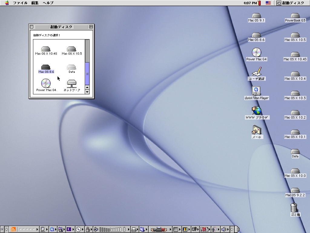

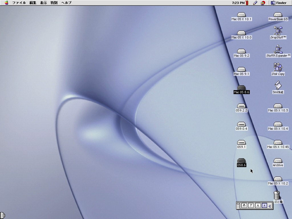

I replaced the internal HDD.
I partitioned the external HDD (USB-IDE-CF) into 4 volumes, "OS8.6","OS9.0.4","OS9.1" and "OS9.2.2".
Booting from the internal HDD:
Only "Mac OS 8.6", the power goes off after its icon parade.
Booting from the external HDD:
Only "OS8.6", there appears a "?" disk icon.
Why it's just Mac OS 8.6?

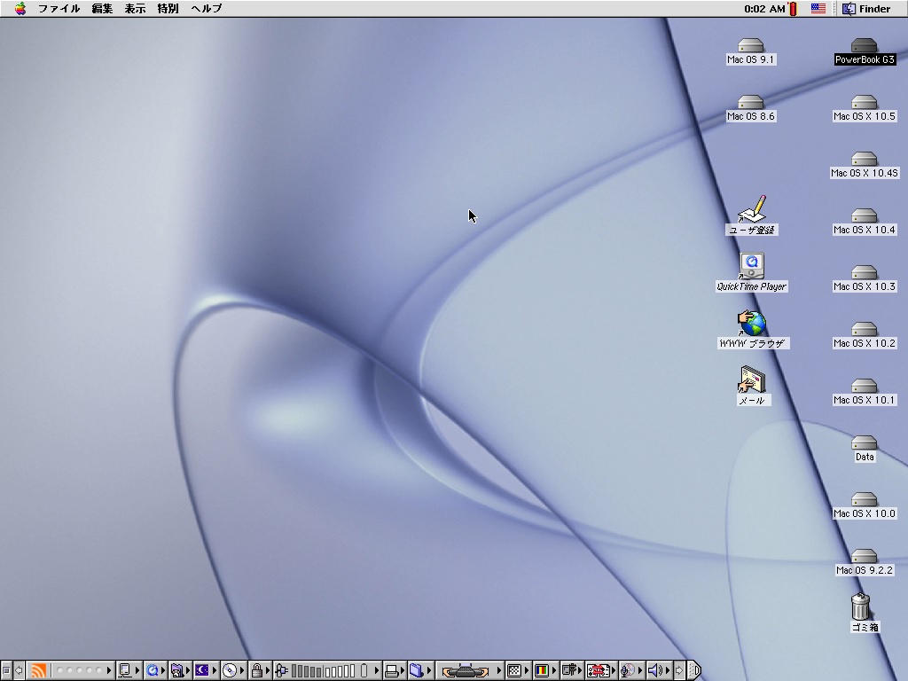

I tried "Mac OS 8.6 - Mac OS X 10.5 on Pismo G4/500MHz" again.
I read an article that some Toshiba HDD may have a problem of firmware and can't recognize the "master" configration.
Moreover, there seems to be a "limitation" that the boot volume must be within 72GB of the storage.
So, I changed Toshiba MK-1234GAX (120GB) with WD WD1200BEVE (120GB).
And repartitioned the HDD so that all 11 boot volumes within 64GB.
1: PowerBook G3 (Mac OS 9.0.4)
2: Mac OS 9.1
3: Mac OS 9.2.2
4: Mac OS X 10.0
5: Mac OS X 10.1
6: Mac OS X 10.2
7: Mac OS X 10.3
8: Mac OS X 10.4
9: Mac OS X 10.4S (Mac OS X 10.4 Tiger Server)
10: Mac OS X 10.5
11: Mac OS 8.6
12: Data

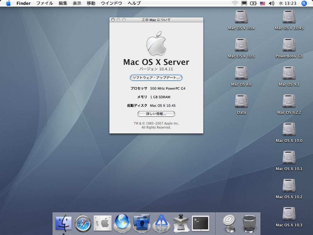

Mac OS X 10.4 Tiger Server:
It worked well by using the modified Install Disc. (without OF)🙂

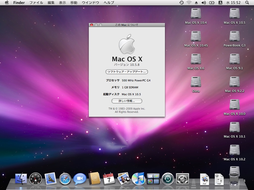

Mac OS X 10.5 Leopard:
It also worked well by using the modified Install Disc. (without OF) 🙂
Mac OS 8.6:
I installed OS image from "Power Mac G4" Software Restore CD and modified its Mac OS ROM as "Compatible".
And selected "Mac OS 8.6" as a startup disk.

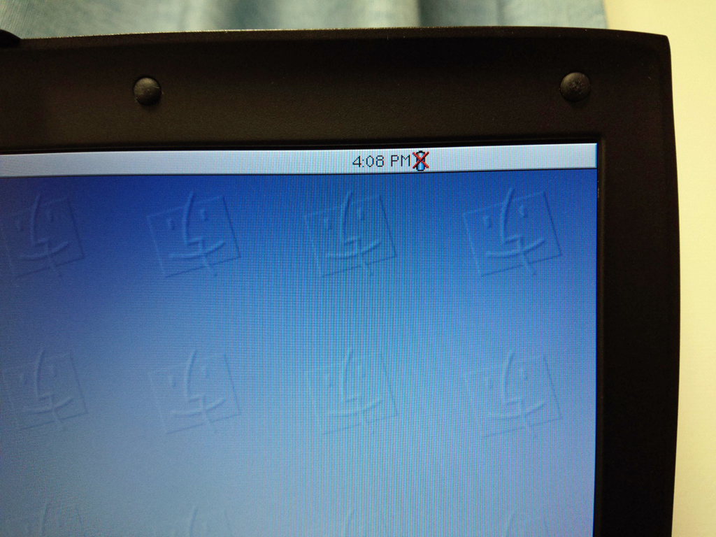

But, Pismo is powered off at the end of icon parade. --- again 🙁
I can see a battery icon with "x" mark at the moment the screen disappears.
The "date and time" is reset after reboot.
That should never happen normally if the battery and/or PRAM battery is normal.
Why only Mac OS 8.6 doesn't work?
Why does the power go down? 😵
