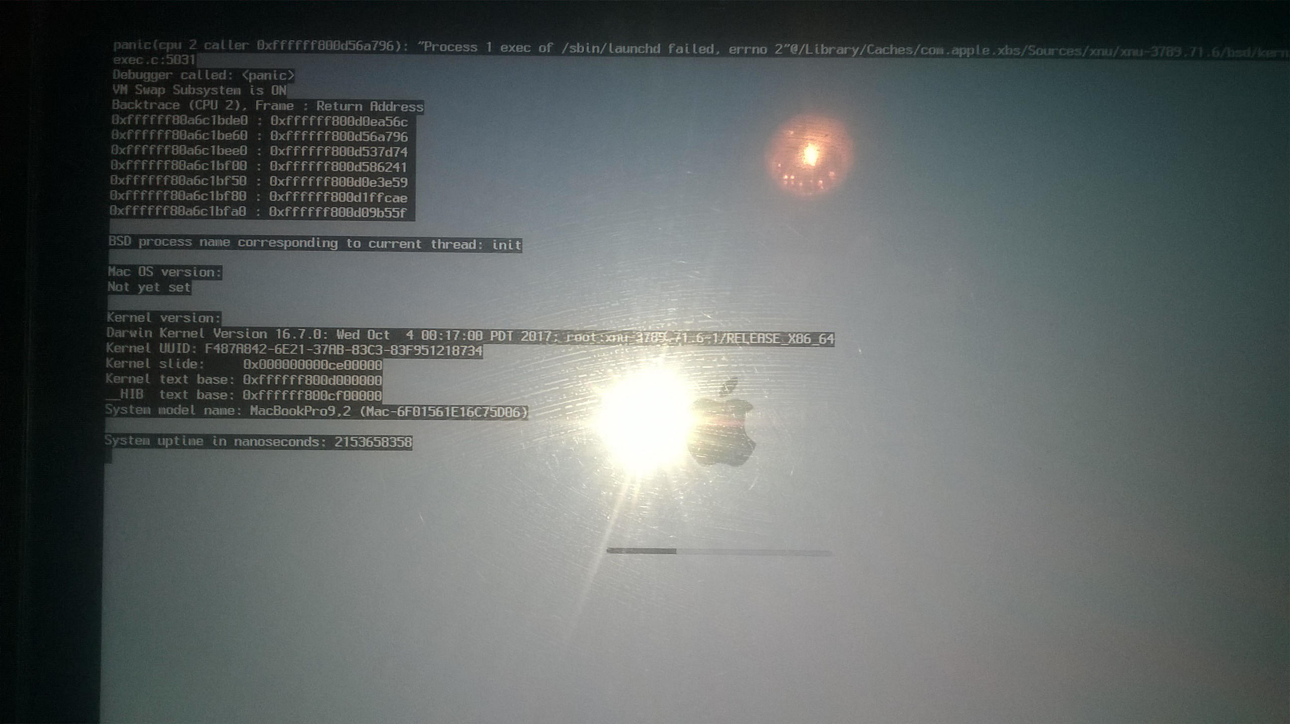

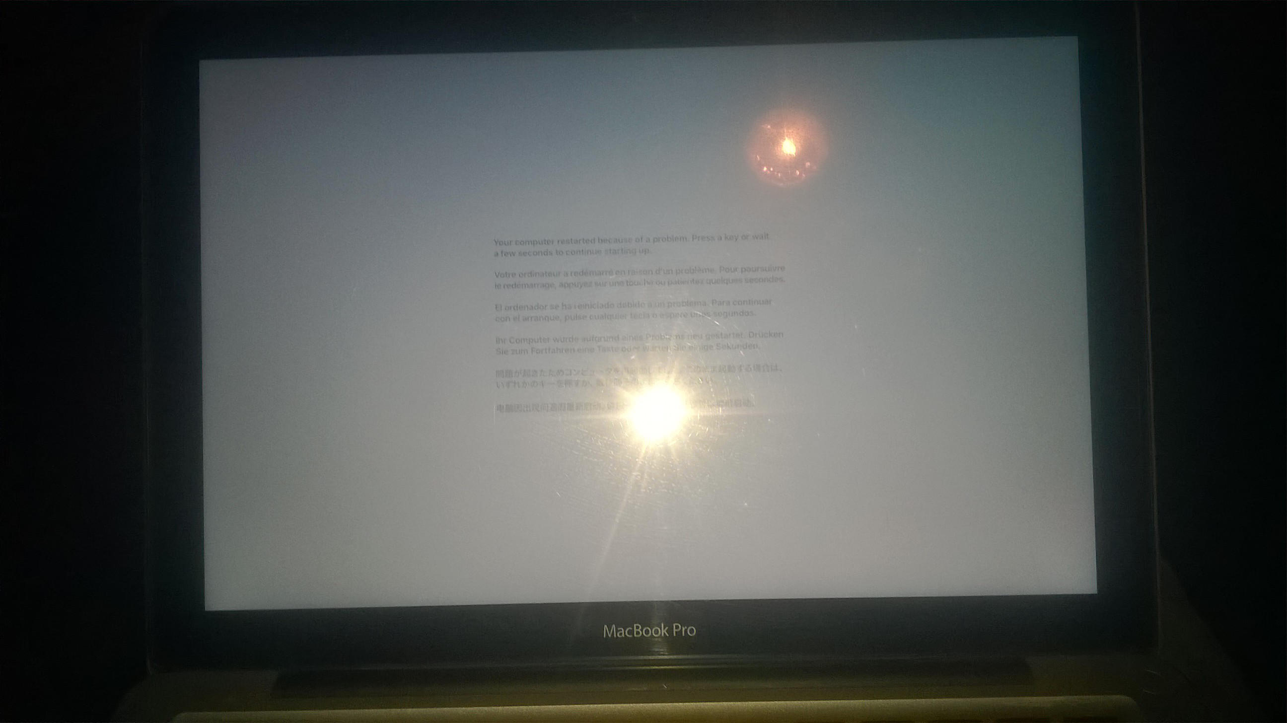

Tried to install update but now my MacBook cycles through these two screenshots (when I press enter) until eventually showing a grey no entry sign. Can't log in 🙁
Has anyone got a solution from viewing the screen shots?

That is a classic kernel panic, and a bit of googling on the backtrace words finds the same but doesn't find any clear cut cause. This was prob the most relevant.

Thinking some more there is a possibility that the problem is the hard disk is beginning to fail. If this the case the priority should be to try and copy your data off it as quickly as possible before trying to repair it....unless you already have a recent backup? The advice in the link I gave is sound. You need to boot from another external volume (drive or USB stick) and copy data from your internal to another external.
If you don't have a backup already, and the data is important, I would actually recommend going to a Mac Repair shop and letting them look at it. They will already have bootable externals to enable recovering data off your drive. There are risks with me or others advising what to do from afar without being able see the whole picture, and there are dangers that the advice might make things worse, eg trying to repair the disk if it is actually failing.
If you do have a solid backup, then you can go ahead and run Disk Utility from the Recovery Partition as described here. That link is a bit old but still relevant. Having a trustworthy backup (or two) is a huge peace of mind factor when things go wrong and you have to do things outside your comfort zone! If it all goes pear-shaped you can start all over.
