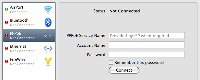

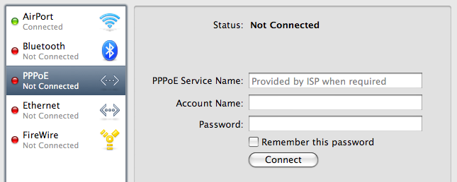

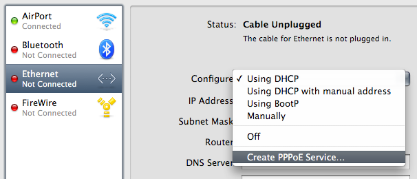

you can add PPPoE in Network preferences for Ethernet in the configure menu.
It is added already and in my network it is used only for internet connection.
And in my network it isn't required to add pppoe to access local resources. Local resources are accessible throught dhcp routes.
