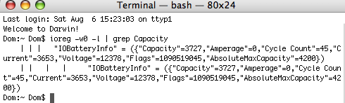

In Terminal, paste the following
ioreg -w0 -l | grep Capacity
And you'll get back something like this
| | | "IOBatteryInfo" = ({"Capacity"=3727,"Amperage"=0,"Cycle Count"=45,"Current"=3654,"Voltage"=12380,"Flags"=1090519045,"AbsoluteMaxCapacity"=4200})
