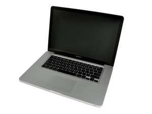

I have a 2010 MBP running Sierra (10.12.6). I can't upgrade the OS any more as it's not supported. I am really trying to get another year or two out of this machine. So the problem is this thing crashes constantly. Sometimes 2-3 times in an hour. Sometime I can go 2 days without crashes. I have tried everything. I have a ton of hard drive space, and I have all the bells and whistles turned off. Done the pram and all that. Fun first aid etc. It usually happens when I'm in Photoshop and have to zoom in on something, or when I'm in Safari (sometimes but not always when viewing an enlarged image). There are no software updates available and haven't been for a while. Any suggestions on how to fix this problem? If I could just prevent this machine from crashing I know I could get a couple more years out of it!

If you have a 15", it's probably crashing due to some hardware issues involving the graphics card, but without seeing logs and without having details of your computer it's difficult to be sure.

Interesting, thanks. Yes, it's the 15". I think you're onto something with the graphics card, I'll try to grab the log next time it happens. I didn't realize it supported High Sierra 10.13.6, I wonder if that might fix the issue or if it would be worth doing.

If your problem is GPU related, then no. There's at least one very long thread about it on this forum so I suggest doing some searching.

Hey guys, thanks so much for taking the time to respond to this thread and help me out. @tomcatrr - I did install the MBPMid2010_GPUFix back on 12/15 and I have not had one crash since. Friggin sweet! I think I need to do a couple more photoshop jobs to be 100% sure, but I have done a few jobs with no crashes and also no safari crashes either. So this is really great, thanks again!
Update: 1 month and no crashes. Sweeeeeet!! :):):)
