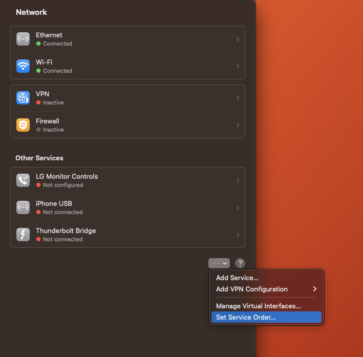

You may want to try making Ethernet the first connection option, and WiFi the second. You can do that in the Network tab in System Settings using the little drop-down menu at the bottom right.
I don't know why you can't connect to the Internet using WiFi only. That's a whole issue in itself that's difficult to diagnose.

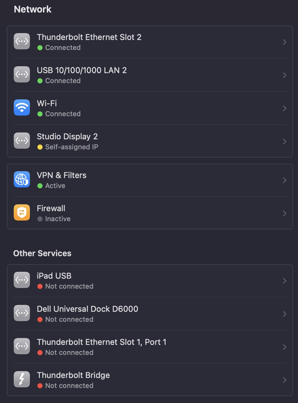

I have two Ethernet and one wifi connected, no problem.
The first is a Caldigit TS3+ hub connected to a Thunderbolt port, the second is a Maxonar Ethernet-to-USB-C-adapter, connected the same way.
