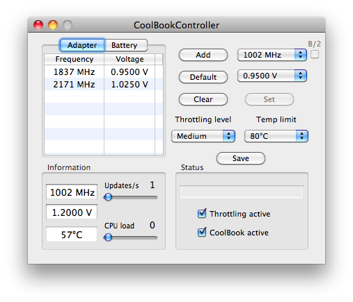

2.17 didnt work for me.... i'm having the exact same issues as in v2.16 also.... I can add freq and voltage etc to the list... but the information area always show only 1 frequency at its unmodified voltage (1200Mhz @ 0.9375V)... that number never changes to show any signs of throttling.. anyone else having same issues?

The same with CoolBook 2.17 on Mac OS X 10.6.3. Everything seems to work, kextstat | grep cool outputs se.coolbook.driver2 (2.1.0) <4 3 1>, but controller shows maximum processor voltage:
