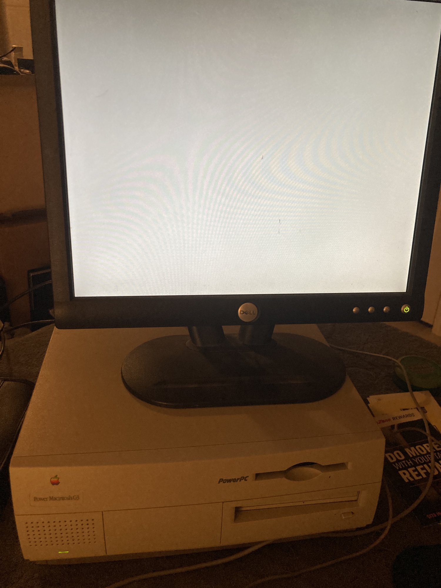

So I’ve hooked up my beige desktop, and it happily booted into 9.2.2 as it should. I plop in the DP2 CD, open the installer and no errors this time. I click continue, it reboots and is seemingly hung on a grey screen.
The same thing happens after booting the CD (which starts up to 9.0) and choosing to install from there.
Perhaps someone who’s dealt with this before knows what could be wrong?
The G3 has a couple minor upgrades. An ATI Rage 128, 384MB RAM, and two hard drives a 40GB and the original 4GB one.
Reactions: lepidotós
I think that happened to me, but I honestly can't remember -- it's 1 in the morning. It was a bad burn, if it did -- I burned another disc and it worked fine.​
