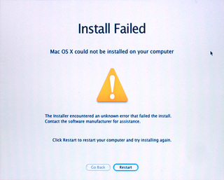

I downloaded the installer from AppStore, and run it. After some time i got the error message:
1. I tried to re-install the OS but it failed every time.
2. I tried to repair the HDD via Disk Utility but it failed as well.
3. I tried to boot up in recovery mode but it went straight to the installer window prompting me to install the OS.
I'm basically stuck in some kind of loop here.
I'm not even able to skip the installer window and boot the machine to backup my files.
Is my HDD in a bad shape?!..and most importantly, will I be able to backup my files!?

Are you sure that's Mavericks (10.9)? It looks like Snow Leopard (10.6) - here's why: the buttons are rounded, not square, and Mavericks no longer calls OS X "Mac OS X" - only "OS X".
Yes, the MBP came with Lion. I updated to Mavericks when it was released.
Just to be clear, the photo above is not actually mine..but that's the exact same error message I got!
Thnx for the concern! Appreciate it!
