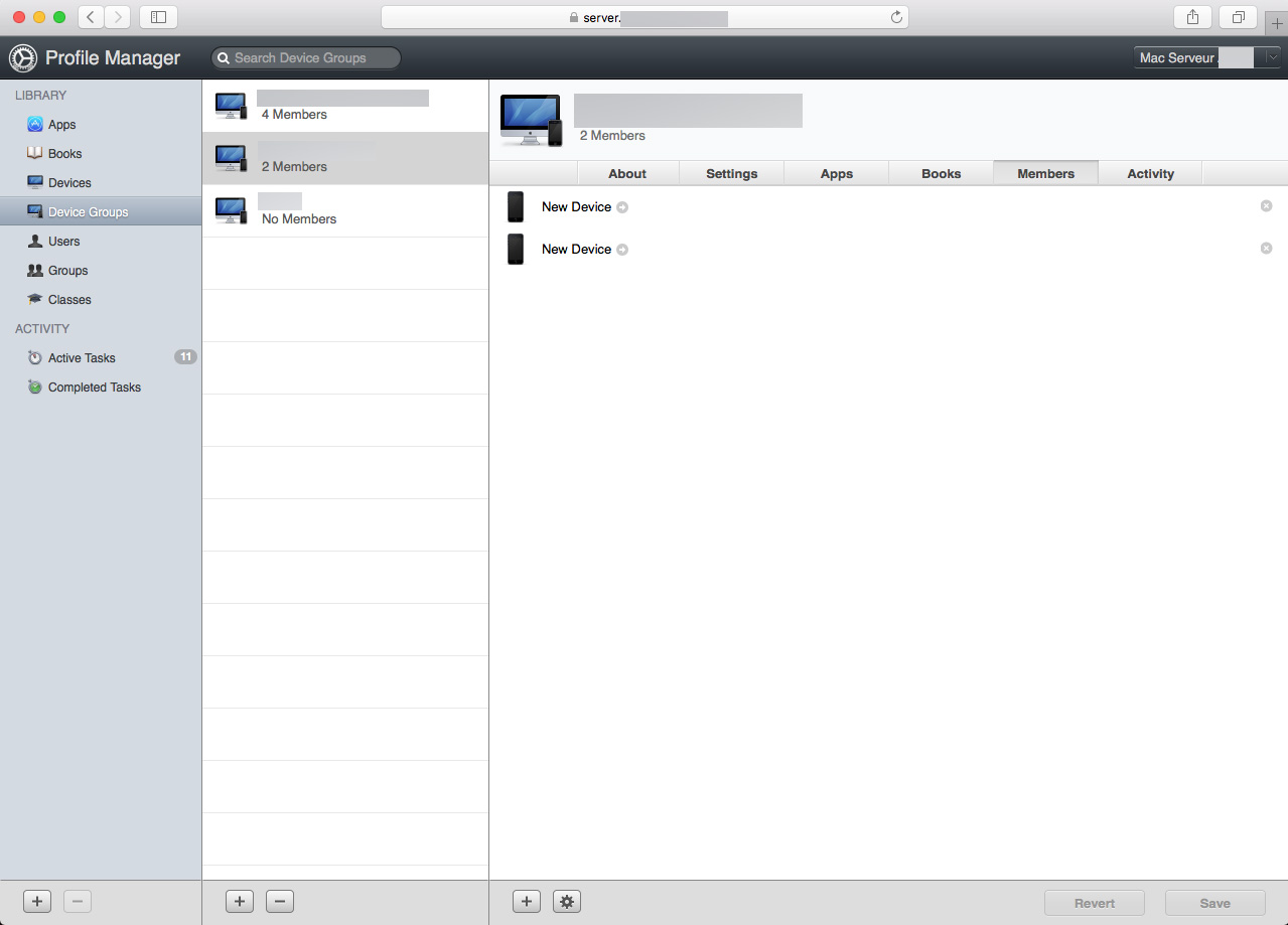

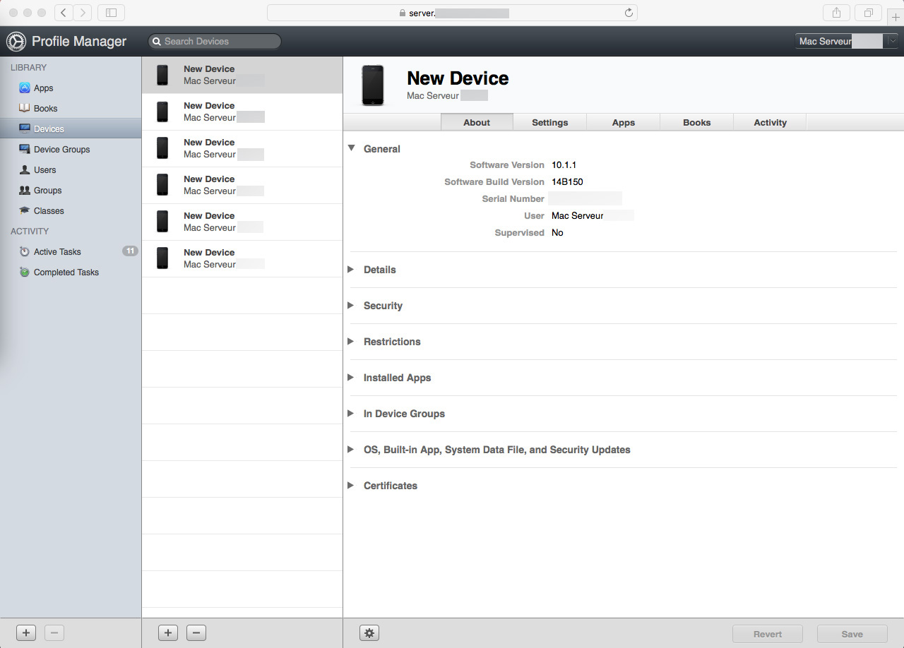

I installed a Mac Mini under Sierra OS X server 5.2 and I encountered a weird issue.
Here it is; when I enrolled several iPhones (already having their own names such as iPhone 1, iPhone 2 etc...), everything was OK (security certificates wise), however in Profile Management under Safari, they are all named "New Device" as you can see in the attached file - screenshots (either in Devices or Devices Group).
I have tried with Apple Configurator 2, to rename them again and reinstall (enrollement again) them but same issue, I can't find any ways to have their proper and respective names displayed...
Any ideas? Or suggestions would be very appreciated.
Thanks & regards,
Regis

When you do the enrolment, inside profile manager does a task show for the device? If so, does it complete or fail? It sounds very much like an APNS issue. An easy way to verify APNS connectivity is to download Push Diagnostics (free) from the MAS and run a test.
