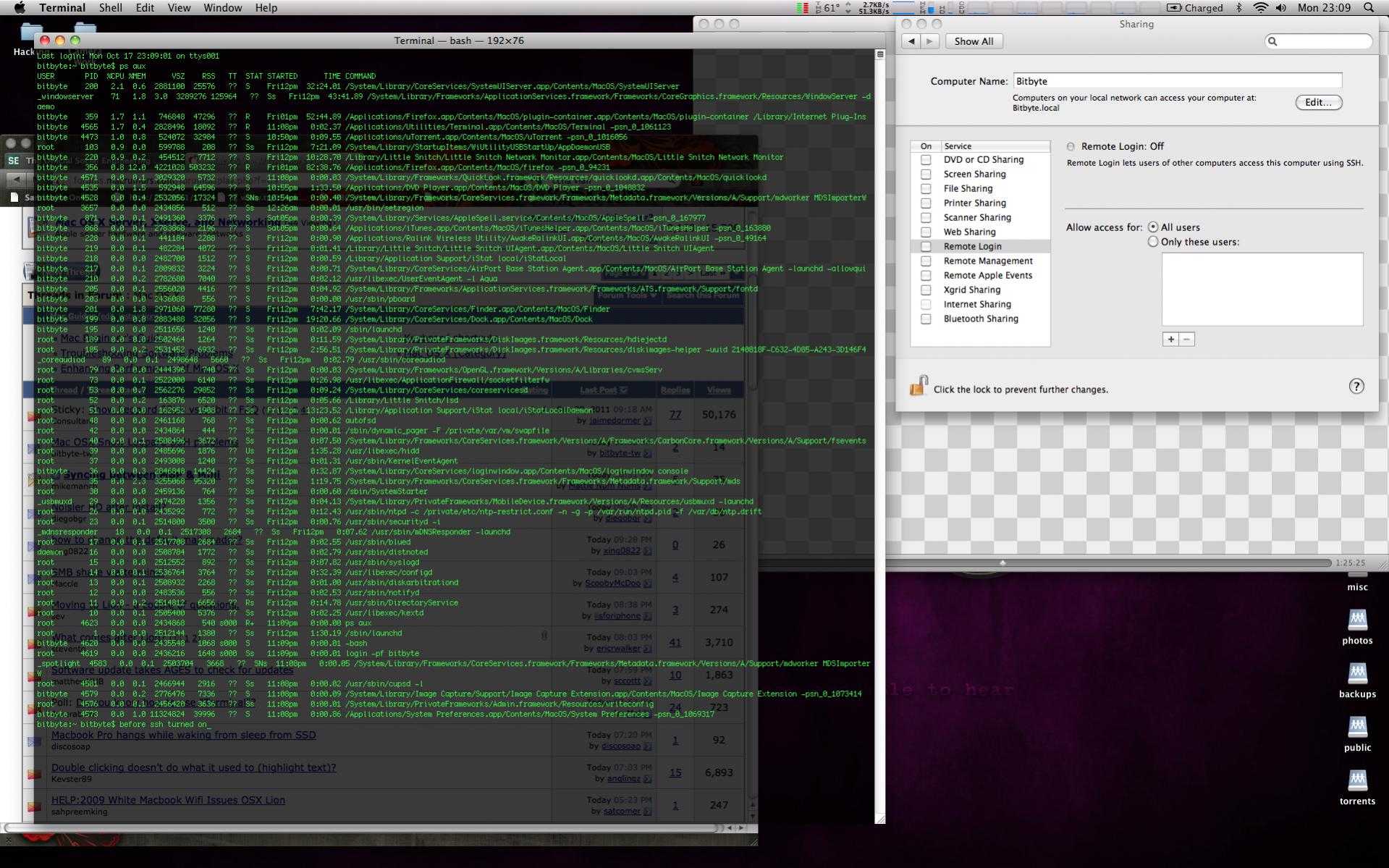

im running on 10.6.8 and im having issues with my ssh. im trying to get it so my hacked HTC can ssh into my laptop and had it working once before but now the ssh won't even load up.
ive been to sharing and turned it on. then when i go to terminal and check the running processes ( ps aux ) sshd isn't even loaded or any ssh relevant stuff.
even when i narrow down to "ps aux | grep ssh" nothing shows up other then the grep request.
it would be nice to know how to get it to work. this is a fresh install of snow leopard with just updates so nothings been touched.

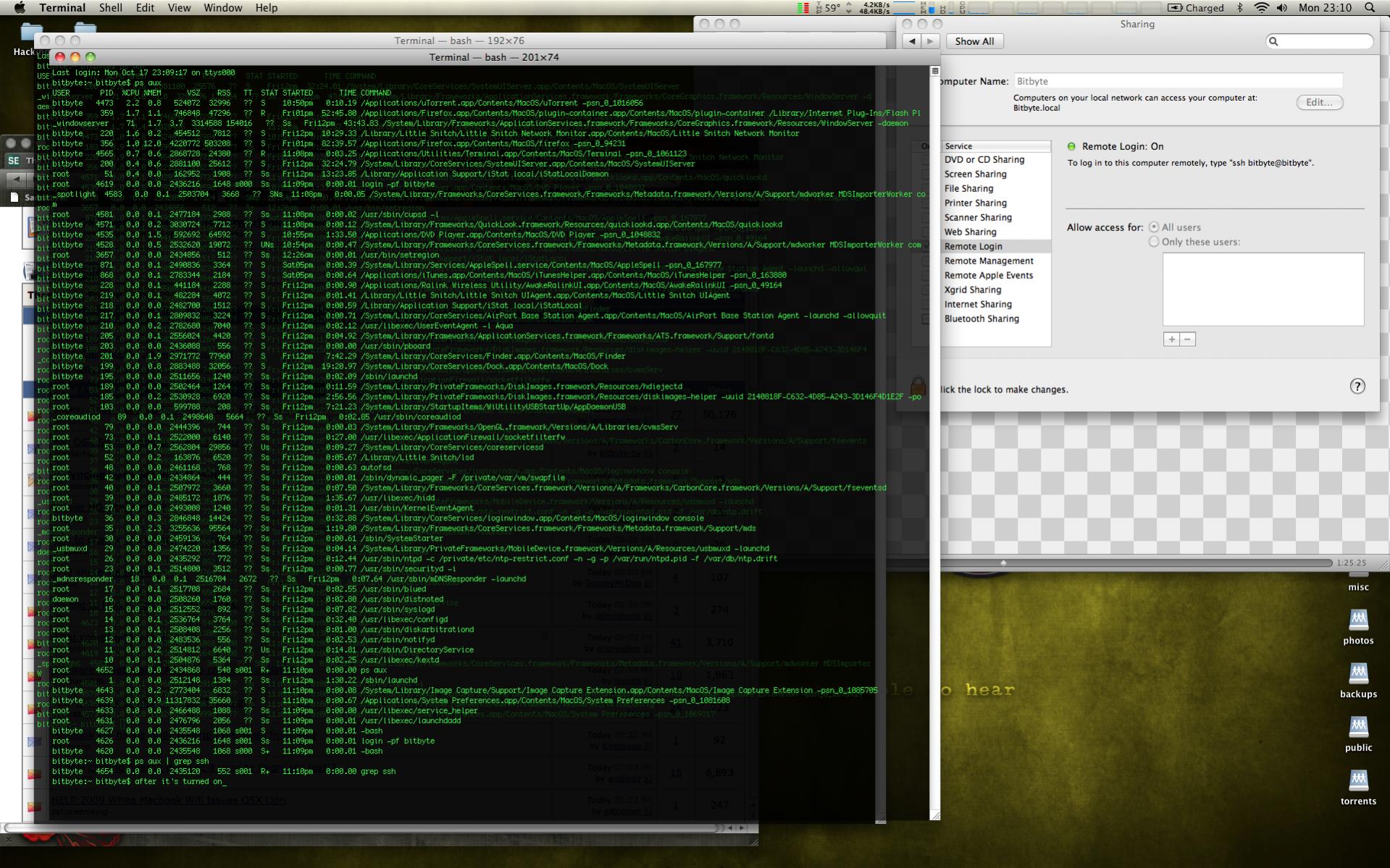

sshd
sshd is actually started by "launchproxy". This is a program that listens on all its configured ports and then launches daemons/program appropriately, but only when needed.
SSH is configured by default, but perhaps it's been changed? You can find the instructions online somewhere... A good simple test is try "ssh localhost" from terminal, by the way.
