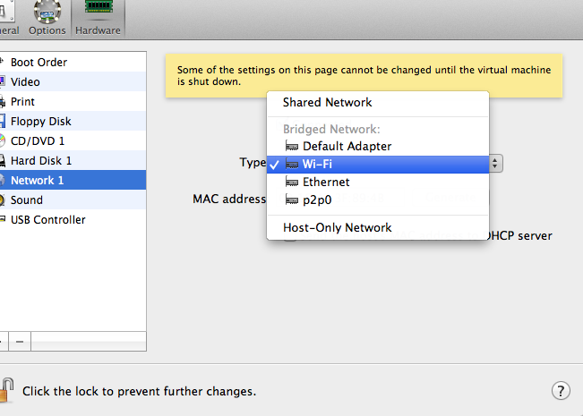

Hi dude,
If you go to Virtual Machine > Configure, you can see all of the networks that Parallels can use. If you have an Ethernet cable plugged in, Parallels can use that, whilst the Mac side uses Wi-fi. The default setting for Parallels is to share the Mac's connection, rather than connecting to a network natively.
(I'm not sure if this is what you're asking, but I hope it helps)
You can see a screenshot of what I mean below.
