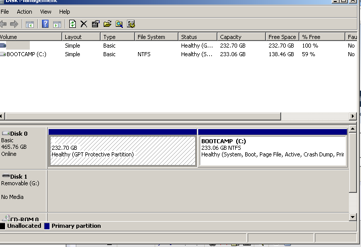

Hi guys, just a few days back I accidentally deleted my mac partition from windows's Disk Management. I proceeded to follow some instructions online to fix that situation because all i did was delete the partition, I didn't format it. So one chap on some obscure forum said he had come across the same situation and had fixed it by remapping the drive with TestDisk. I did the same, rebooted and managed to get my mac ML back. However, upon re-entering Windows 7 I discovered that my bootcamp's mac partition(where I can read the Mac's files) is missing. Further investigation shows that my partition is there, but there's no drive letter assigned.
Can anyone tell me what I can do to fix this little mess I've created?

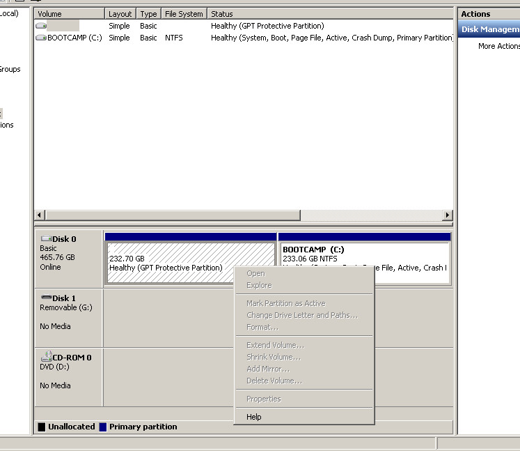

Should be in Windows: control panel, administrative tools, disk management, right click on the partion and then select "change driveletter and paths". Hopefully this works - don't know if windows will need to write to the HFS partition, if the latter then Windows may not be able to change it. Make sure to have a recent backup in case something goes wrong.
Nah, didn't work

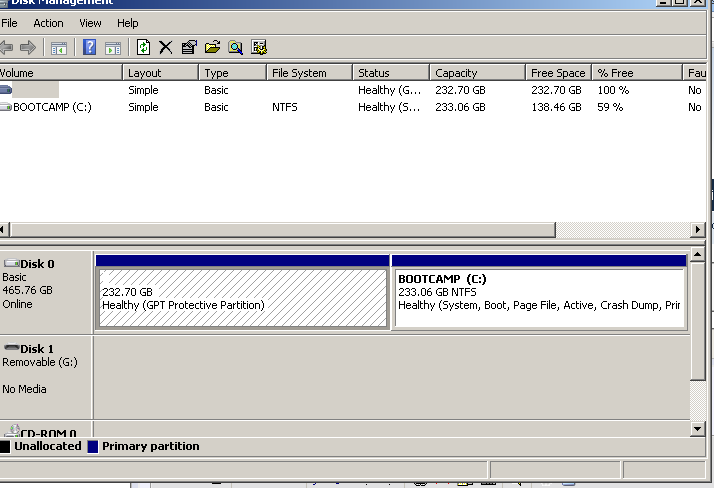

My OSX boots and works fine. From OSX I can see the Bootcamp partition as well as access it. However, from Windows I can't get bootcamp to map that drive for me. I uninstalled bootcamp and reinstalled it and can't get it to show up.
Is there anything else i should have set in TestDisk to reset the hard disk flags? If i remembered seeing my mac partition from Windows 7 correctly, it wasn't just 1 contiguous partition, i remembered seeing my recovery drive or swap, or something in Disk Management, albeit not mapped to any drive letter.
If there is not a drive letter then Windows cannot see it. I am not familiar with third party tools - you may need you to get into some configuration files to manually fiddle with that. I just wonder if Paragon disk manager can fix it - perhaps there is a trial period for it.
