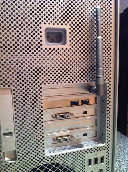

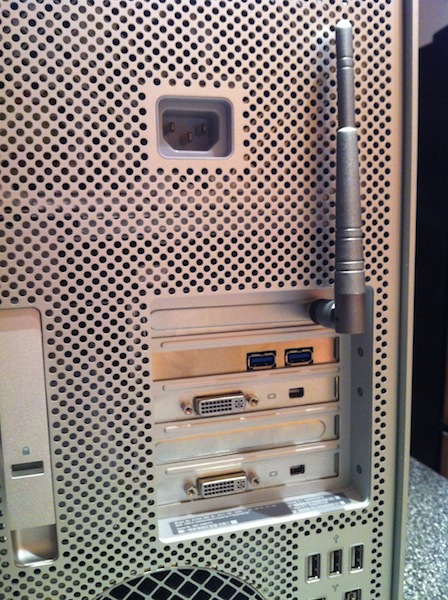

Got my parts (see post #28) and installed them tonight. Works great. I find the antenna provides the best reception when pointed straight back from the chassis (parallel to the ground). Although it also works reasonably well when pointed up as shown in the pic.
It looks clean. Thanks feins for the inspiration! 🙂

The antenna looks nice, but could break off if transporting the computer around.

From m understanding that there is no new version of Bluetooth antenna from apple and there is no new version of the Bluetooth module either. I've try replacing the Bluetooth antenna but it won't fix the issue. It's indeed the casing design issue unless there is a newer version of enclosure which I doubt there is.
For the mod I can just unscrew the antenna during shipping and reattach the antenna back after moving.
