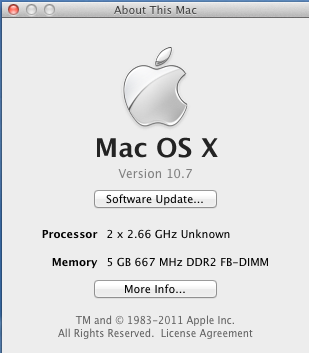

Registers as two 2.66Ghz unknowns (with 8 cores), but that's because I haven't applied the 2.1 firmware update. For some reason, it keeps bugging me to connect to the Internet even though it is. My guess is that my work blocks certain ports it needs.

Firmware flash will take care of that unknown 🙂
Yeah, I have the utility, but it doesn't want to run. Every time I try, it says that I need to connect to the internet (which it was) and then closes. I'm guessing my IT dept has some ports blocked...
