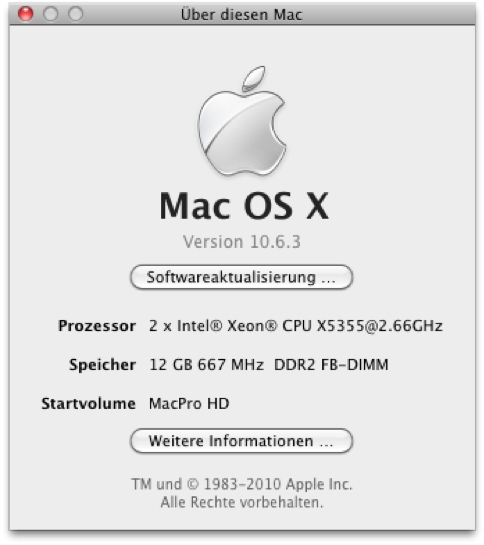

You can fix the unknown processor issue easily by installing AboutThisMac, which will list the processors kinda like this:
Thanks guyz, can anyone list a reliable link for the 'AboutThisMac' download please? I've had a look around google and am not entirely confident with the links provided...rapidshare etc.
EDIT: No worries found it and it workx ;-)
