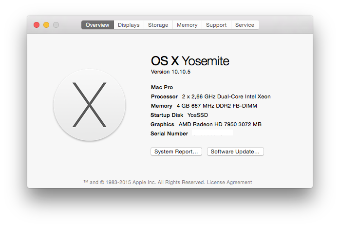

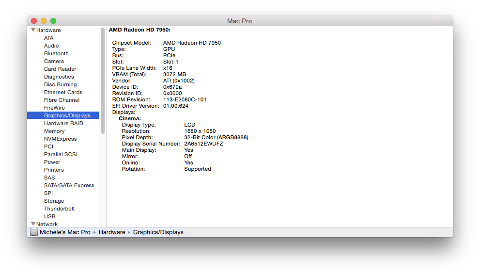

Oh yeah!!! Going to try some benchmarks and stress tests tomorrow, but I finally have a boot screen on this Mac Pro! I edited the power limit and the clock speeds on the ROM to lower the TDP down as much as I could, we'll see how it goes.
Let's hope the two 4GB sticks of RAM I purchased arrive tomorrow, so I can install El Capitan (I have the kernel panic issue with 1GB RAM sticks, unfortunately).

glad to see its working for you 🙂
the issue with el cap is not the 1GB sticks, but simply that the PikerAlpha boot.efi has an issue where simply in any machine with less then 8GB of RAM it eventually kernel panics
if you have 8x1GB sticks then it will work fine
but FB-DIMMs are pretty damn cheap, a while back I managed to pickup 8x8GB for about £30 🙂

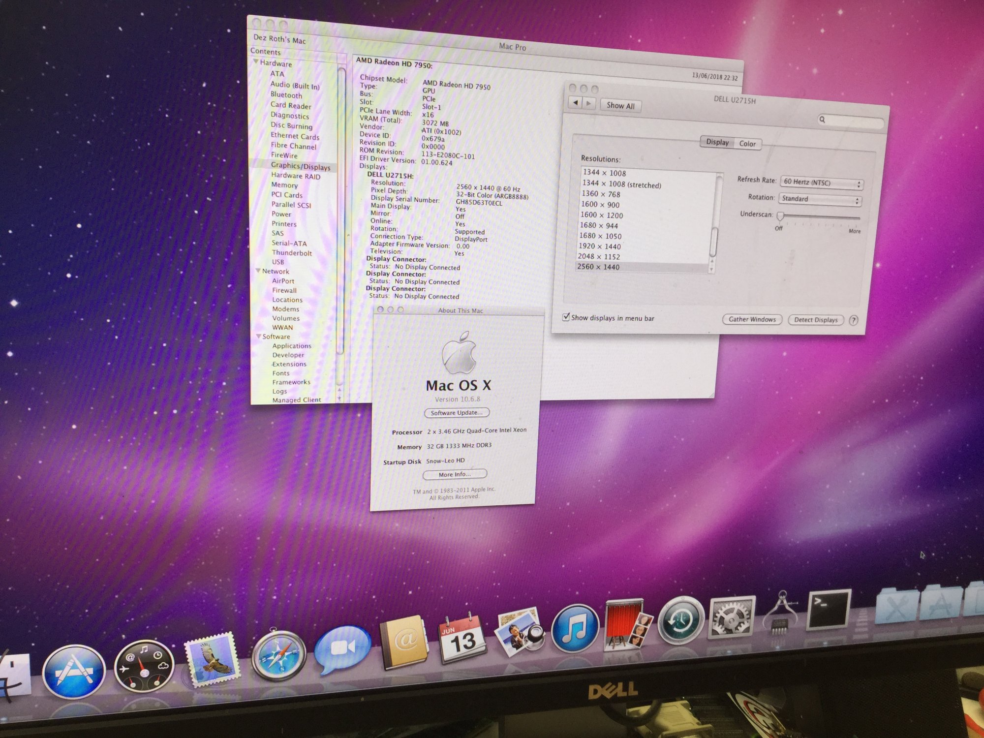

somewhere I do because I was messing with them a while back (you can force install them into Snow Leopard, and although you dont get GPU acceleration sadly it does give you full frame buffer control and monitor detection)
however frustatingly I cant find em for the life of me... im sure they will turn up when im not looking LOL
but I dont think they work with a MacPro1,1 in that, although I think they may contain 32bit binaries, they sadly dont work and cause a kernel panic, although I have not personally tried
Ah, that’s unfortunate. I’ll keep a spare GT210 to boot Lion. Thanks!
you can still boot into Lion with the HD 7950 🙂 you just wont have any graphics acceleration
I know, I did that yesterday, but I use Lion to play some old games that don't play nice with 10.8 and later, so it's handy to keep a spare GPU
