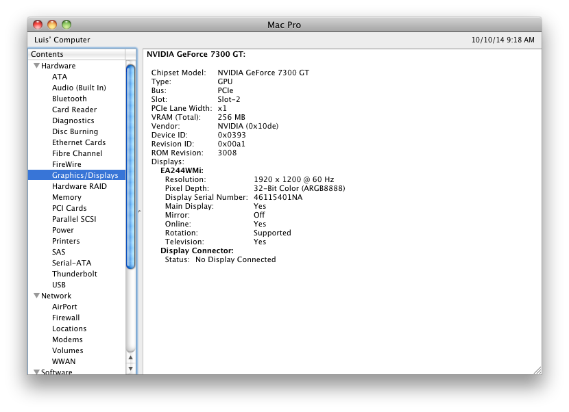

After getting a bad diagnose for my old mac pro 1,1. my cinema display and 4gb (2x2gb) of ram memory were broken and I was left with a working 1gb (2x512mb) cpu... 🙁
I bought a NEC EA244WMi 24" monitor and 8gb (2x4gb) ram memory and put everything in place

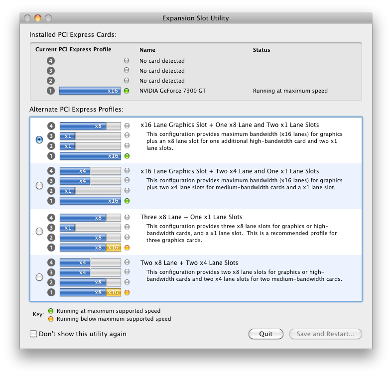

After the first boot I got 9gbs and a working monitor but also a weird message from the expansion slot utility which I am attaching here
also here is my graphics/display screenshot
This is the first time I get this message and I am not sure what it is, hope you can give me some help or advise
Thanks
Your card appears to need a x16 PCI-E (16 lanes)interface to work properly and your MP has 4 PCI-E slots for a max total of 26 lanes.
By default your first slot is x16 , second is x1, third & fourth is x4 (25 lanes with your max being 26). However, if you introduce another PCI-E card into your system, your MP will ask you how to configure your lanes- the screenshots you provided.
According to your screenshot, slot #1 is vacant- move your card there and the problem should be resolved.
Problem solved
I changed the graphics card to slot 1 and here it goes!!
Thank you very much guys!!
