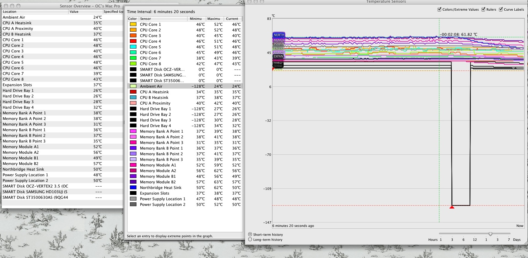

my mac pro has been running smooth as butter for 5 days since an upgrade from 2 x5150 to 2 x5365, temps were a little higher, in the ranges between 55C-70C on full stress. However, since yesterday my fan01 and fan02 kicks in at full speed from boot, and I have no control over them (via smcFanControl). Today it was slightly different, it booted up with normal speeds, but since an hour fan01 and fan02 is back at max speed again.
I checked my temp readings, they show a sudden fall in read out, going to -128C just when the fans kicked in to max speed. As you can see from the screengrab, ambient, and the drive bay 1-4 were affected by this drop.
Can anyone suggest a possible problem, and following solution to fix it? I am unsure of what I should look for here.
You could check whether the temp sensor cables from the CPU coolers are seated properly. Also - did you do a SMC reset after upgrading the CPU's?
Ah thanks no I haven't done an SMC reset. I have tried it now and monitoring the system for the next few days. If the problem persists, I will have to check the temp sensors connections. Is there an online resource where theres a clear layout of the MacPro 1,1 mainboard?
If SMC reset won't cure your problem, you'd have to check Ambient Board cable connector and HDD temp cable connector. They're very close each other (under front fan assembly, very close to upper PCIe power socket) and could be loosen/damaged. Are temp read outs -128 from boot or they're lowering to this amount?

Have you checked out the sensor connections as suggested yet? That is the most likely cause of fans revving up to full speed all the time. Roars like a jumbo jet. Have you given the fans a good clean out also?
similar thing happened to me a couple of weeks ago. Turned out a stick of RAM had gone bad... go figure
Haven't had a check on the sensors yet, still waiting for a few tools to come in. However, since the SMC reset and firmware update, I have had it go off only once, and a quick sleep and wake-up calmed it down again. Since last three days no anomalies. Still monitoring though.
I have had a good full clean this summer, a few months before the upgrade, so dust isn't an issue.
