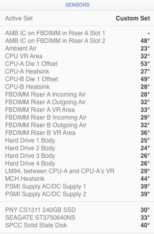

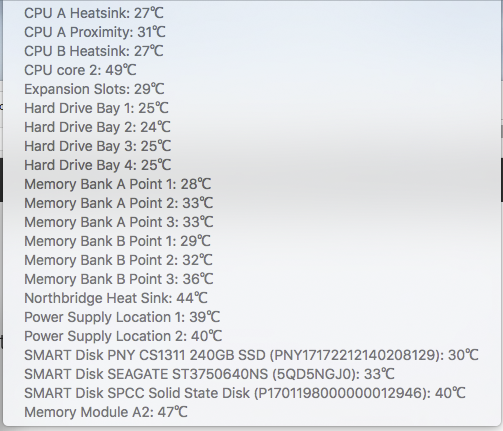

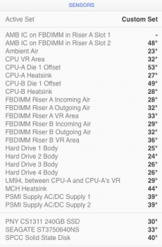

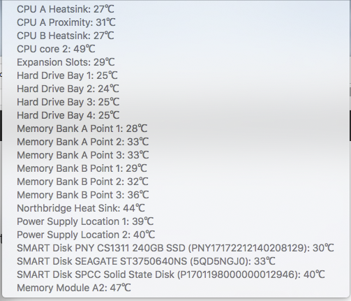

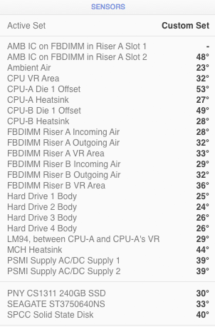

Problem is, I only get a module temp from one of the 8 sticks (Riser A slot 2 to be exact). This is true in both iStat Menus (registered) and Hardware Monitor (trial). Attached are screenshots from both.
What gives? I've seen posts where people have temps from all of their modules. These modules are identical Hynix ones so I'd think if one provides a temp all 8 should. Is there another program I should try?
