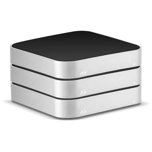

I use a Mac Mini for a HTPC and NAS. You can expand the storage easily with fanless externals so it will be super quiet and extremely power efficient.
EDIT: for storage, there's also these slick enclosures that are ideal for a Mac Mini server...
http://eshop.macsales.com/shop/ministack
This is a very elegant way to do it. If/when the ministacks can handle TB, things can get rather interesting by adding some pretty impressive additions that will compliment the ability as an htpc. (audio/video capture/play etc.)
