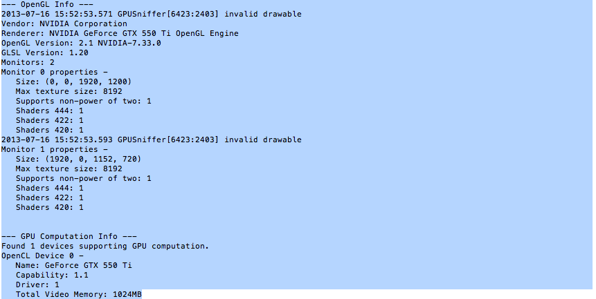

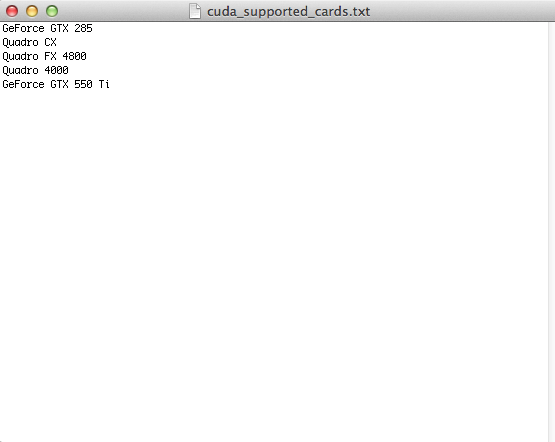

Thanks, I put in a gtx550 ti, followed the hack instructions for premiere, added the card to text file and still not recognizing it in premiere mercury playback.
Any suggestions?
attached some stills of what it looks like
running lion 10.7.5 - Mac Pro 1.1

Finally got Mountain Lion installed but its still not picking up the Geforce GTX550 ti in the gpu sniffer. plus Final Cut says there isnt a graphics card. I can't even get playback in premiere. Mountain Lion 10.8.4 with MLpostfactor. How do I check whether the machine is now in 64bit mode? and why is it not recognising the graphics card? in there but generally it feels like it very slow on the mountain lion partition. God this is a battle!
